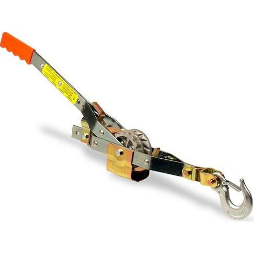

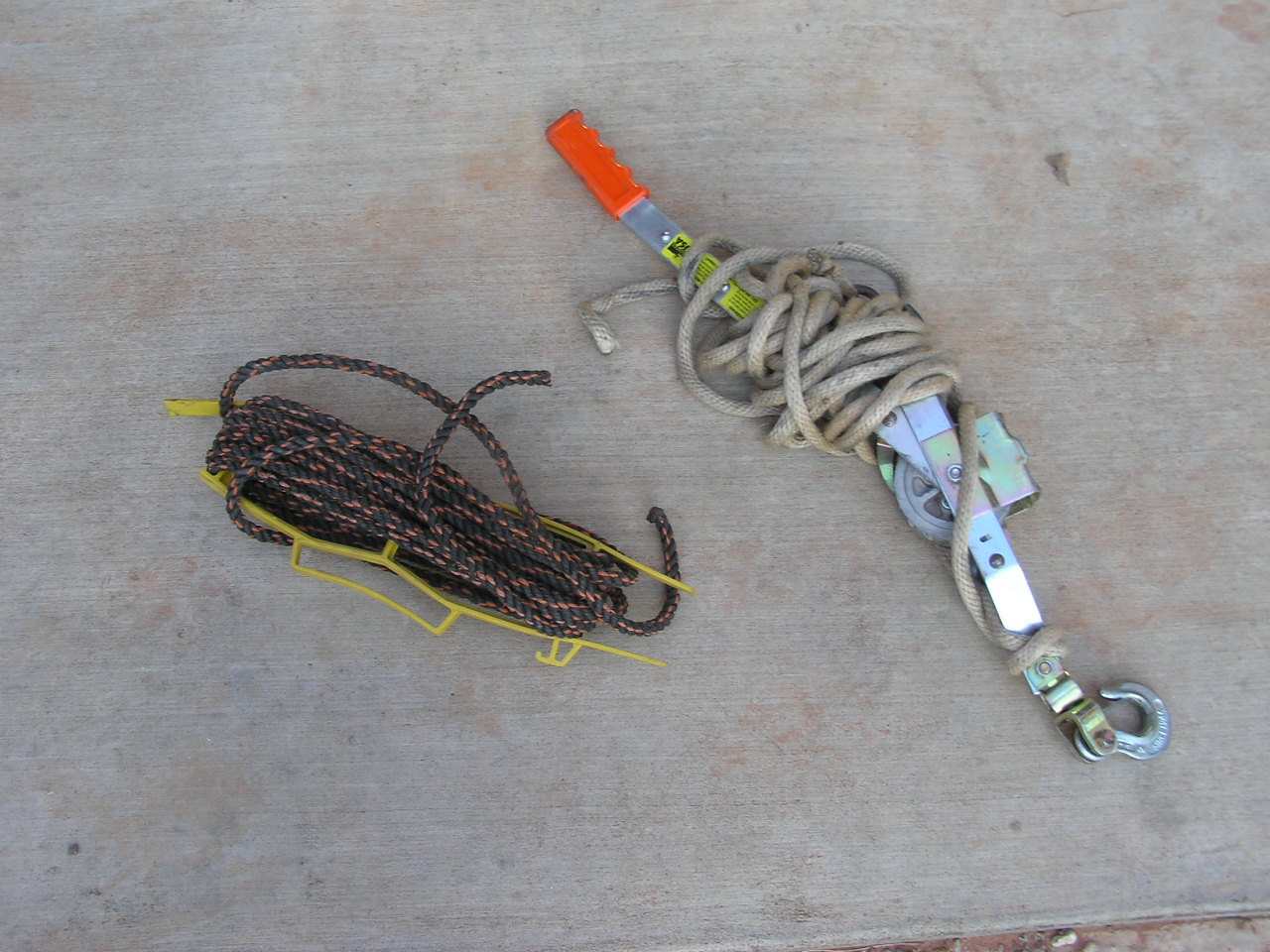

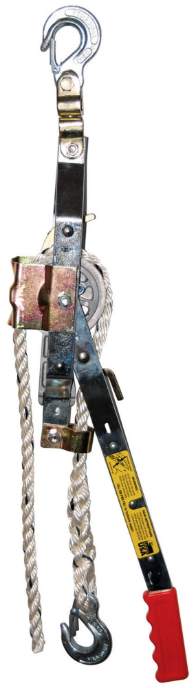

Not sure how much weight you are lifting, but a Rope Puller might do it. The rope doesn't get spooled, just passes through the grooved pulley, so rope length is unlimited.
If you need something stronger, you could modify a winch to work this way.
I carry this one in my truck. It is rated at 1500 lbs.
