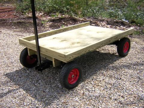

A while back there was a thread on wagons and spending a couple of thousand $$$ for one. For those of us who just have little estate needs, these are too big. Here's one I built this weekend. Load capacity is 2200 lbs. Deck size is 48x72, could be as large as 48x96. The base was $165 from Harbor Freight and the wood cost $60.
For the additional cost of a hydraulic piston, and a bit of metal, you could easily make a dump trailer, probably 1000-1500 lb. capacity for under $500.

You do real nice work Mark, especially with the building of that Jinma 224. /forums/images/graemlins/wink.gif I like your wagon but it's a bit small for my JD 4710. But, you've given me the inspiration to look into getting running gear to build a wagon for the 4710. I'm looking at something that'll accommodate about 5,000-6,000lbs load capacity. Do you have any recommendations?

When I was looking for running gear, I didn't see anything that big, and I bought the Harbor Freight stuff on a gamble that it was what I needed. The description was bad, and they had no picture.
That being said, I would look at a used twin axle landscaper's trailer and take to it with a cutting torch and a welder.

Hi, Bob!! It sounds like what you need is the running gear from an old hay wagon. You can find them around our area pretty easily. I got two last year, and I just got a slightly smaller one last week. If you want to build the wagon yourself, and just want the running gear, you can find that for under $200. Check out the Want Ad Digest for starters.

I have also been looking for used hay wagon running gears.
I have taken out several ads in the local farmers section of the newspaper.
The cheapest I have found is $800 for anything in nice shape.
Still looking for something in the $500 range.
