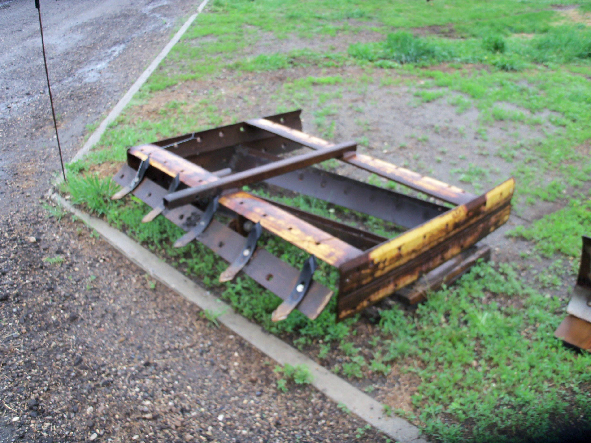

For 400' of gravel driveway I made this from salvaged road grader cutting edges. It is UGLY and heavy but it does the job when I need it to. Because both blades angle the same direction I can pull gravel sideways, it just takes a few passes. The scarifiers are almost useless, but help sometimes if the moisture is just right.
If I had it to do over again they would be more rigid. When I made it I didn't have the material to make it a 3pt but this allows it to go into my 3pt receiver hitch adapter. Adjusting the top link lets me dig, carry or smooth as needed. Adjusting the lower links so the right side is lower helps to pull the shoulders towards the center. Running in reverse will spread out any left over ridges.
I use a back blade for most of the driveway work, but after a heavy rain or fast snow melt there are some soft spots that rut easily and this will work better than the blade. I have taken the entire driveway down 12-15" and rebuilt it with just these two implements.
