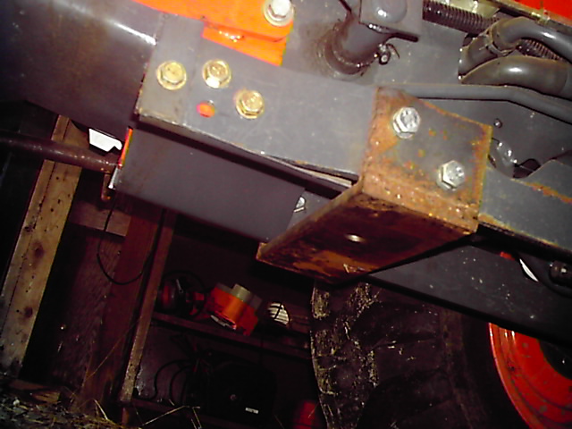

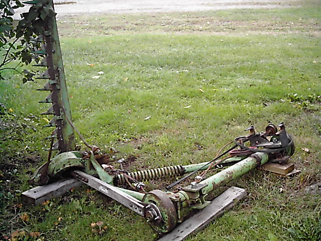

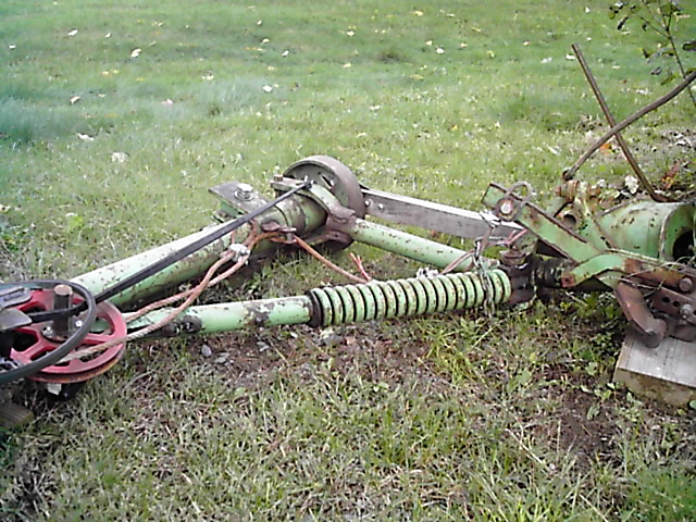

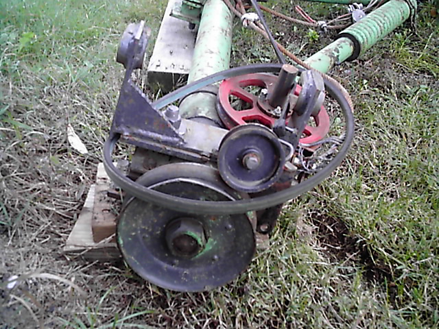

Whats the info on that side mount sickle bar on the B3200? Are you powering it off the mid-PTO? I've often thought about such a setup for my little Kubota. Any more pics of it underneath?
   / small scale haying
#32
Save yourself lots of trouble and just get a 3pt model. I found this one at a used equipment dealership. it is a 5'. It is made by the kosch manufacturing company. I originally bought it to go under my b7510 but gave up on it as there was so little to hook to under that machine. I have shortened the driving shaft and narowed the arm that holds the sickle bar to get a good fit under the b3200. It has a shaft that runs down the middle of the tractor with a flywheel on the front and a pully on the back that comes out just below the rear pto. I then use a belt from there up to another pully on the the pto. I will get some pics later today to help explain it better. I have spent too much time and money on this thing so I am married to it or else I would just go with something else. It is a uniuqe piece though.

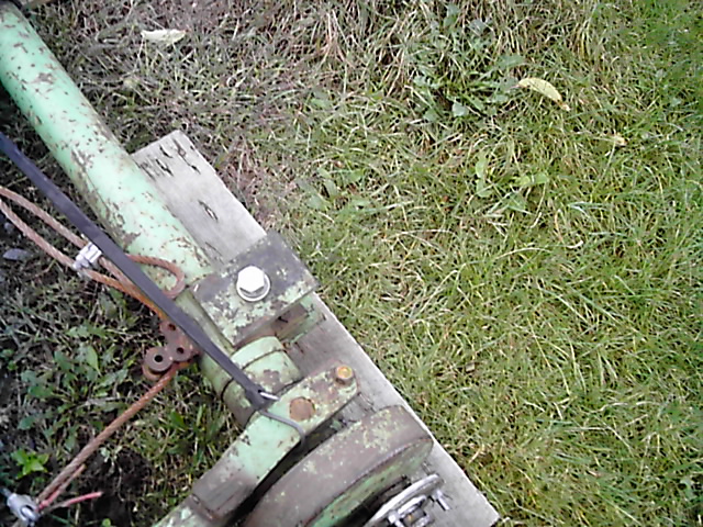

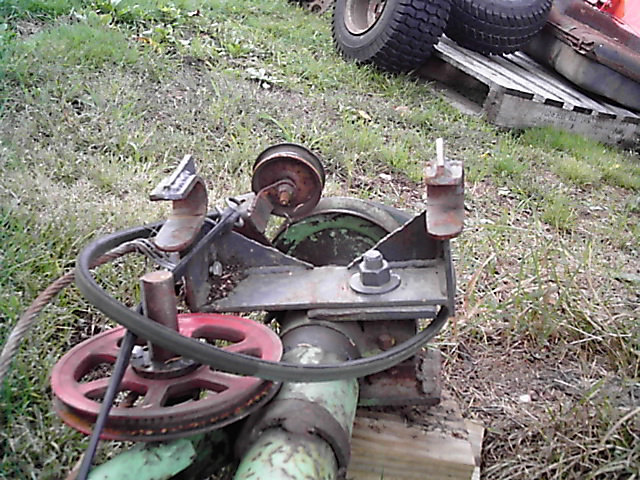

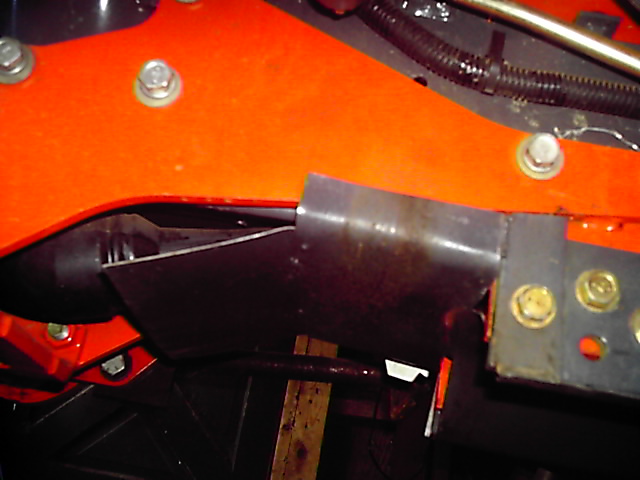

Here are some pictures of the mid mount sickle mower.
DCFC0082.JPGthe first one is a view of the mount for the back of the mower. It hooks into the lower 3pt mount pins
DCFC0083.JPG2cnd is how the front is bolted to the tractor You can see a bolt sitting in the mount hole. it goes up through that mount and into a bracket bolted to the tractor
DCFC0081.JPG3rd you can see the view of the flywheel
DCFC0084.JPG4th is a view of the pulley set up
DCFC0086.JPG5th is the front mount that is bolted to the tractor
DCFC0088.JPG6th Is the guard to keep the grass out of the tractor driveshaft and cuting seal.(see other thread about splitting a b3200 http://www.tractorbynet.com/forums/...3200-replace.html?highlight=splitting+a+b3200 ).
