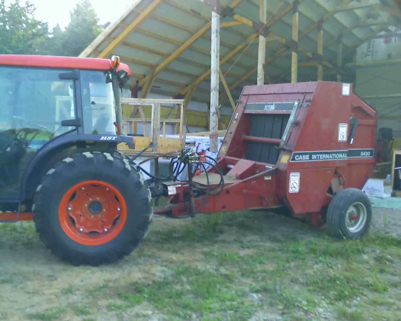

I baled with a old case 8420 for a few years. It makes a 4x4 bale. The down sides I had with this was your gonna roll a lot more rolls. So if you store your rolls outside then this means you will lose a lot more hay. Say your gonna lose 3 to 5 inches of hay on every roll by mid winter. Well if you have 100 4x4 rolls you would have 65 or 70 rolls if they was 5x4. 3 to 5 inches on 100 rolls is way more hay lose than on 65 to 70 rolls. Plus they will still take up the same amount of space. And with a 3pt hay spear you can still handle a 5x4 with a smaller tractor. Not saying that a 4x4 isn't the way to go for you. That all depends on a number of things. I'm just saying its something else to think about. Either way I hope it all works out for you.

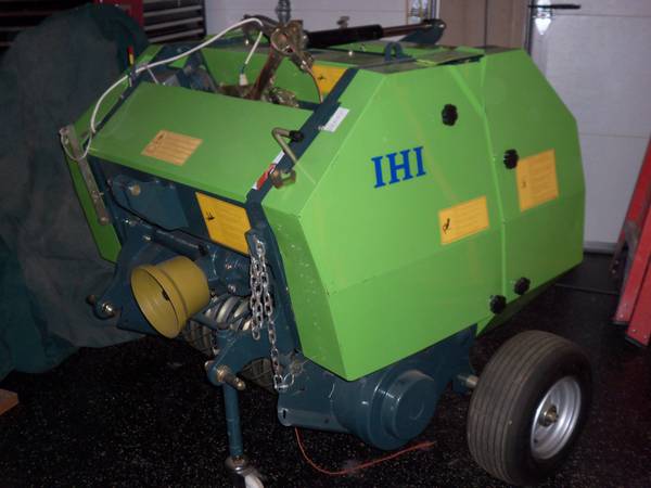

Found one on CL,
If ad is still up Baler, IHI Mini Round Baler
Baler Mini IHI 850, 2009year model, Three point hook up, Makes small round bales wrapped with twine around forty pounds, simple & easy to use, great for small hobby farm baling of alfalfa, only requires 18 hp, tractor pto to operate.
Also selling three point Befco six foot sickle only used for two seasons, Nice, 3400.00
See the Balers online in use at : Small Farm Inovations in Texas, Health reasons is why we can't bale anymore.
These are near new, baler is in shop under cover.
