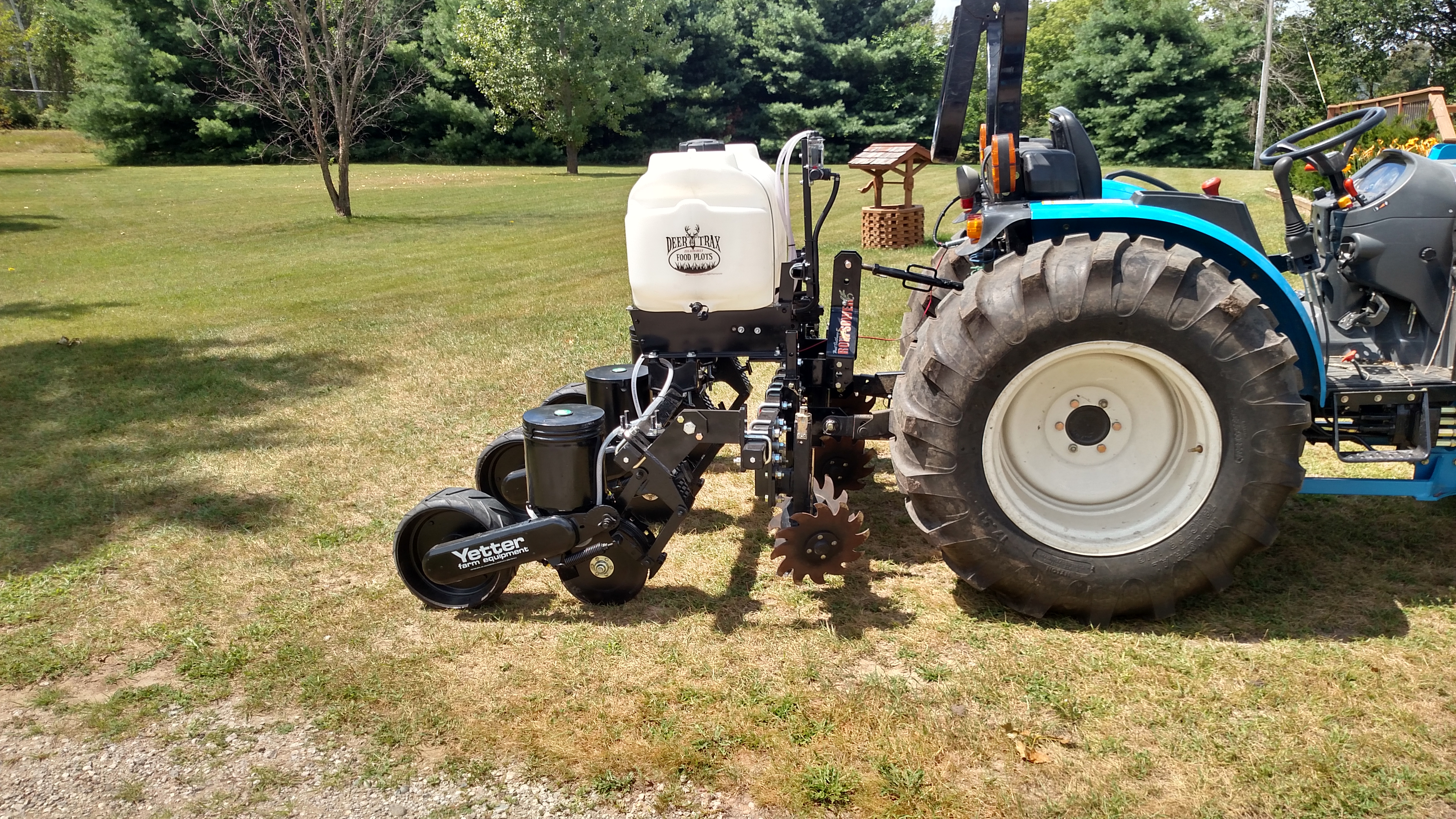

IMG_20150804_130622523_HDR.jpgplanter I had built with john deere 71s and liquid fertilizer

71 deere flex planter is still sold new today, the design is now owned by yetter. 70 & 71 where very similar planters I wonder if the website you are mentioning when it referres to fingers is not talking about 7100, etc series plate less planters.
