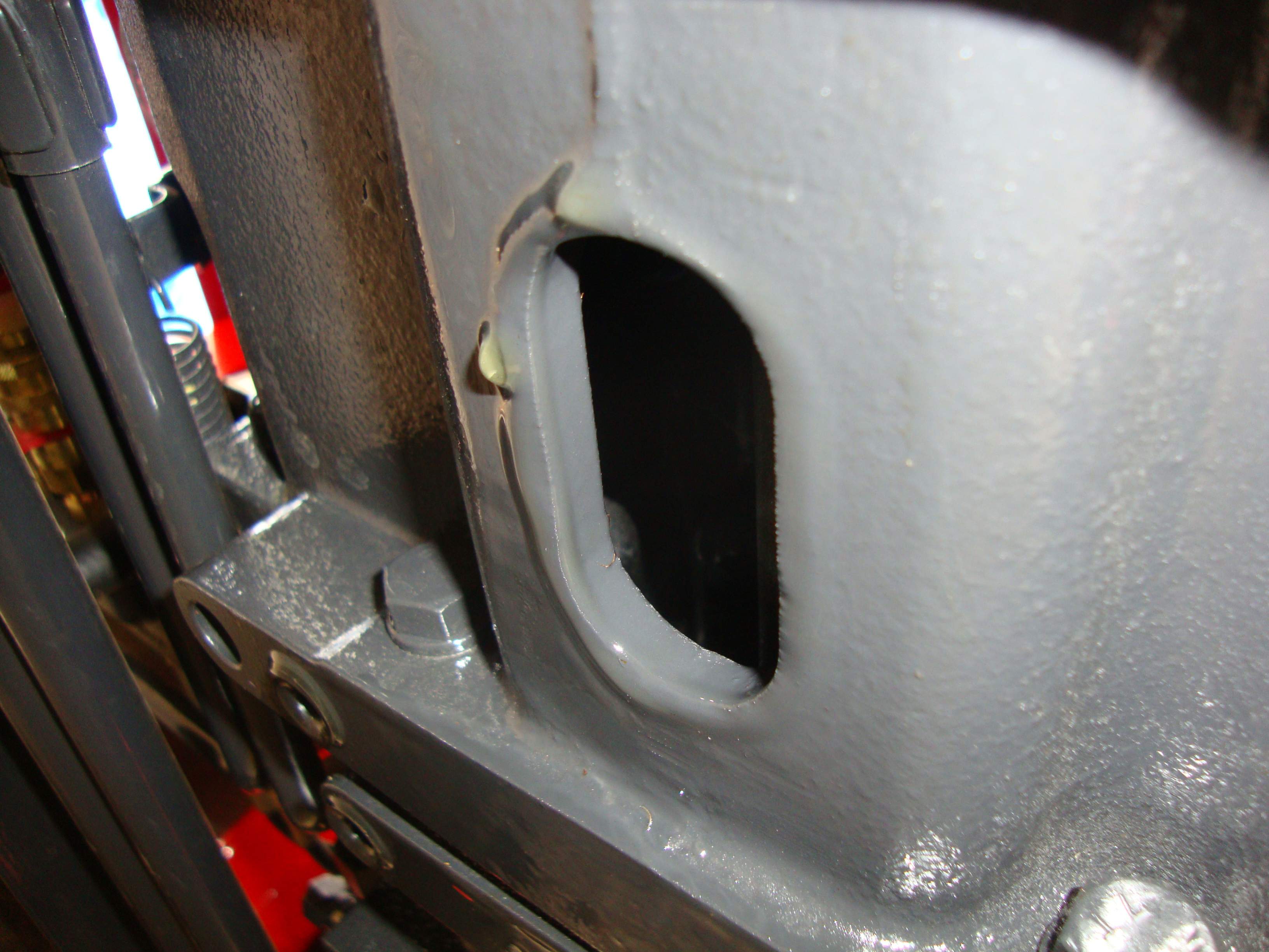

So my DK40 hst is about a month old now. I've got a few hours on it but nothing that has even begun to test its true potential. This morning I started her up and while waiting for it to warm up I got down on a knee to look the under side over. I noticed some hydro fluid drips. I figured it was dripping about every thirty seconds. The fluid is dripping out of an elongated access hole of some sort. The entire hole and the area around it has fluid on it. I have attached a photo which shows the hole looking back towards the rear of the tractor. Any ideas where the fluid is coming from.

I have roughly the same leak on my CK30hst. Mine started with about 70hrs after my dealer split the tractor to replace the hst. Mine is the gasket between the two halves of the tractor. We're waiting for a time I don't need the tractor for a while to re-split it and fix it.

The hole in question looks to be in the area where the mid PTO would be if you were to get one. I have looked all over up and down and can not see where the leak is coming from.

That hole is farther forward than the midPto. That hole allows you to see, touch, and rotate your front driveshaft. There are several seals that could be leaking and cause oil to escape into that cavity. My CK30 has been leaking for years now from one of the several (maybe a few) places where this tractor can be split. In my case, the joint that is leaking looks to have a cavity inside that contains some high pressure HST lines and 0rings that can fail. It is unfortunate but I can live with a slow slow leak if it causes no harm to the machine.

Highbeam that makes sense. I can see a shaft of some sort up inside the hole. Last night I checked the steering lines to make sure they were not leaking. All was dry there. I have no warranty concerns since this is brand new and it will be fixed. With only a few hours on it I am not willing to let it slide for now. This will be a good test for my dealer. So far they have been great. They are currently checking with HQ to plan there next move.

Update! My DK40 has been at the dealer for about a week due to a hydro leak. I spoke with them today and was advised they had to split the tractor to locate the leak. They found the o-rings and seals in the area of the hydro pump were allowing fluid to pass. They have ordered new parts from DQ and are waiting for the parts to arrive.
I was told that the seals or o-ring could have been installed wrong, or they were faulty parts. I was also told if the unit sat around for a long period of time after assembly the rings and or seals could have dried out. Anyone heard of that? :cool:

After two weeks at the dealer I got her home again. It was almost like getting my tractor for the first time again. They had to split the tractor and replace o-rings in the hydro pump. When I sent it to the shop I had a leak that was dripping about every 10 seconds or so from the front drive shaft access hole (see earlier pics).
As soon as we got it off the trailer yesterday I hooked up my Kodiak cutter for the first time and mowed by fields. I have to say this was much more enjoyable than mowing them with my little 42in riding mower :) I spent about 3 1/2 hours mowing. Checked the access hole and it is wet with fluid. It is not dripping like before but it is obviously still seeping from somewhere. I have 33hrs on the machine. I will have them take another look at it when it goes in for the 50hr service.
I know some hydro fluid leaks will occur over time in different areas. I can live with that but I only have 34hrs on my tractor and it has not been worked hard yet. I could live with a minor leak from a cupling or remote but this leak even though now it seems to be minor is bothering me.
