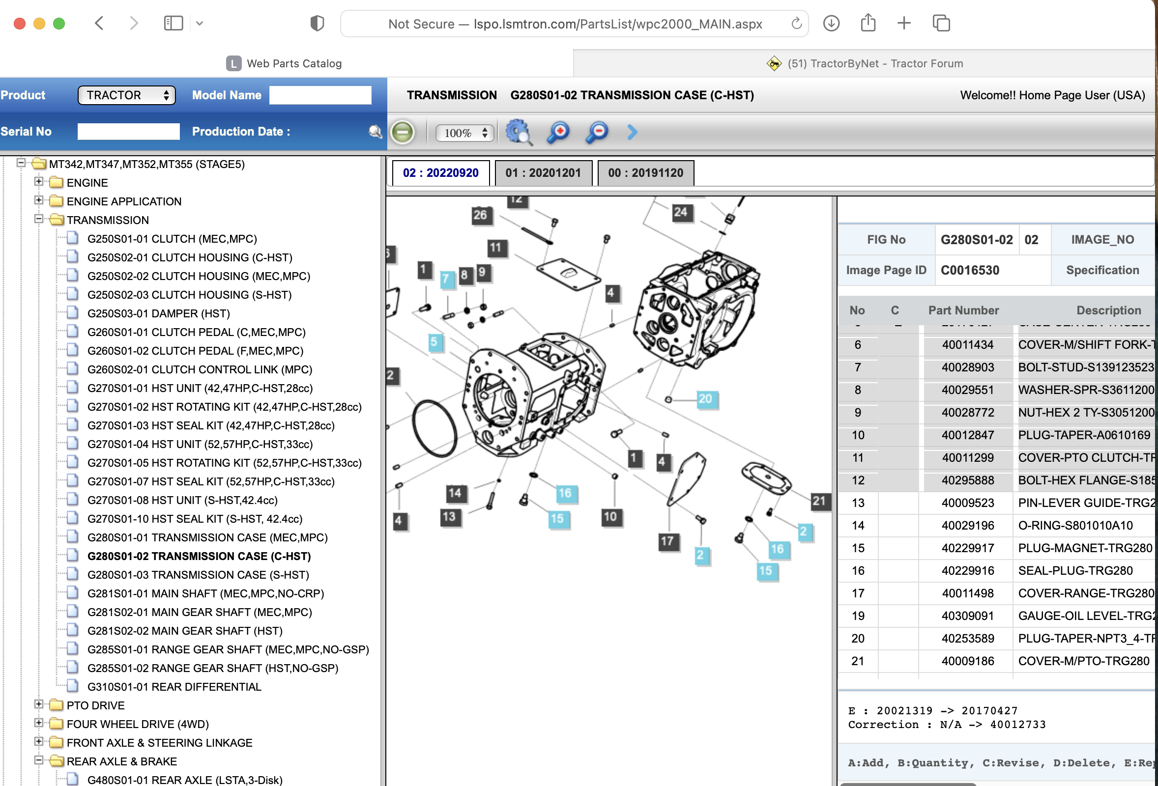

Does this look like your leaky cover (21)?
