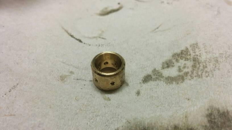

Yes, it's just a bushing

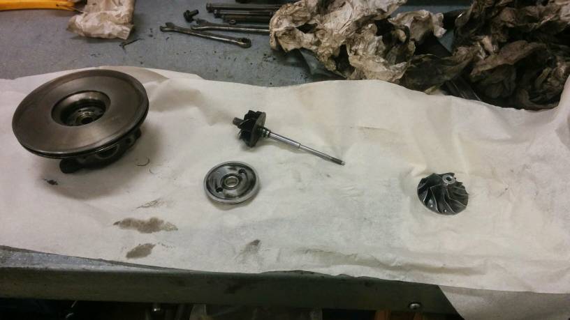

Is that the "bearing" on the left that's really a bushing?
That on the left is the cast iron center of the turbo, the top picture is the bushing that carrying the turbo axle, one on both sides. The bushings are loose fit in the hole, no tool required to get them out. The bushings I do believe takes up som oil so they have lubrication in those short moments the turbo spinns after shutdown. The turbo wheels are so light that I don't believe it spins for many seconds with out oil.
This turbo had around 210000 km and no sign of any wear, the problem with oil use the engine had was stuck rings after very poor maintenance. And it was a diesel, and it was mine since new so it was easy to find the guilty owner ;)
