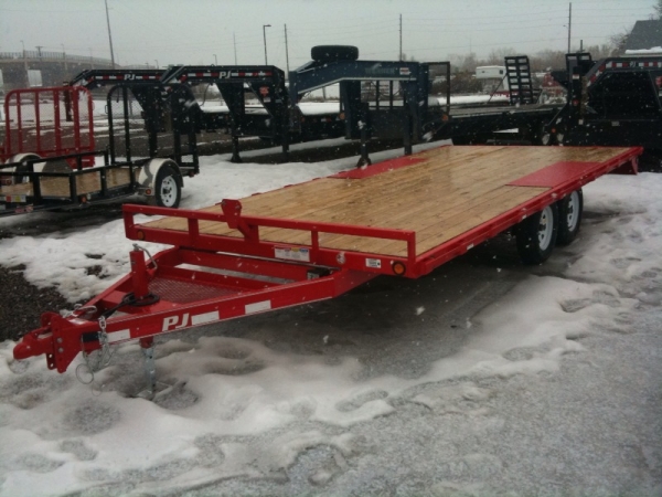

PJ makes a 5 inch channel frame deckover that I believe has 3500 lb axles.

16' minimum length and 8'+ width... looking for something smaller. thanks though.
