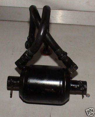

I'm looking to add a separate hydraulic lift for my mmm. Not really required, but would be a nice convenience. I need a small cylinder with a 3/4 to 1 inch bore and around 2.5 to 3 inch stroke. I can't find this as a standard item anywhere. Custom built will cost too much for a convenience. Any ideas where I could find one?
Also need it to have internal stops. Rams that have no piston retention will be much harder to incorporate.

There's a guy in Michigan here who sells disassembled JD mowers and sells the used parts. He often has lift cylinders from the JD front mowers that ought to be perfect for your use. In my case, I needed a short cylinder for my snow plow lift. I took a small diameter 20" cylinder and cut it down with a metal wheel using a table saw. I drilled out the ram end, tapped it, and put in a threaded rod end. It now has 9" travel: just what I wanted. The cylinder I chose was a tierod type (2 end caps and 4 threaded rods holding the capped ends together. I took it apart, cut down the cylinder tube, cut down the tie rods, threaded them for the shorter lenght, cut the ram rod, drilled it for the rod end and put it all together. Bingo !

I've looked into the JD mower deck lift cylinders below. I'm running 1850 psi, and I think the JD lawn tractors run significantly less. The cylinders may be rated for more, but I can't get the info to be sure.
I hadn't thought about cutting down a tie rod cylinder. I'd prefer a welded cylinder as I have very limited space, but I'll keep the tie rod idea in mind.
