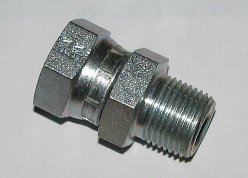

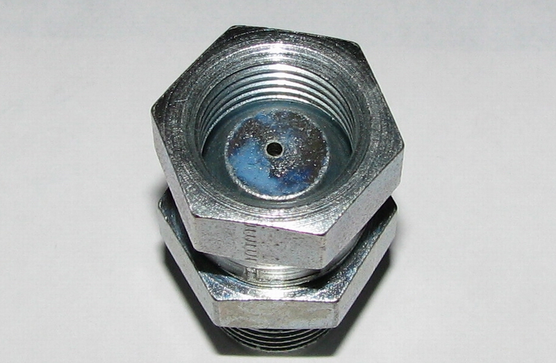

You can buy these restrictor orifices that normally give you pretty reasonable control. This one is 0.030" or about 1/3 the size you drilled. They typically cost about $4.95 each from my New Holland dealer.
