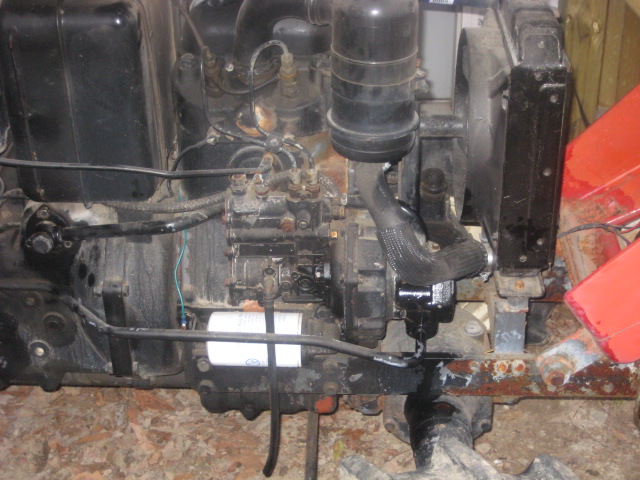

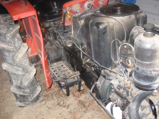

re ae a few pictures of the hydrualic system.

If there is a strainer, then it will be in the center section... you will need to look at a hyd ckt to find it.
On some of the jap models, there was a cylinder filter that slid out of a plate on the bottom of the center section near where the hard lines entered.. still on some there was a triangular plate that covered a strainer... etc.
post back with more details.. pics of the area where the hard lines enter will be helpfull.

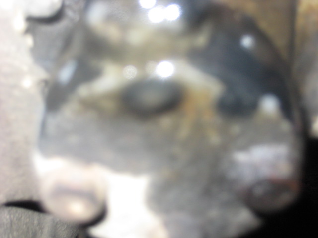

ok here are more pictures of the lines and pump there is only one filter that is behind the one line with the triangle connector on the side of the tractor

/ slow/ weak hydrualics. #16
All hydraulics have a bypass valve that regulates the line pressure. This is done as a safety mechanism so that your tractor parts don't break when lifting something too heavy. They are even in car power steering systems. The bypass valve is held in place by a spring. To increase/decrease pressure you have to install/remove shims that fit behind the sring and valve. If the spring is broken you loose almost all pressure. You would only have enough pressure to move the arms up whith nothing attached. Find out where your bypass valve is and remove it. Usually held in place near the high pressure line off the pump behind the banjo fitting or behind a bolt near the high pressure line. Some people have been known to add shims to increase their pressure to get more lifting power. However that only works if the spring isn't broken.
