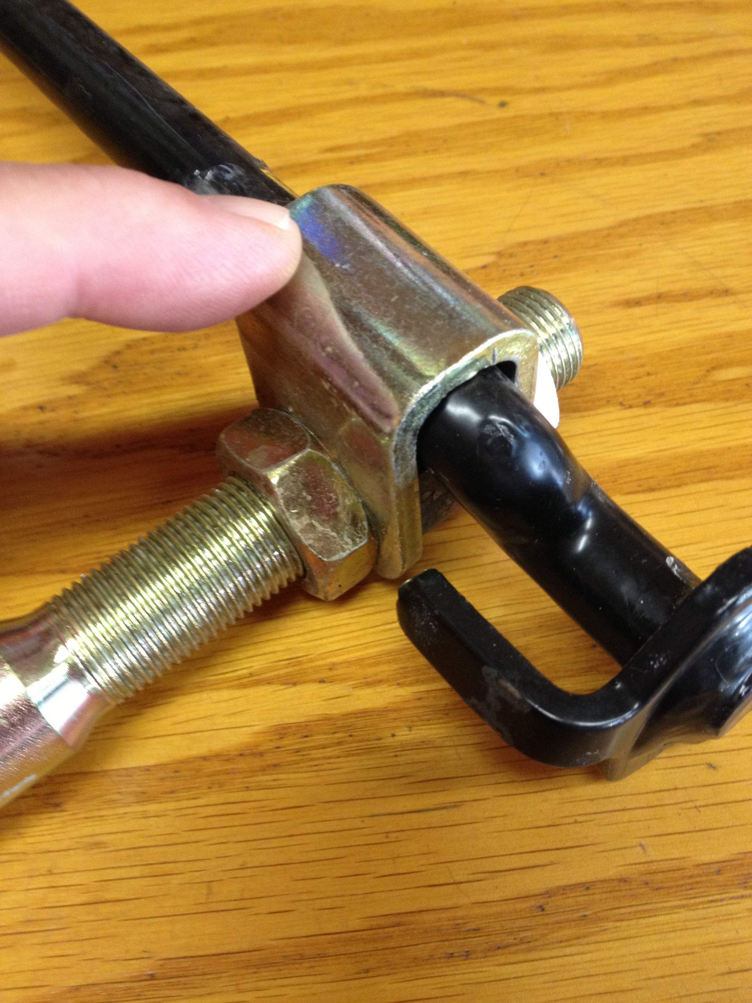

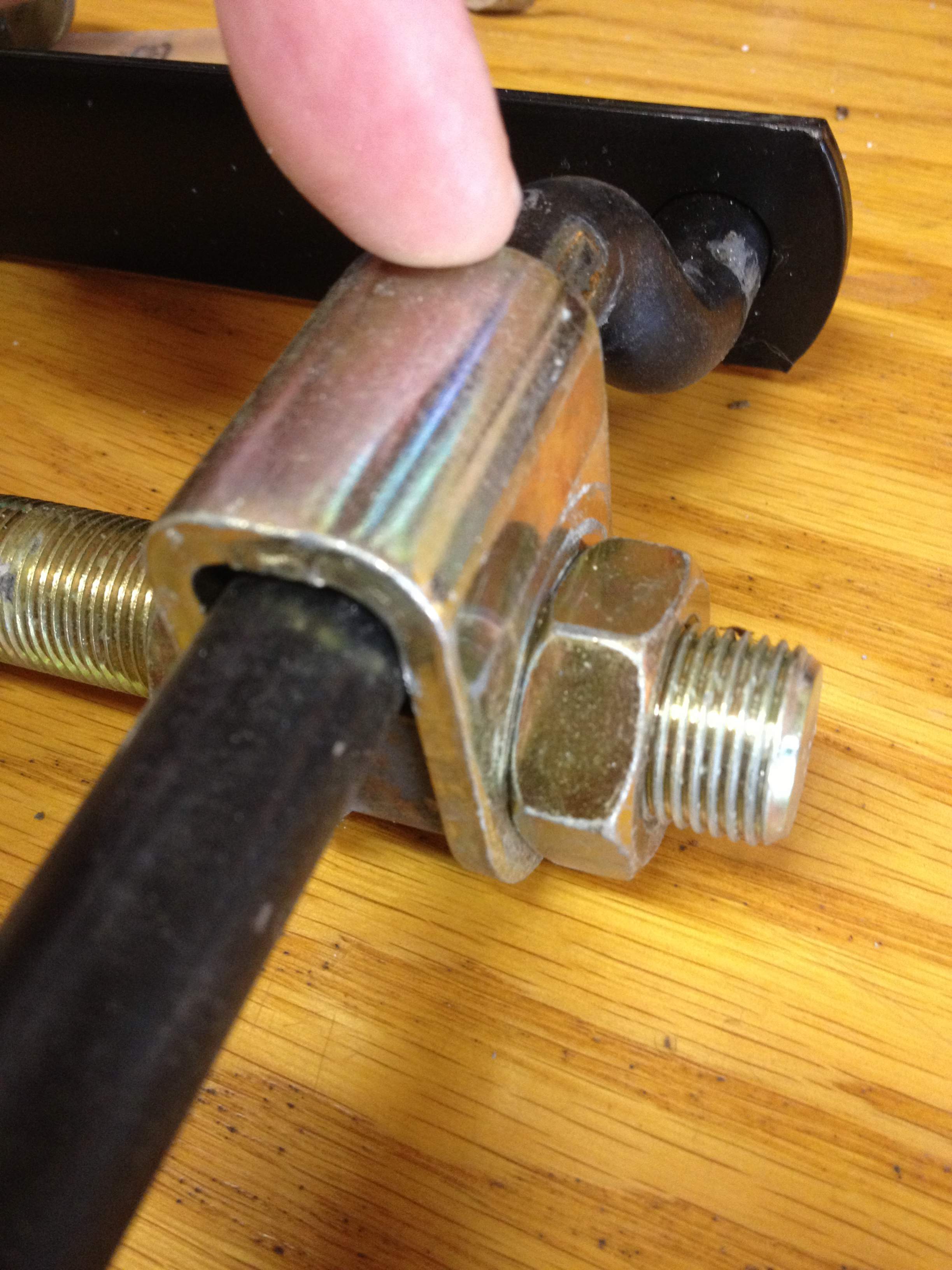

i am forming a bracket in my mind and have a question
JD provides a couple convieient holes in the rear brackets for a rod.
what is this part called?
ba

I don't have a weight bracket on the rear of my mower but would suggest you try to find a place to add on a piece of square tubing to act as a socket. Then get a second piece of tubing to drop in as a mast to support the smv sign with the strobe light on top. Plug the strobe into the 12v socket on the right fender. Make sure the sign and strobe light are mounted high enough to be seen for your safety. It would seem the easiest way to do this is to weld the socket in place and drop the mast into it when needed and plug in the strobe so easy on and off.
