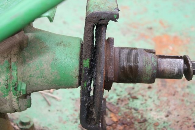

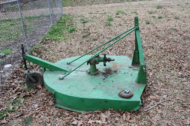

I have an old John Deere 5 ft Rotary Cutter, I think its a model 127, does a good job and its been dependable for years. It has a disc type slip clutch that i dont see anymore, no bolts holding it together. There is play between the clutch and gear box housing, but it appears that the shaft is ok. It has a large notched nut in front of the clutch( u joint end) and a bolt that runs through the u joint towards the gear box shaft. I dont know if this play is normal. If not how do I get the clutch off.

I don't know if your model is the same or not but I worked on a deere rotary mower this summer. I forget the number but the slip clutch came off by taking out the grease nipple and pulling out the ball bearings inside. There's 9 or 11 ball bearings in there. If you go to John Deere Home Page Redirect and look up a parts diagram for your model it should give you clues as to how everything is put together. Parts are expensive.

I have that model. It is an extremely tuf gearbox ... 100 or 125HP. I doubt anything is wrong based on the beating I have given mine without problem. That u joint yoke should be held to the clutch cage by 4ea 7/16" bolts. Is it the fingered cage that moves back and forth? Thats normal ~ 1/16"+/- -- a center ~1.125" hexnut revealed under the yoke limits the movement. If it isnt that, remove the center nut and the cage and look around for problems. I have never been inside on mine so I have no direct experience to help out. The big ~2.5" nut on the back of the clutch sets the force on the disk spring to adjust slip point. No movement back there is there? Is the clutch wobbling?

Thanks for the info and yes the clutch has slight wobble to it. I got the clutches off today, but can't get the last plate or hub off.

It is important that you communicate what is wobbling. Is it what I called the fingered cage -- the clutch housing [#10 in the diagram in pmsmechanic link]??? Slight wobble there, and thus the connected u joint yoke, is normal. Put grease in the grease fitting on the housing.
