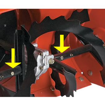

My experience is not the same. When the bolt is through two plates perpendicular to the rotational shaft (common on PTO shafts, image 1), I haven't seen one fail - although I'm sure someone else has. When the bolt is through two concentric shafts (common on snowblower augers, image 2) I've seen the shafts rust together to the point that not enough stress is transferred to the shear pin and an expensive auger gets bent badly. A dent or bend in the shaft can also cause the bolt to not fail. You have to take them apart and check them every now and them, just like a slip clutch.
Sure they always break at the same torque regardless of the tractor - but sometimes they're protecting the equipment (which has a specific failure point) as much as they're protecting the tractor.
