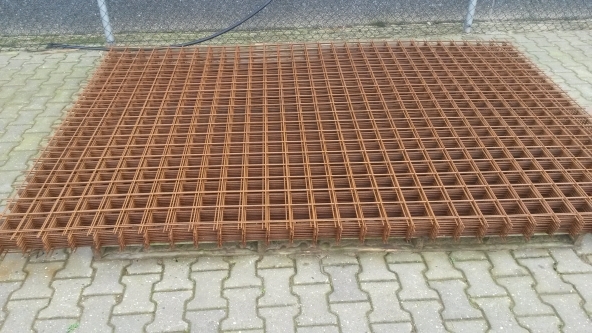

Here in Holland, individual rebar is only used in highly loaded high rise constructions. For floors or slabs the default rebar is nets, 5, 6 or 8mm rebar press welded into 4x4" or 6x6" mesh nets. Are these nets used in North America too ?
That's what I used on my shed floor, but in my shop addition, they used 1/2" rebar at 24" O.C. each way. Personally, I don't really trust that the mesh won't rust away over time, but in my shed small slabs, etc., I just don't worry about it. I know that, theoretically, the concrete prevents air from getting to the rebar/mesh and therefore should help prevent rust, but it doesn't always do that.
They are. It's called "re-mesh" here and it's commonly used for floors and slabs of 3-6"/75-150 mm.
Rebar needs at least 2 inches of cover, which is why we put it on halfs of 2 inch concrete pavers. And the concrete needs to be vibrated for proper deaeration.
