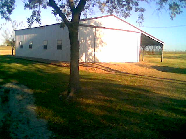

Large commercial buildings built around here, cheapest kind of construction, use a steel frame attached to a "pole" buried in concrete. The building is built and when finished the floor is poured (floating) and is flush with the top of the hole filled with concrete that the pole rests in. I think this part is a moot point....
Personal opinion: My shop was built and later a concrete crew came in and poured the floor 5" thick which came up almost to the top of the treated 2x6 that formed the bottom framing around the perimeter of the barn and the board to which the metal siding (lower end) was attached. The bottom board was a ready made form and remained in place after the pouring which covered the top of the concreted pole hole. I did drive 60d nails into the poles to anchor it all together somewhat.
Has been 7+ years now and even with last year's drought there has been a minimum of building shifting in this heavy clay soil and my doors (2 ea 12x5, 2 ea 10x5, and a 3' passage door) are still in place and work correctly.
Here is a pic of it after I had it built: 30x50 with 15' shed.
