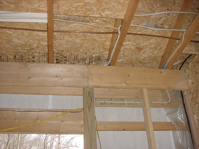

For what you called "eave girts" (I call headers), using 16 penny nails, nail directly to the side of the posts. On a 2x12, about 8 nails should do it. The shear strength on a nail is awfully high.

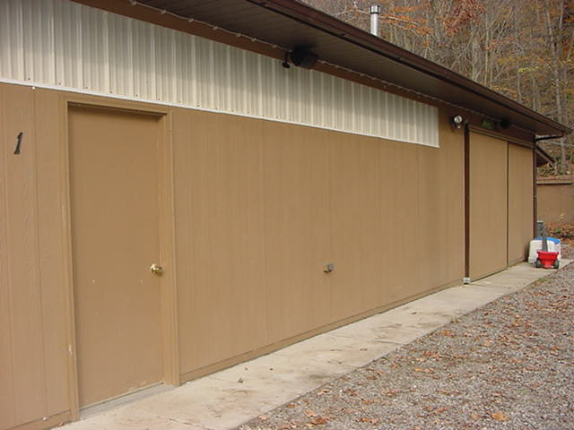

OK, after writing all that, I thought I'd take a couple pictures of one of mine to give you an idea. Here's the first pic just to give you an idea of the building.

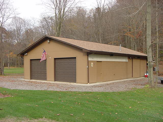

This picture is a little closer.
Around the perimeter, the concrete extends past the roof and gutters and is sloped away from the building. Underground is 4" drain tile just off the end of the concrete to catch whatever the gutters don't.

Here's a view of the top of the post with the 2x12's
