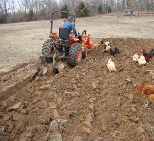

As you can see here, the 7800 can get the job done.

I don't think my 7800 would pull a 20", that is one big plow. The ones in the picture are two 12". When comes to measuring a plow not everymany people know how. I went around here and asked about 20 guys and you know what, no one had it right. Also the people I asked had something to do with farming. They just don't use them anymore and haven't for awhile. Your 20" doesn't sound right.

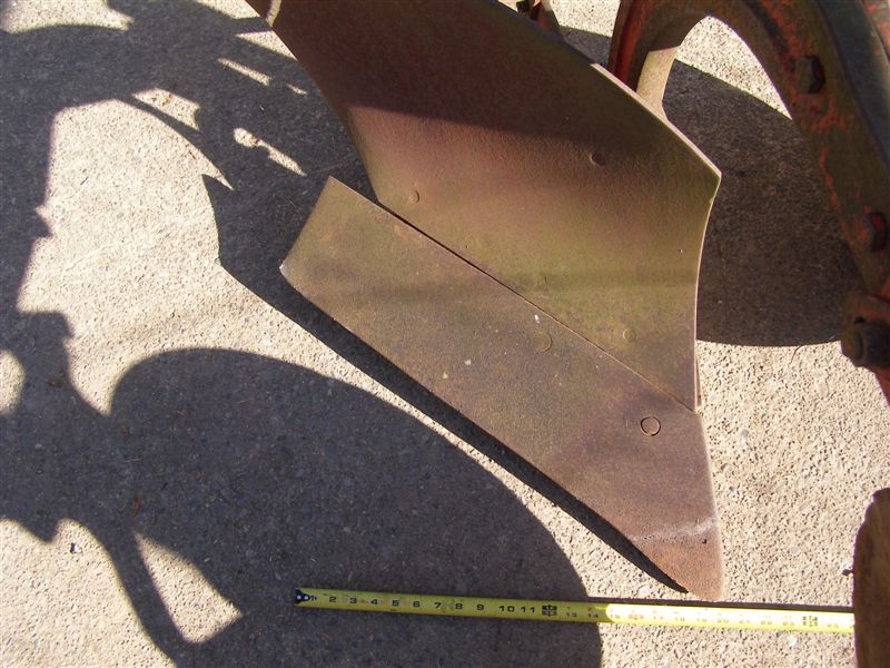

OK, here are some photos of my plow. If they stay in the same order, photo #1 is the WRONG way to measure--that's about 27 inches.

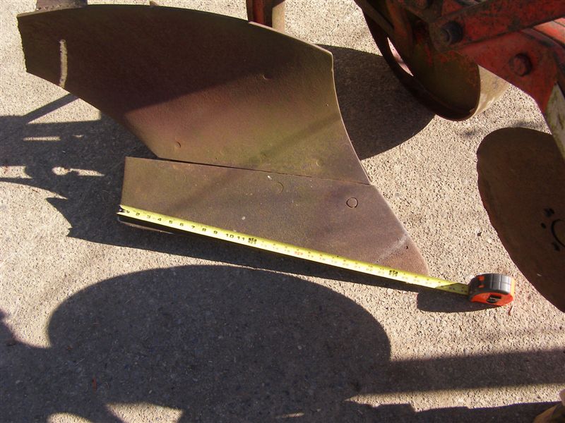

Photo #2 measures the width of the plowshare, parallel to the cutting edge, and it's showing about 20 inches.

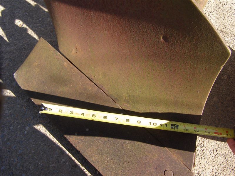

Photo #3 measures the width of the moldboard, which is about 14".
Like I say, don't know much about plows, but that share looks huge, and not sure it's supposed to be extending beyond the moldboard like that, but that's how it came.

Forget Pictures 1 and 3. #2 is right, but put you tape under the plow hook the point on the left. Then check what it is on the right at the stright edge that has the tail on it. When you drop the plow in the ground it well cut a 20" ditch if it's 20". By #2 picture the way your holding the tape it looks like it might only be a 16"
