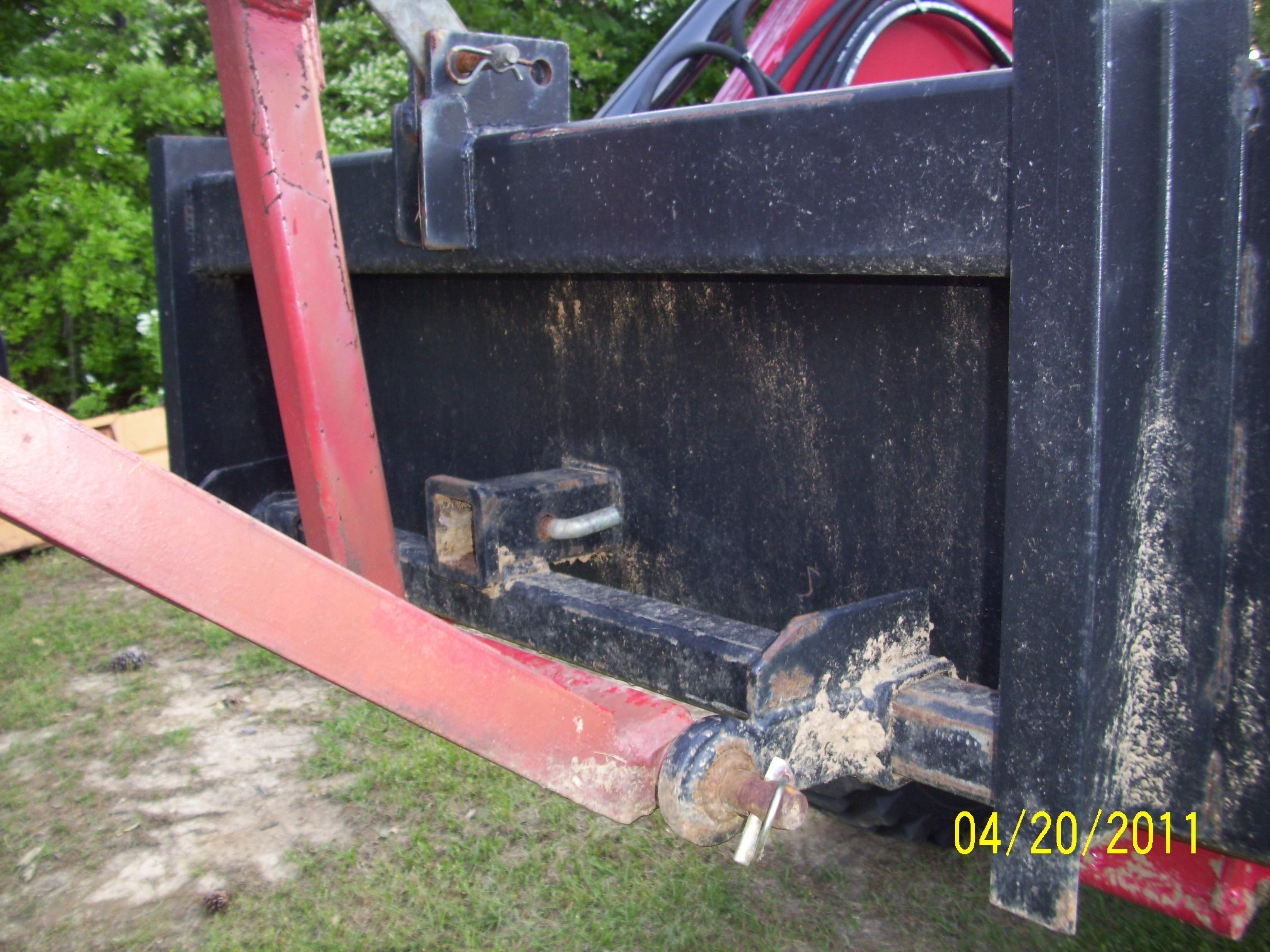

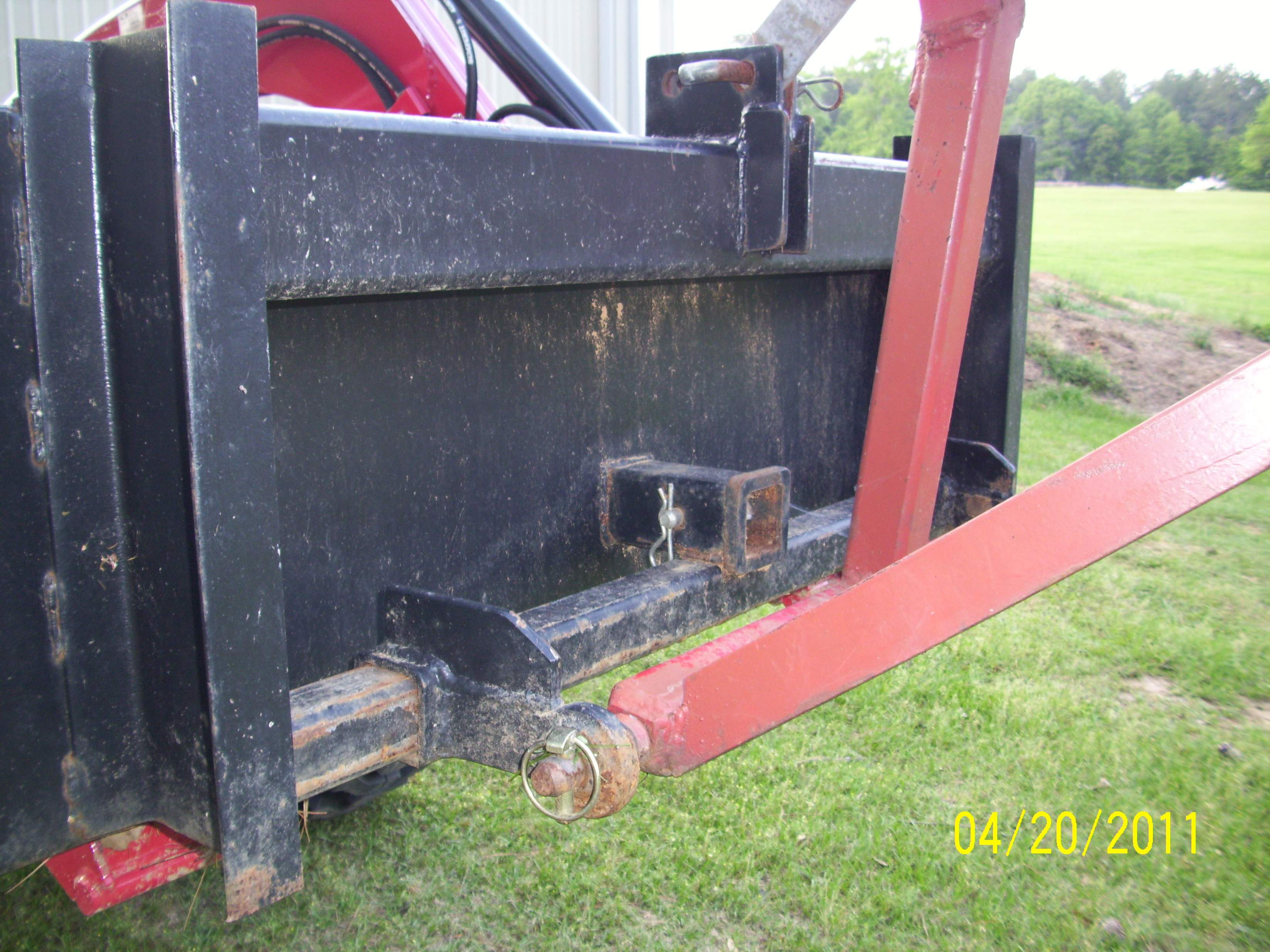

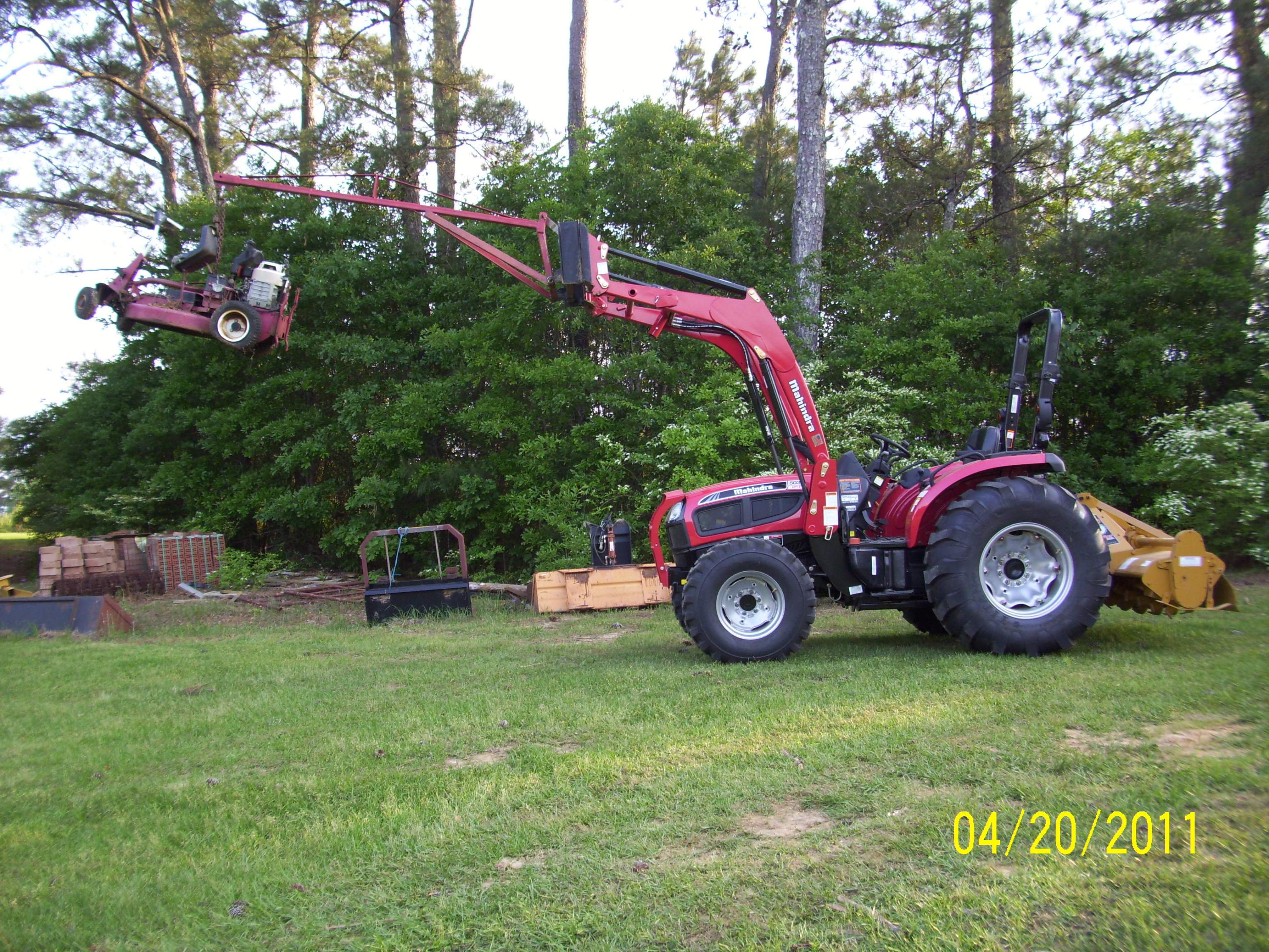

Just thought I'd share a project I built several years ago.
This adapter allows use of just about any non-pto driven attachment on the front of tractor. It's original purpose was to enable me to use 3 pt implements on the skidsteer. Now that I have the new Mahindra with SS quick connect, I am able to share many SS attachments that I had, like the 8' boom pole in the picts. Please excuse the rust/mud. I have since cleaned and repainted it.

I would like to build the same thing. How do you keep the lower 3pt attachment on the square tube from sliding back and forth? Do you have a nut with a bolt some place to tighten down to keep the square tube tight against the tube frame?
   / Skidsteer to 3 pt adapter
On mine, it does slide, but only moves a couple of inches. With most implements, it is hooked "hard" or firm, on the top link, so that keeps it pretty much centered.
