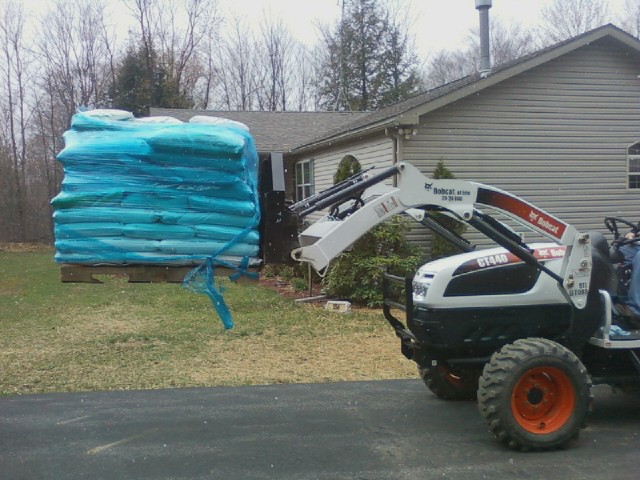

What kind of lift do the S Series Skidsteers have? I am looking at S185, S205 or maybe S250. My Bobcat Tractor will lift 3000lbs just need to know if the skidsteer will do better. Any real world info would be great.

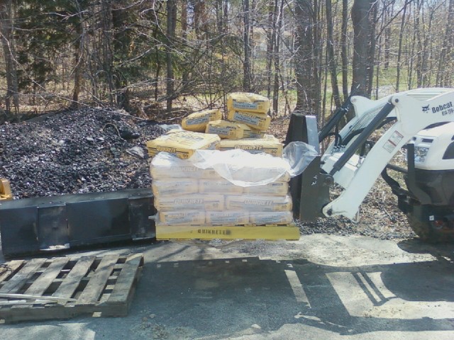

My tractor will lift 3000lbs out of my truck bed, which is close to 46" not full height, I use my forks to lift skids of salt and different items off my trailer which is 24" off the ground. So I was hoping my skid steer purchase would give more capable lift, not always at full height, mostly just off my trailer.
So in the real world what would I expect a 185 or 250 do using forks picking up skids?

Well whether you believe it or not it does it all day long, I have no reason to lie. This is my second bobcat tractor that does it no problem, thats lift not curl or do much more than pick it up and move it from point a to b. Thats why I am looking into which SS that will do atleast what my tractor does in lift capacity, knowing SS handle loads much better.
BTW the load that I tested lift cap was bags of quickrete 2880 plus skid and forks...
I pick just picked 10 skids of bag salt off trailers that weighed almost 2600lbs with ease and could do whatever I wanted with them...

Do you always have an implement on the back? If you have a hyd gage in the system, what pressure does it read at max load.
Here is a test for you, if you can pick up seven 55 gal barrels of water, that would be 3080 lbs, or seventy eight bags of 80 lbs of cement would weigh about 3040 lbs. .
