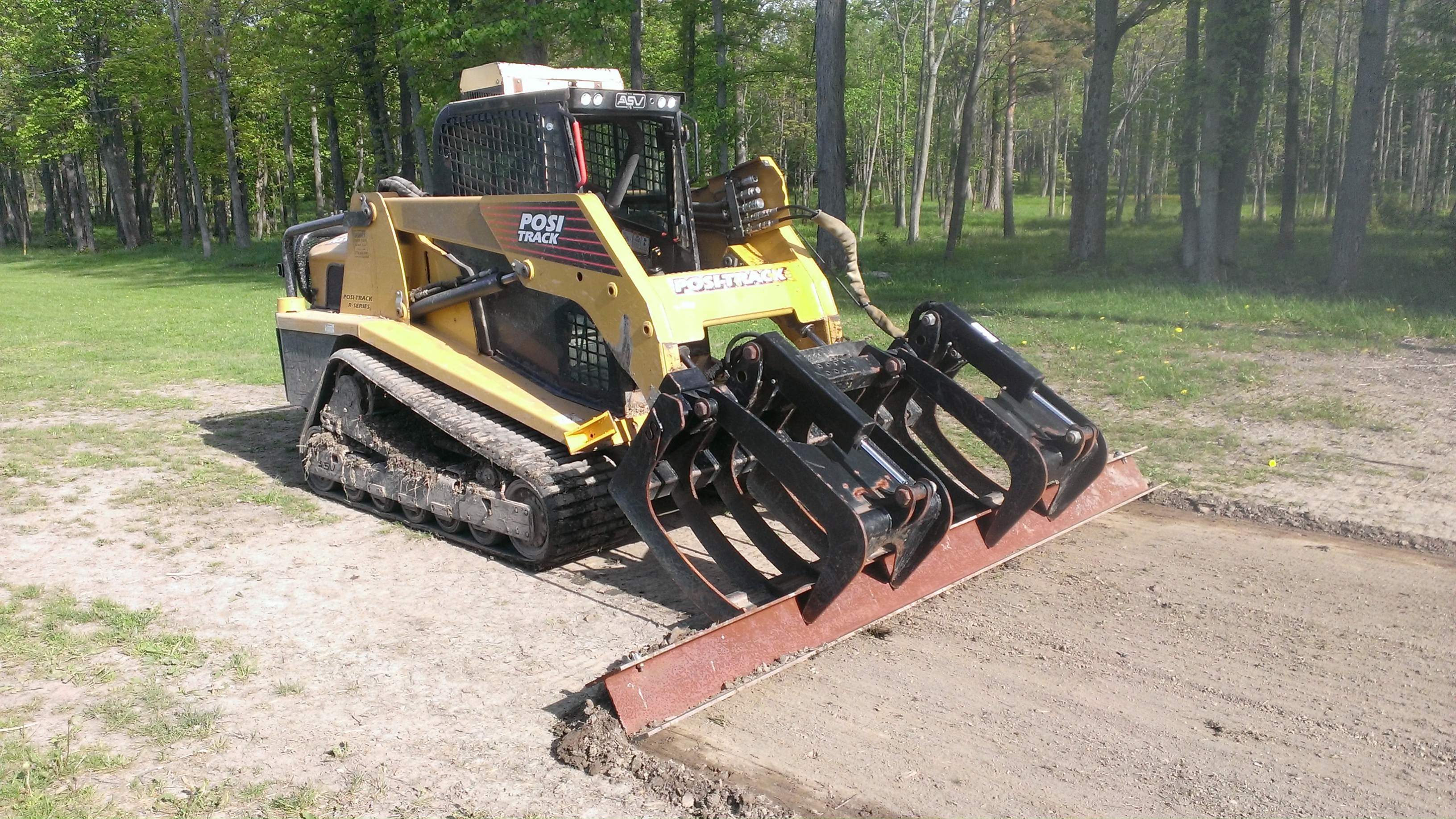

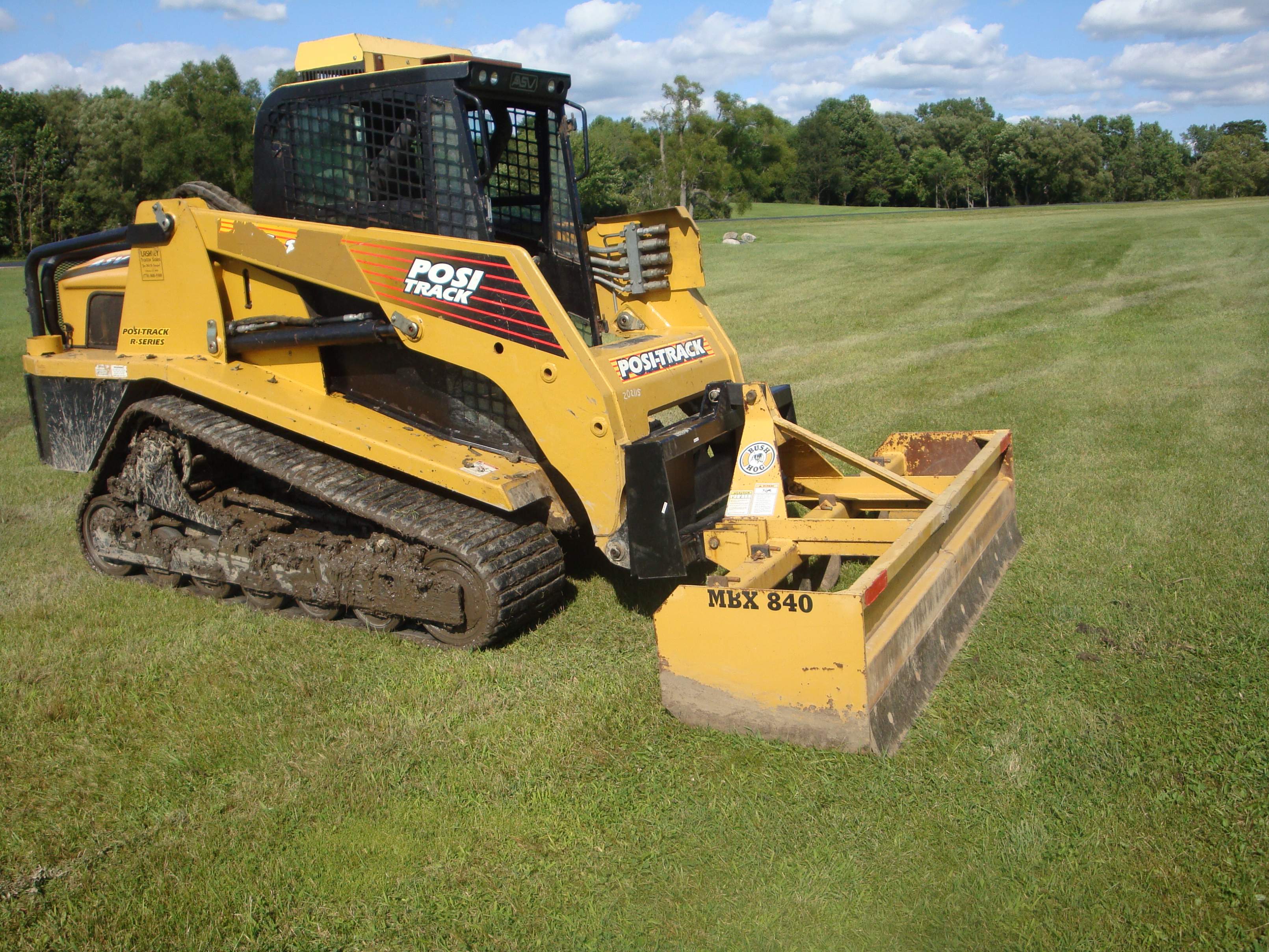

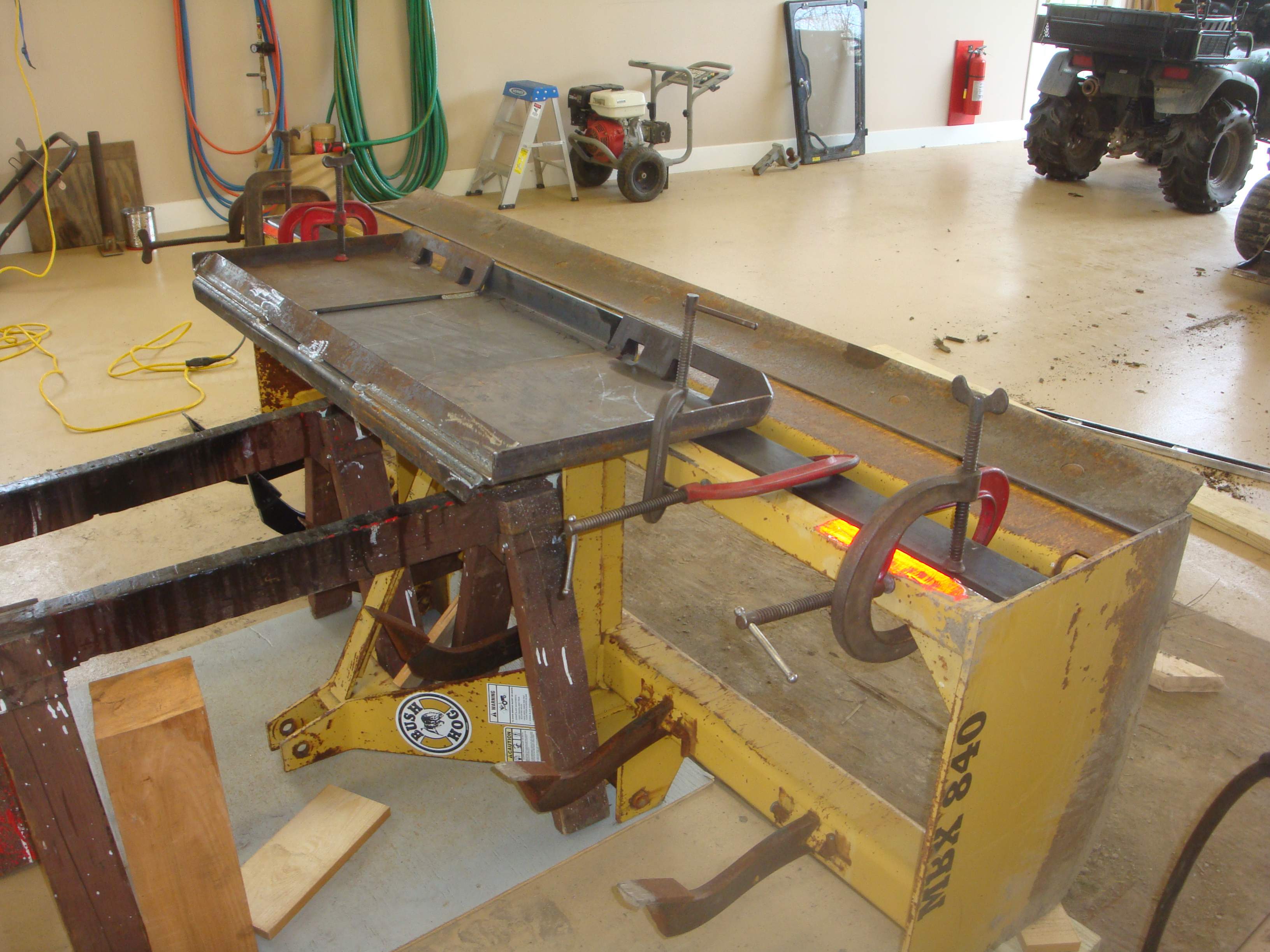

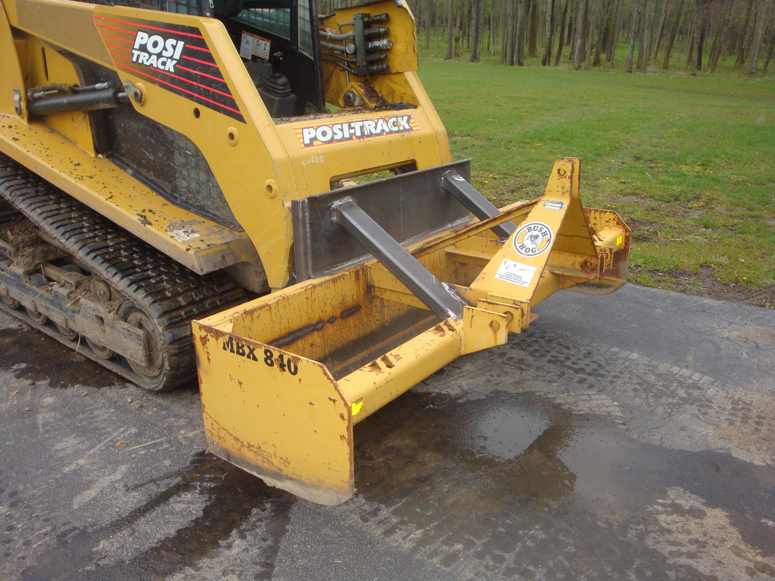

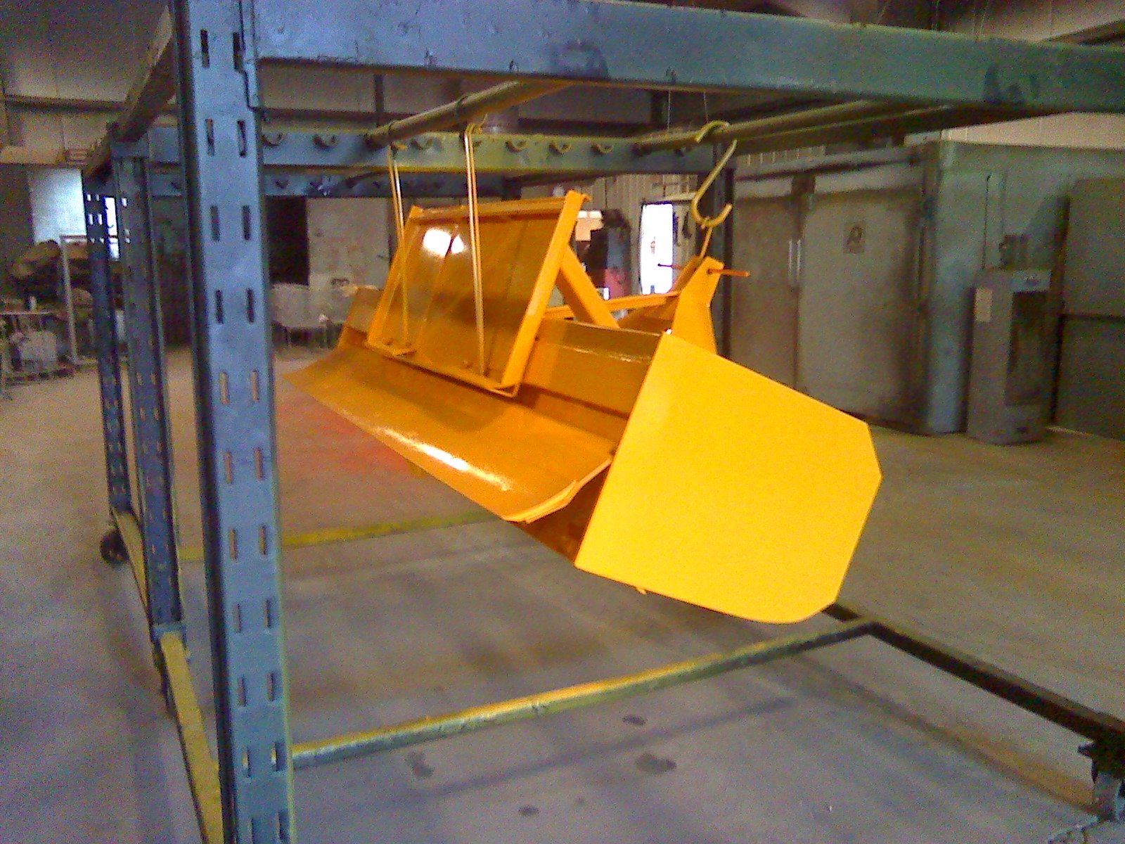

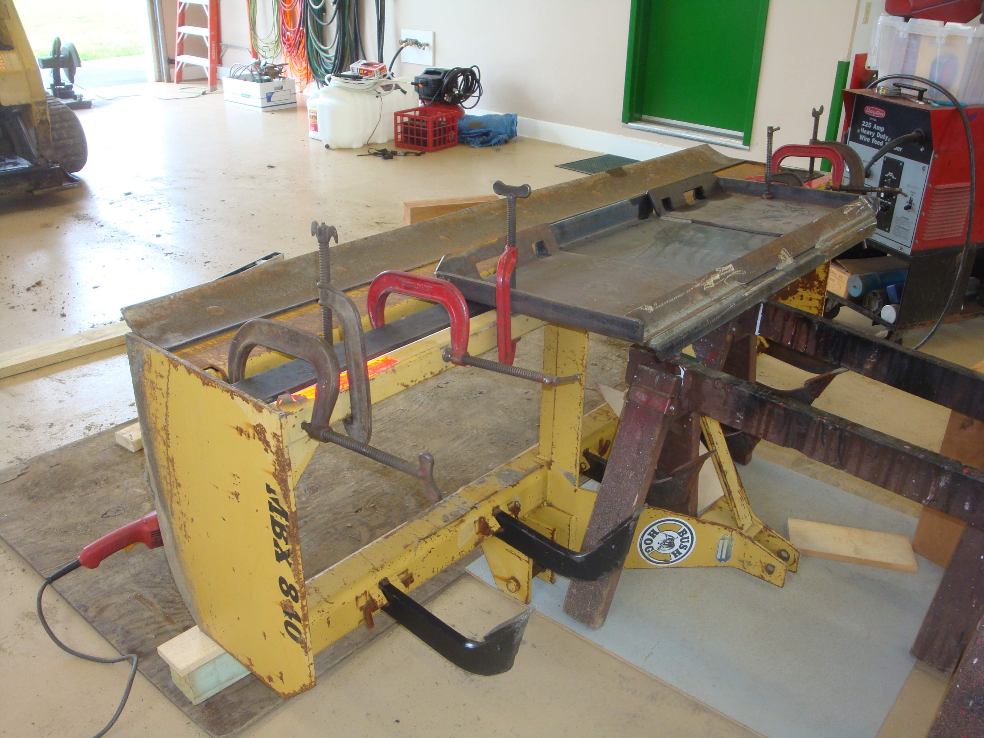

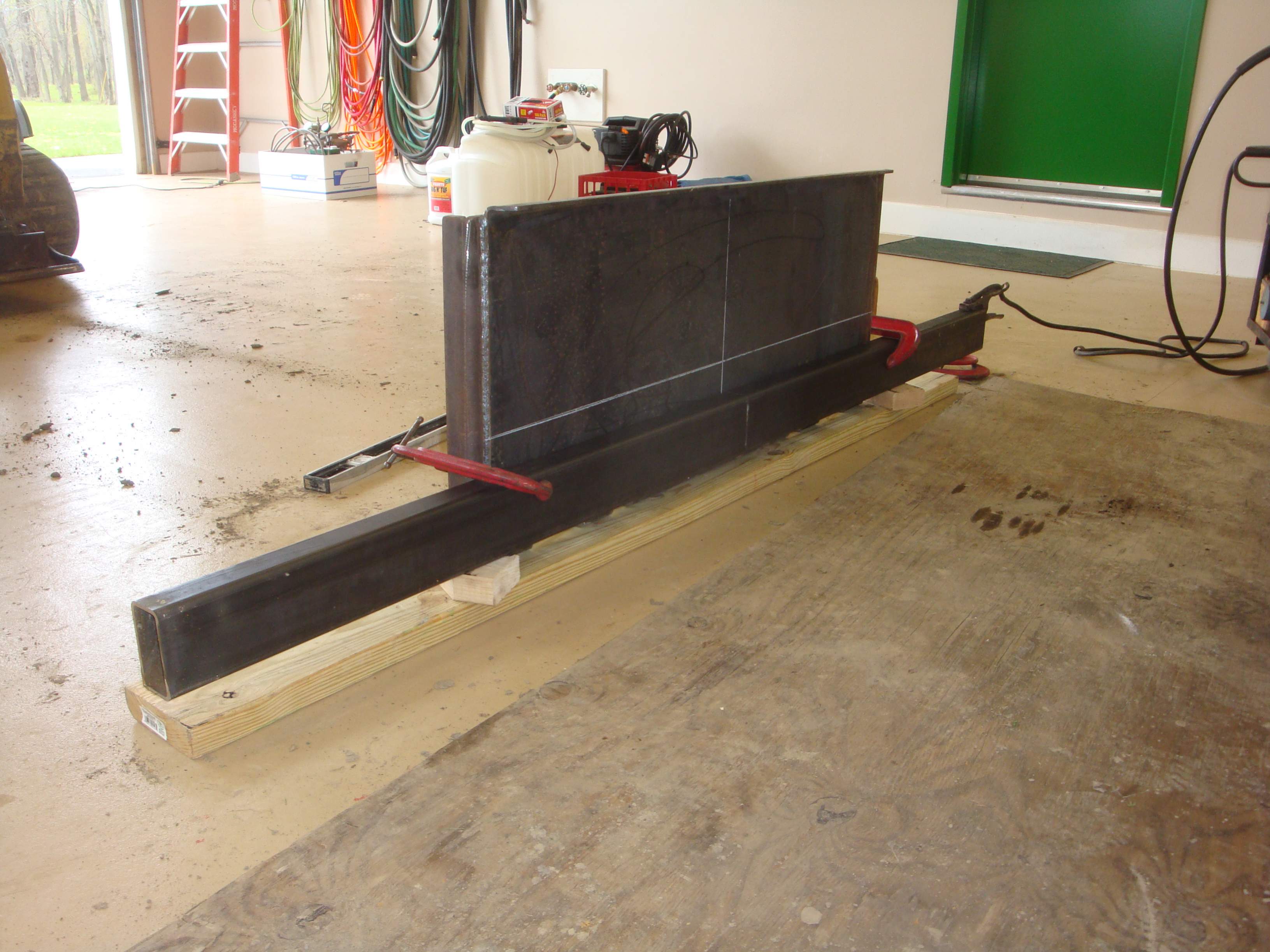

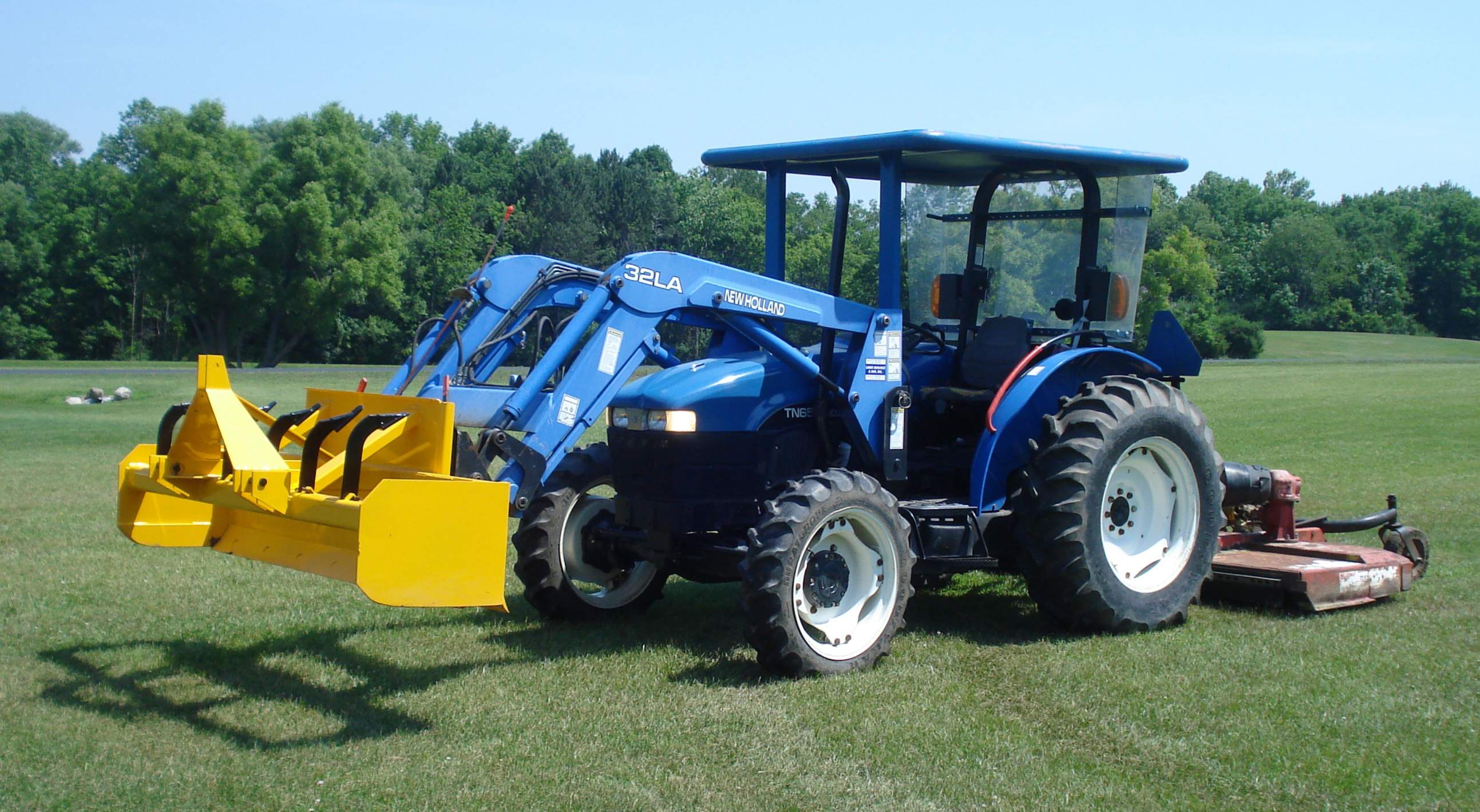

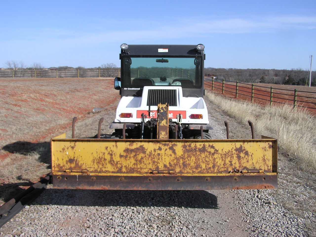

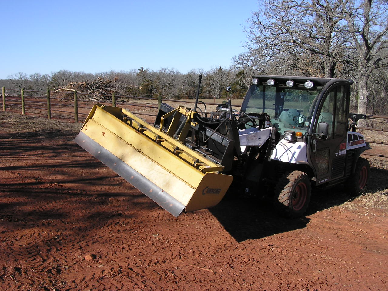

I added a quick disconnect plate on the back of my box scraper. My intentions are for grading & leveling with the skidsteer and pushing mulch into piles with the tractor. Still has the 3 point links for normal usage.The QD plate needed to be mounted high allowing the rear scraper door to hinge, but that required extra diagonal braces and removing the SS door when being used. Sandblasted & powder coated at a local shop. Extra weight should help when used with tractor 3PT. Overall, seems like an easy option for the OEM to offer.

Wow, nice work! How much did they charge to powder coat?
/ Skidsteer Box Scraper #3
Great job! I can imagine having the box blade attached to the front of your CTL would really help when you need down pressure plus the ripper teeth are great for removing roots. :thumbsup:
/ Skidsteer Box Scraper #4
Nice work, let us know how it works out in use.
/ Skidsteer Box Scraper #5
Might call that thinking outside the "box".
Have you considered the patentability of your idea?

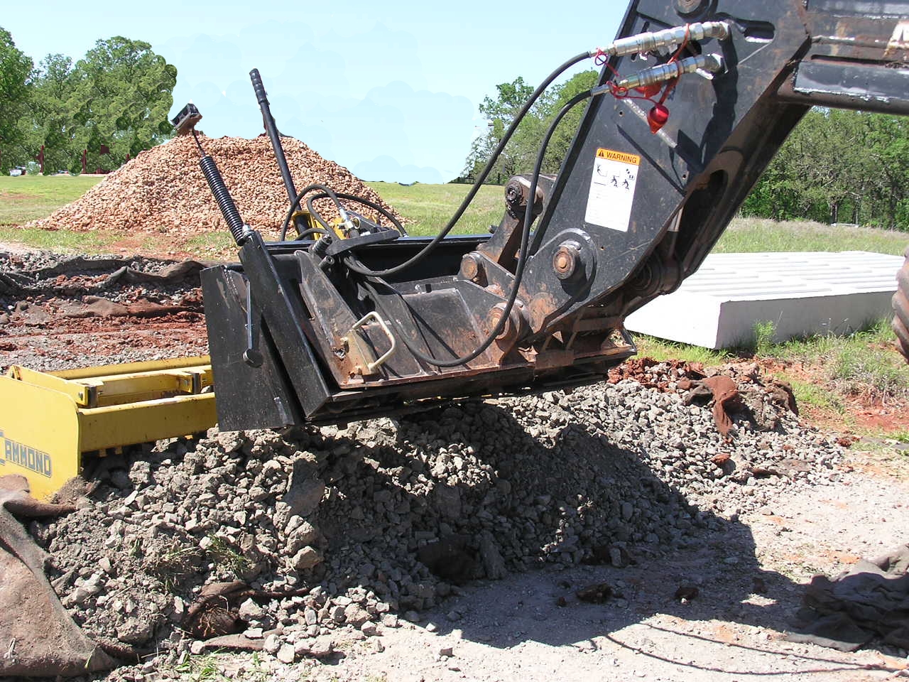

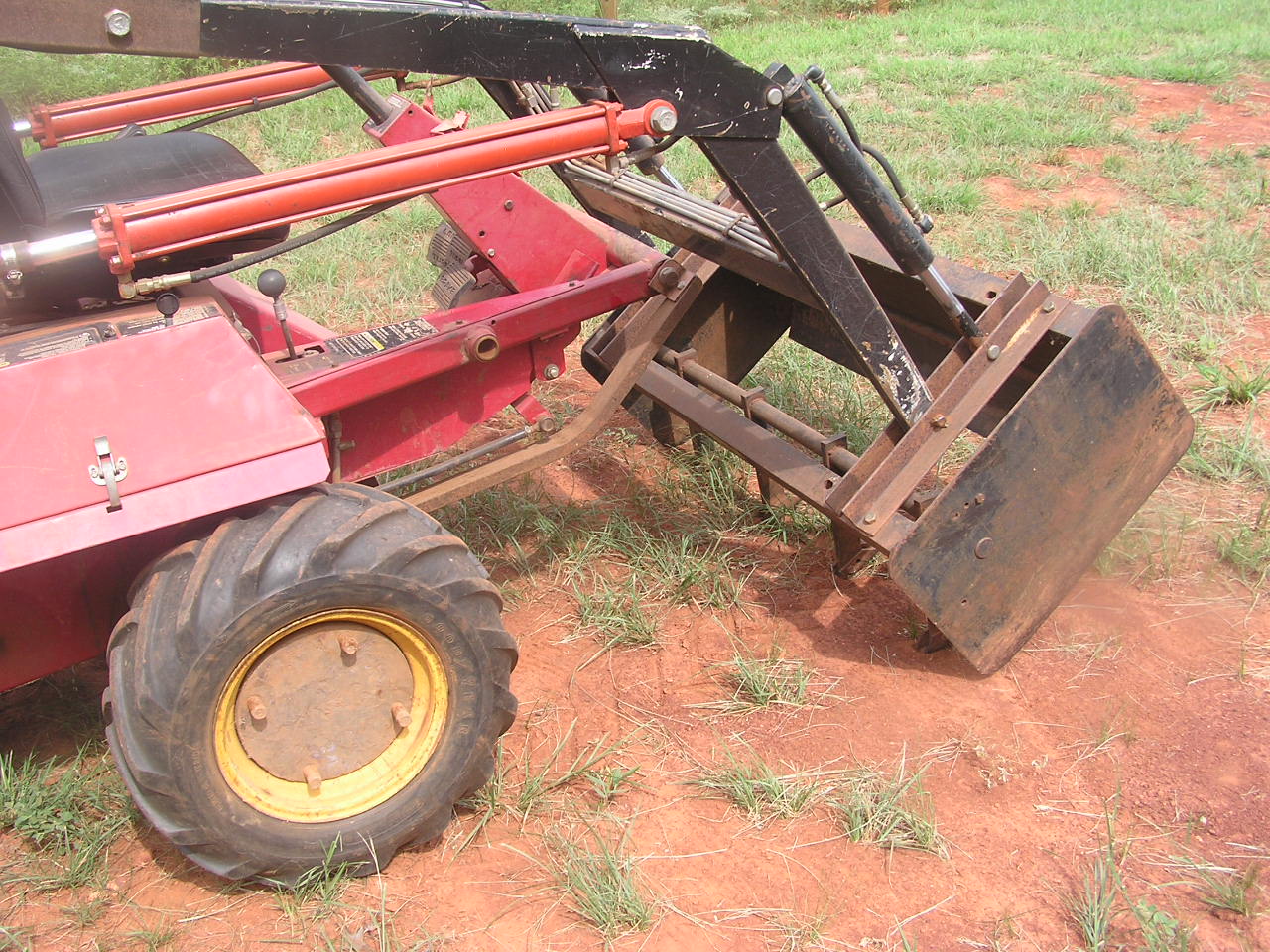

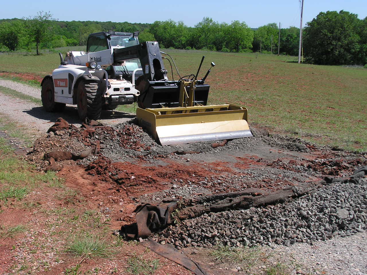

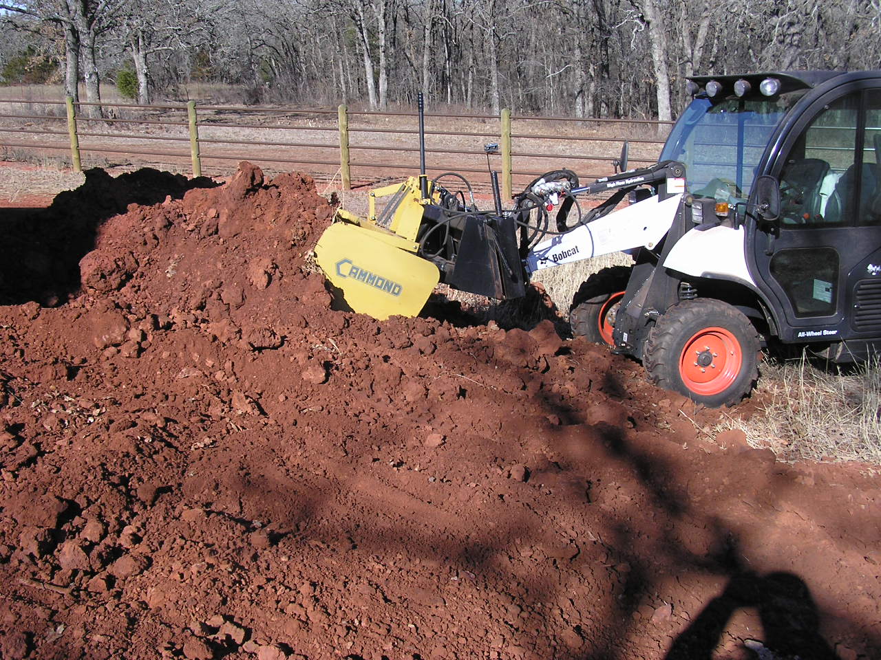

We need an update. How did it do over all? Does it tend to go deeper when pushing in hard dirt?
I pull mine in reverse, and have thought about doing what you did, but it is far down on the list of projects.
On a Tilt-Tach and a 3 point adapter.

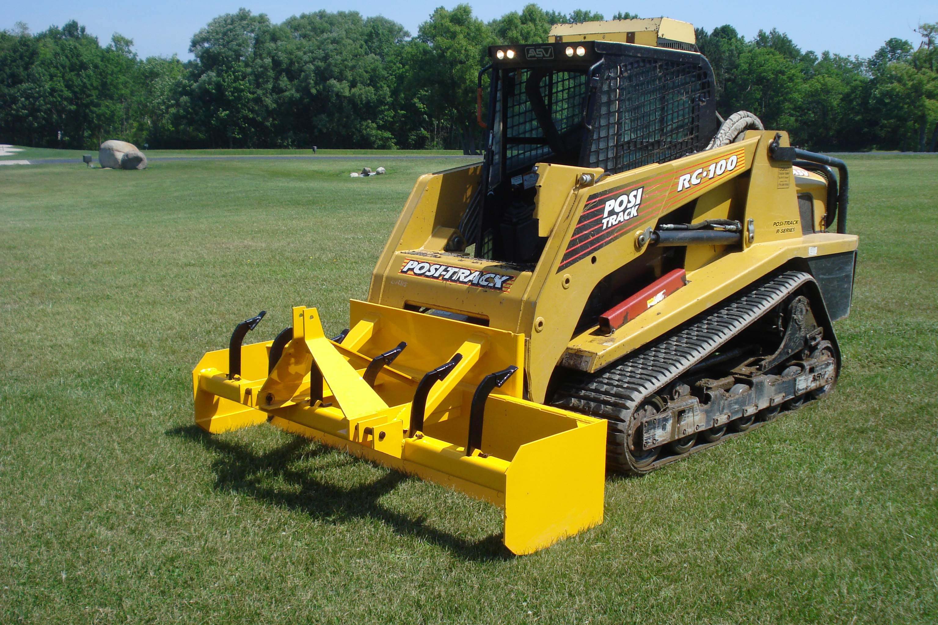

This is another cool tool box blade machine. It can do it on the front or the rear!

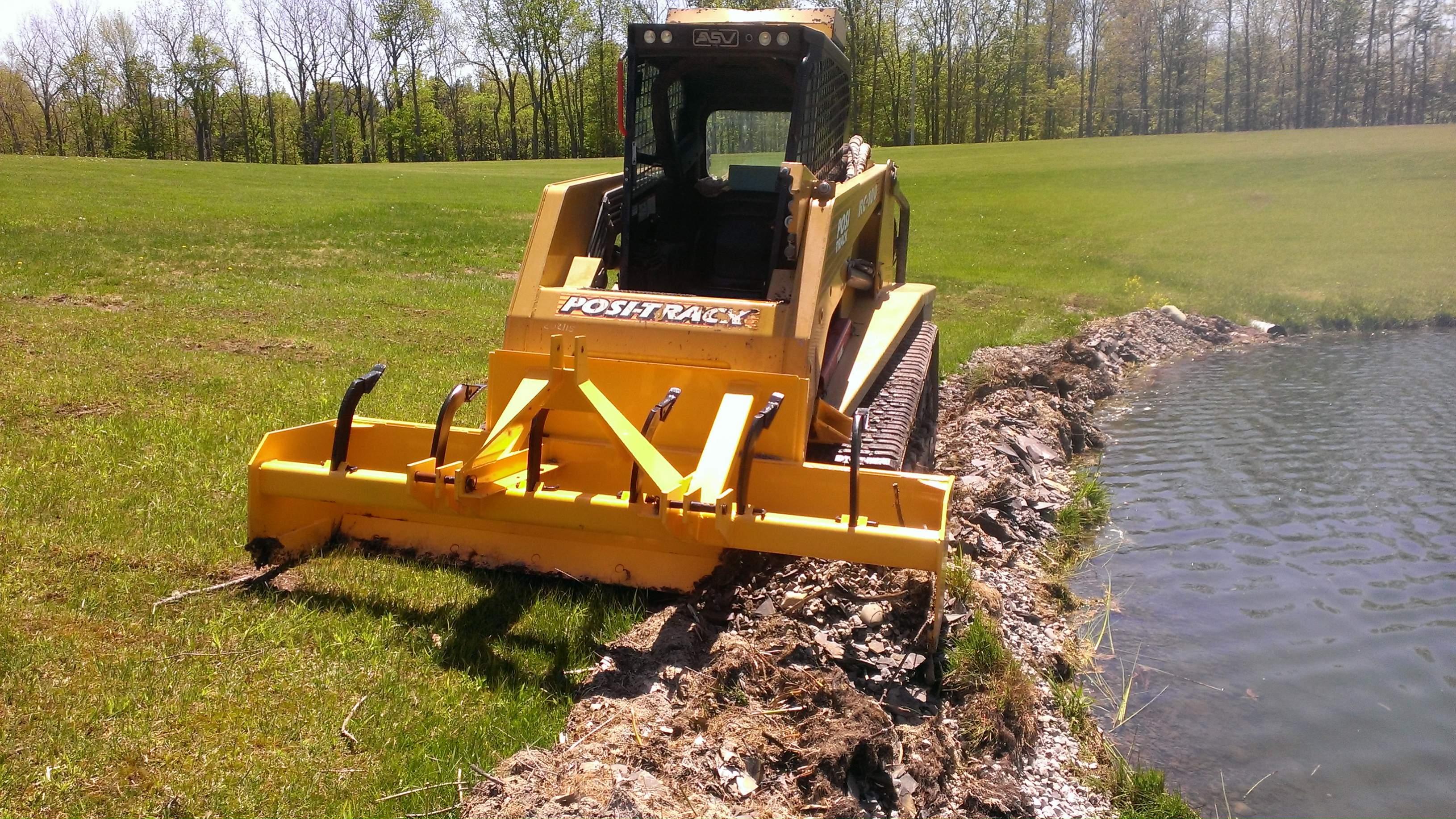

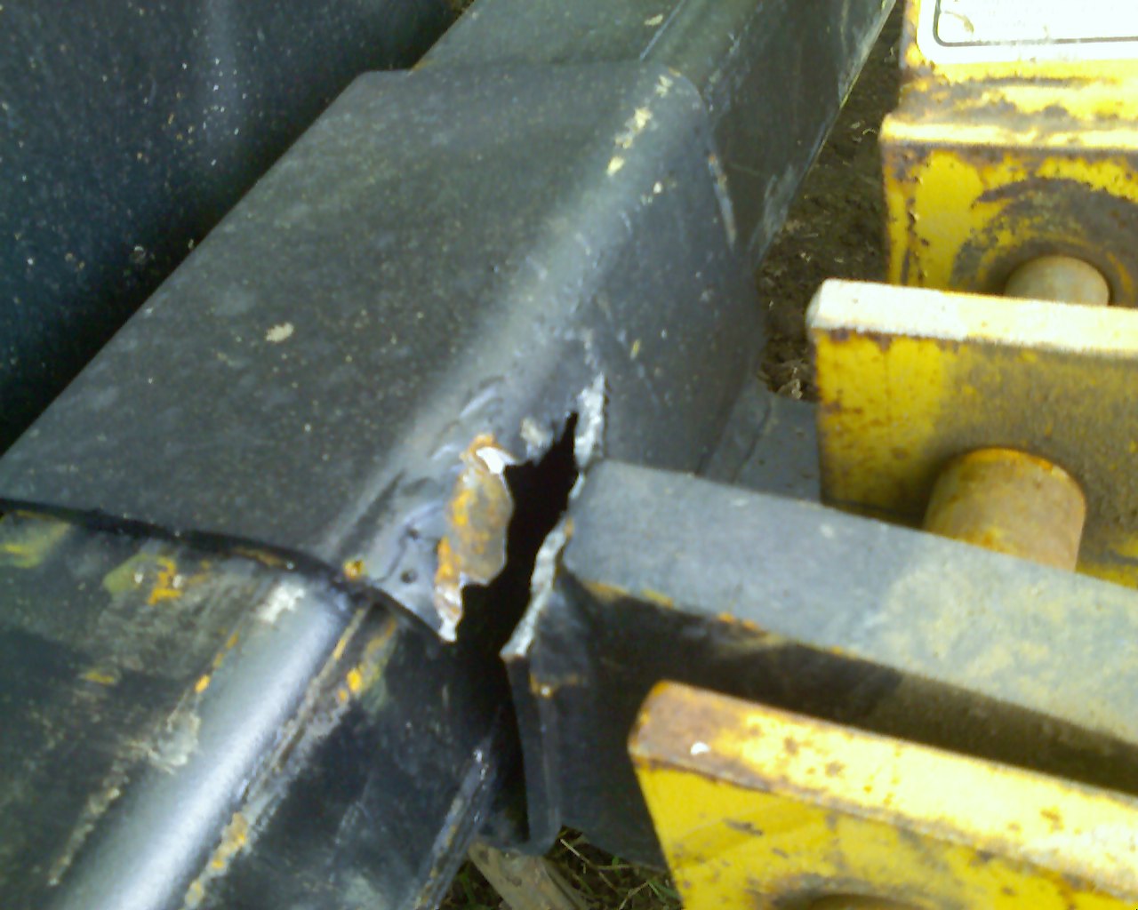

The box pusher works great, although visibility from the drivers seat is a problem. Can't really see the angle or amount of material being pushed. It produces a very level grade because the tracked machine is riding on level surface after pushing.
I also tried used a three point adapter for pulling the scraper, but the reverse stress bent the pins on the tractor quick disconnect and broke the brackets on the adapter.
I never thought about that possibility. I think my brackets are thicker, but I will keep an eye out for cracks.
