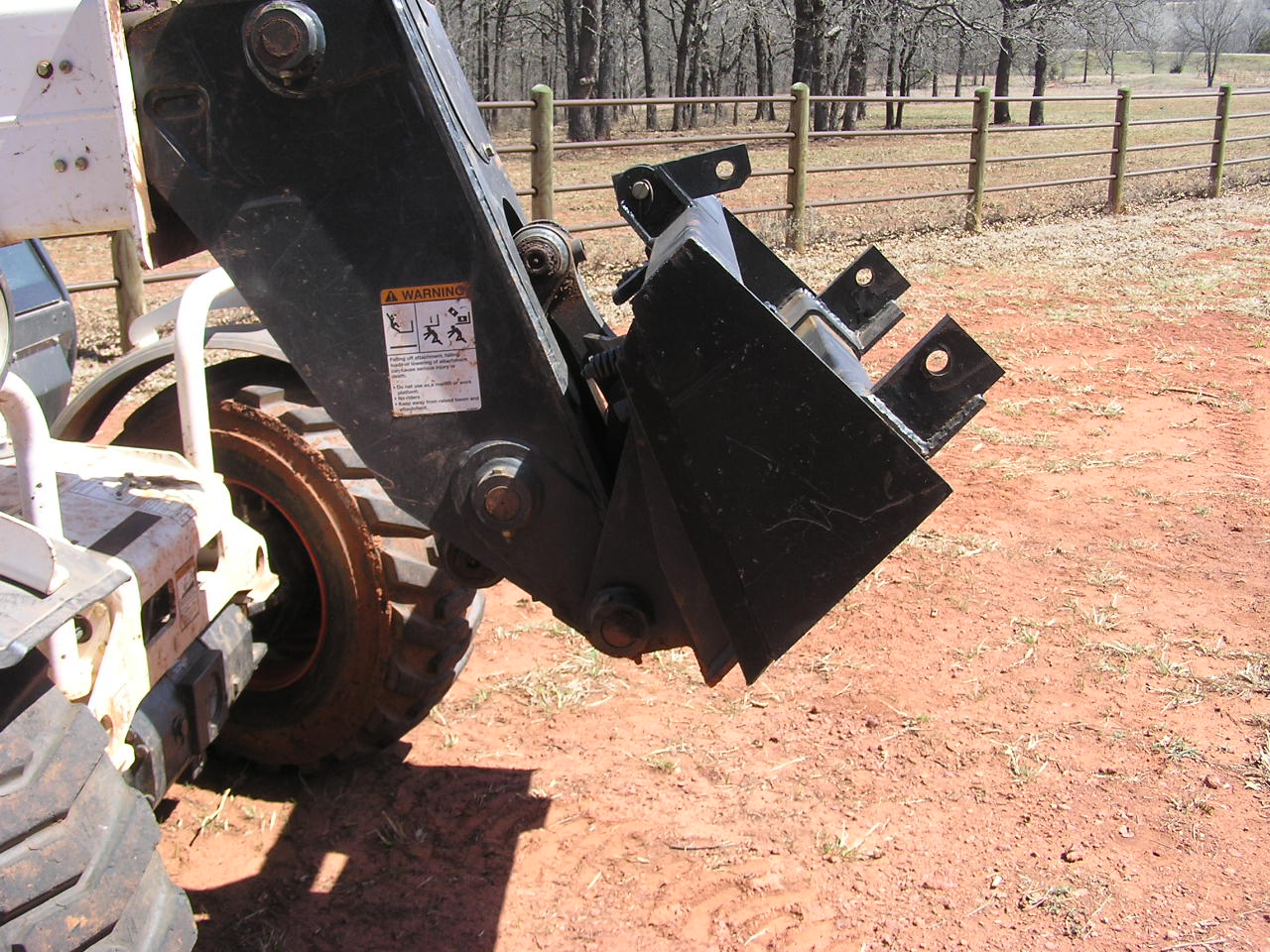

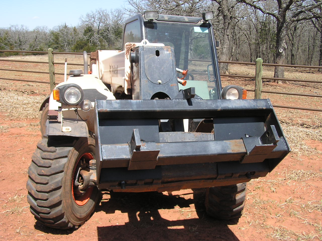

I have a bobtach frame just like this;
BOB-TACH FRAMES lwtm
I want to bolt a quick hitch just like this to it [or weld, but will wait until I know it works well, and may incorporate a horizontal angle adjuster]
john deer quick attachment (hitch)
in order to use or move my 3 pt equipment. Any thoughts or ideas?

LOL, title should have read skidsteer to 3pt I was looking at this. I should be able to fabricate some big hooks and create my own using my bobtach only???

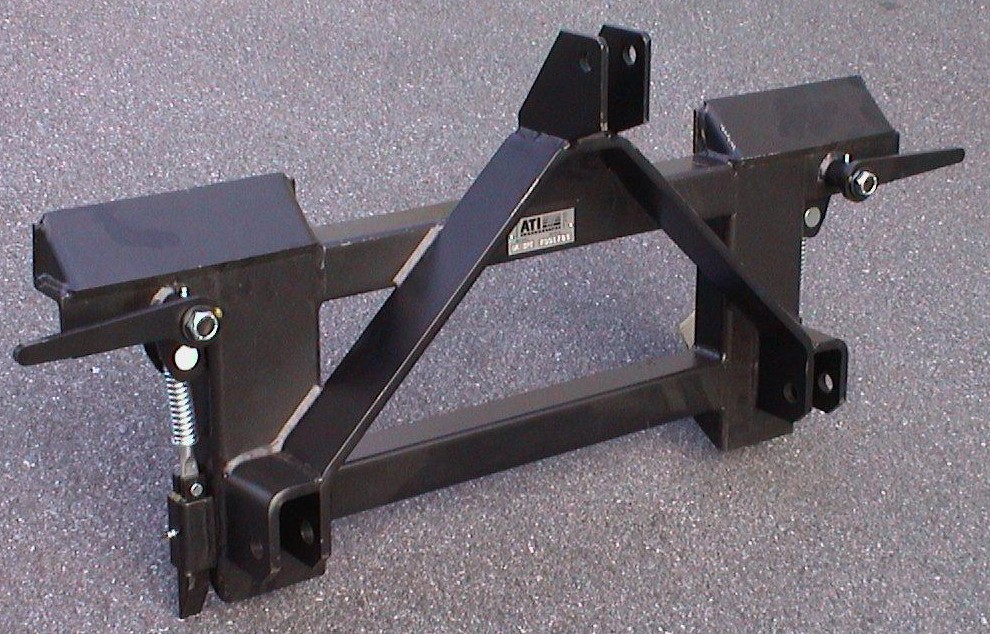

I always use my quick hitch on my tractor. Works great except I no longer use the top hook. I made an adapter and pin for this. Much easier than fabricating all my implements to fit the hook
   / Skidsteer/2pt quick hitch #5
I have a spare QH & several SSQA plates. Planning on welding them together just like this myself.

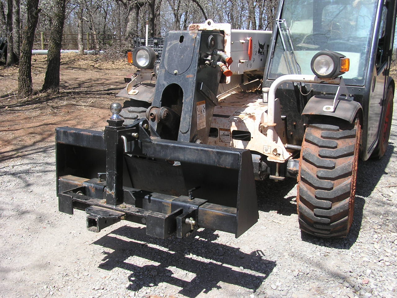

Re: Skidsteer/THREE point hitch adapter

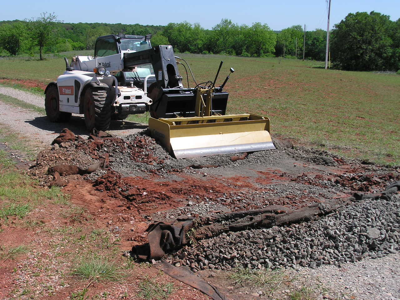

I bought an adapter, not quick, but very handy! :thumbsup:
It has extra rollback built in.

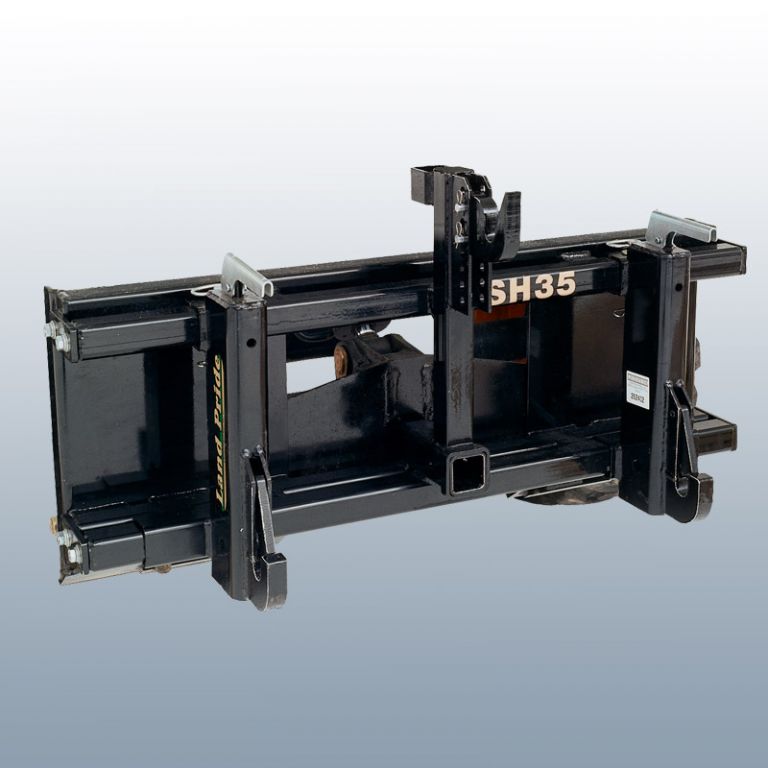

You are talking about the other end of the tractor from what the original poster wants for the Front End Loader.
3 point Quick Hitch on FEL
This is what you are talking about on the 3 point
Change your 3 point hitch to universal quick attach
   / Skidsteer/2pt quick hitch #9
I was talking about a 3pt on my loader in my first post & SSQA on my 3pt in my 2nd. Hence the also.
Its well under half the price to put a 3pt on the loader as it is to put a SSQA on the 3pt, no matter if you buy or make your own from parts.
