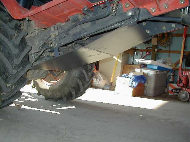

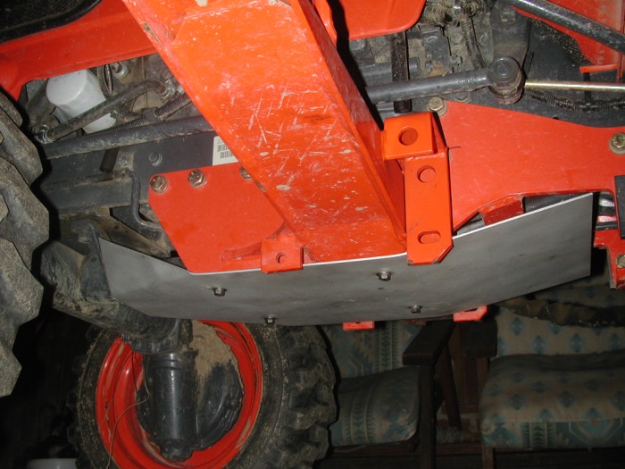

I built this skidplate for my Kubota L3000DT . I was a little concerned about small saplings that i run down to mow doing damage to my oil pan.
The plate was a little thin at 1/8 " but after i beefed it up with 3/8" x2 flat stock on the top and bottom it got pretty stiff and heavy. i had to get longer bolts for the front mount cause i used the FEL brush guard( for what it's worth) to mount the front of the plate. i just got a metric bolt for the rear and used holes that were empty anyway.
I had to kind of cut out room for the tie rods to clear the plate . that is the cut out portion and the 3/8 is ground down to give clearance. after tinkering to get a fit i got the idea of boxing the front area in for chain storage. i had some plate so i cut it to fit and drilled some holes and bolted it up. great chain storage!
a little kubota orange on the visible portion and black on the bottom and it's done.
i think it'll hold up . i'm planning on testing it this weekend to see if it was worth the effort.

Well, sounds good. I wish you could get a picture of it in place from the underside. Any extra protection has to be good. So far, I've been extremely lucky and haven't done any damage, but I've been on the belly quite a few times. Also have been working a lot of brush. It's gotta be just a matter of time though before I do some damage! Thanks for the pics. John

Good job. That is the exact way that we use to build them for customers, except ours were longer and wider. I would like to build one like that when I get time, but it has to work with my backhoe sub-frame. So it would have to be about the size of yours. Did you get holes cut, for all of your service ports?

Jerry i cut two hole for the oil drains . funny you get to cutting them and you go"i don't know if thats big enough??" you finally just have to forbid yourself from the torch. /forums/images/graemlins/grin.gif
Kind the same thing with the grinder /forums/images/graemlins/grin.gif
I added another picture of it on my homemade camping table after i had painted it. the plates for the chain box are not on . they are drying nearby.
Building something like this is kind of a creative thing cause you can't go in and buy one or look at one. i think lots of folks in the last year have thought i was crazy i would see a tractor on a trailer at a store and would have to go see if it had one.
thats how i really got ideas.
A dealer in little rock that rents has them on thiers but i wasnt impressed with their version.
I don't have a digital camera so i have to wait to get the roll i have done and processed. i believe i took some of my bottom runners. they basically run under the 3/8 top braces and really made the thing stiff.
my son weighs about 150 and i weigh about 190 and we both stood on it . it was upside down on the attach points. the thing wouldnt flex a bit.
it may be a while but i will add some more photos.

Does the front turn-up have drainage? It doesn't look like it.
   / skidplate
The front plate can drain onto the long plate. i looked at it and have thought about drilling me a hole for drainage around my front diff.
