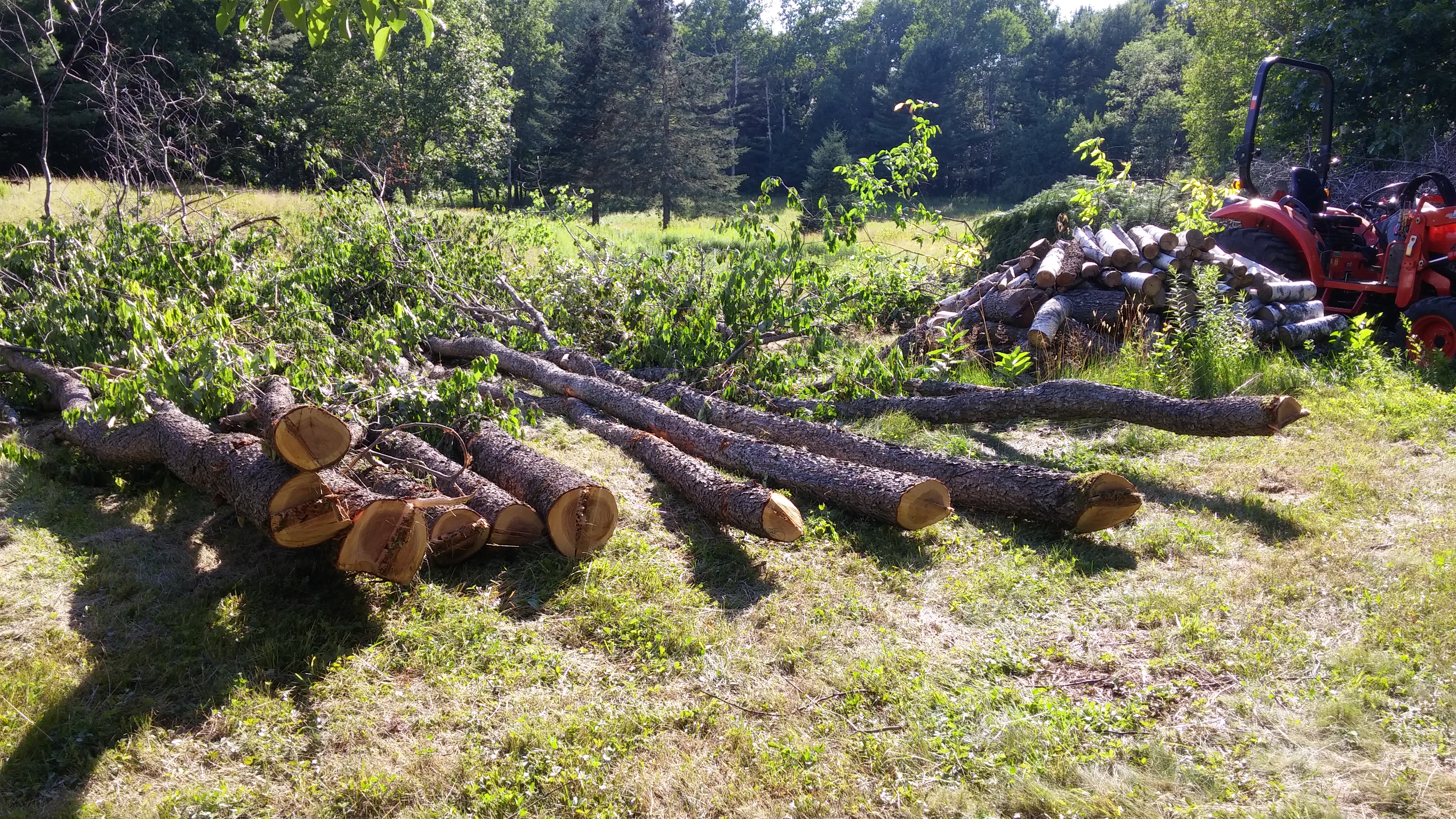

I usually cut my trees around June time frame then haul them out to my landing on the edge of my field there I let them sit all summer with the branches and leaves on in the sun, it tends to draw a lot of moisture out of the wood. Then in the fall I trim off all the branches and push them into my burn pile to burn that winter. I then trim the logs to 16ft and put them up on my cradle with my forks. I will then cut and split the logs from the pile on the cradle for wood that will be used the following year. I always try to keep one year ahead in my basement. There is always to much snow around here in the winter to be able to haul them out this time of year unless I had a massive skidder.
