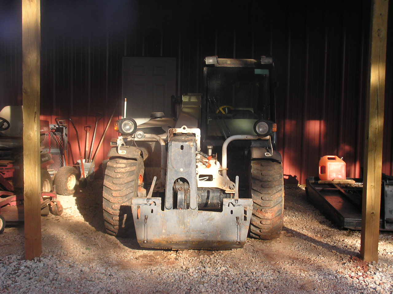

This is the tractor that I sold after I got the V518. I have never needed it or wished that I would have kept it.
This shows the size comparison to the V518, the V417 is smaller.

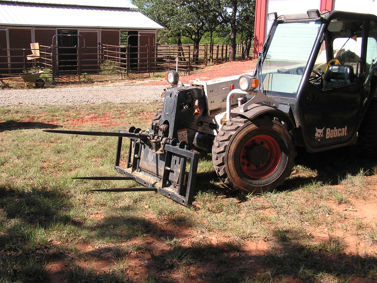

Thanks for asking, it will help people understand why I like this machine so much.
The V417 has a SSQA and 22gpm Hydraulics on the boom. There are attachments for everything in your list except the plow, but it would handle a drawbar plow, however many bottoms you can pull with 7,000 pounds that it is rated for. Rear hydraulic remotes can be added to lift the plow and a disc. I think a drawbar disc would be better than a front mount skid steer disc.

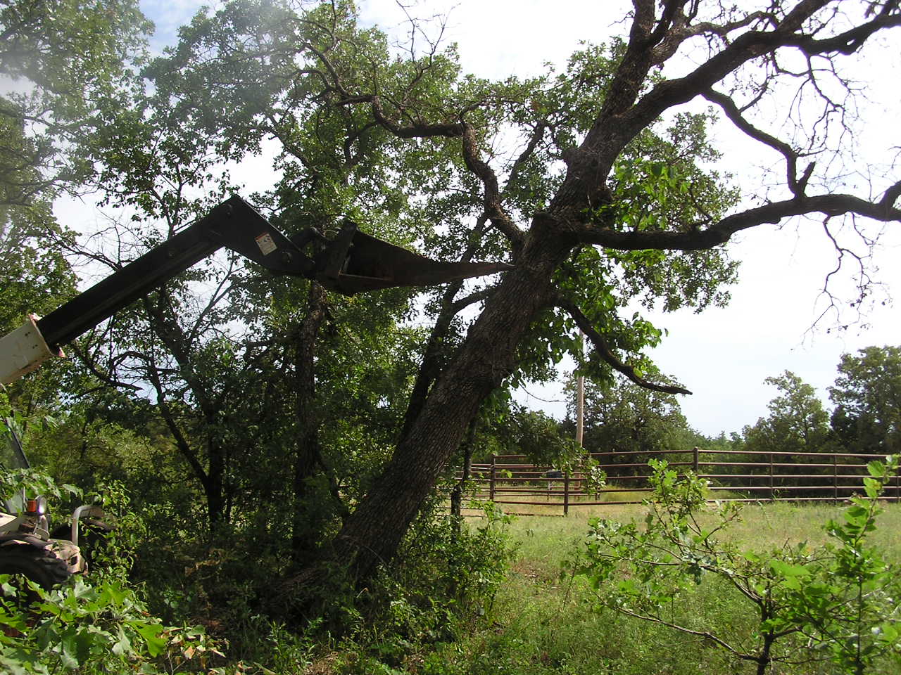

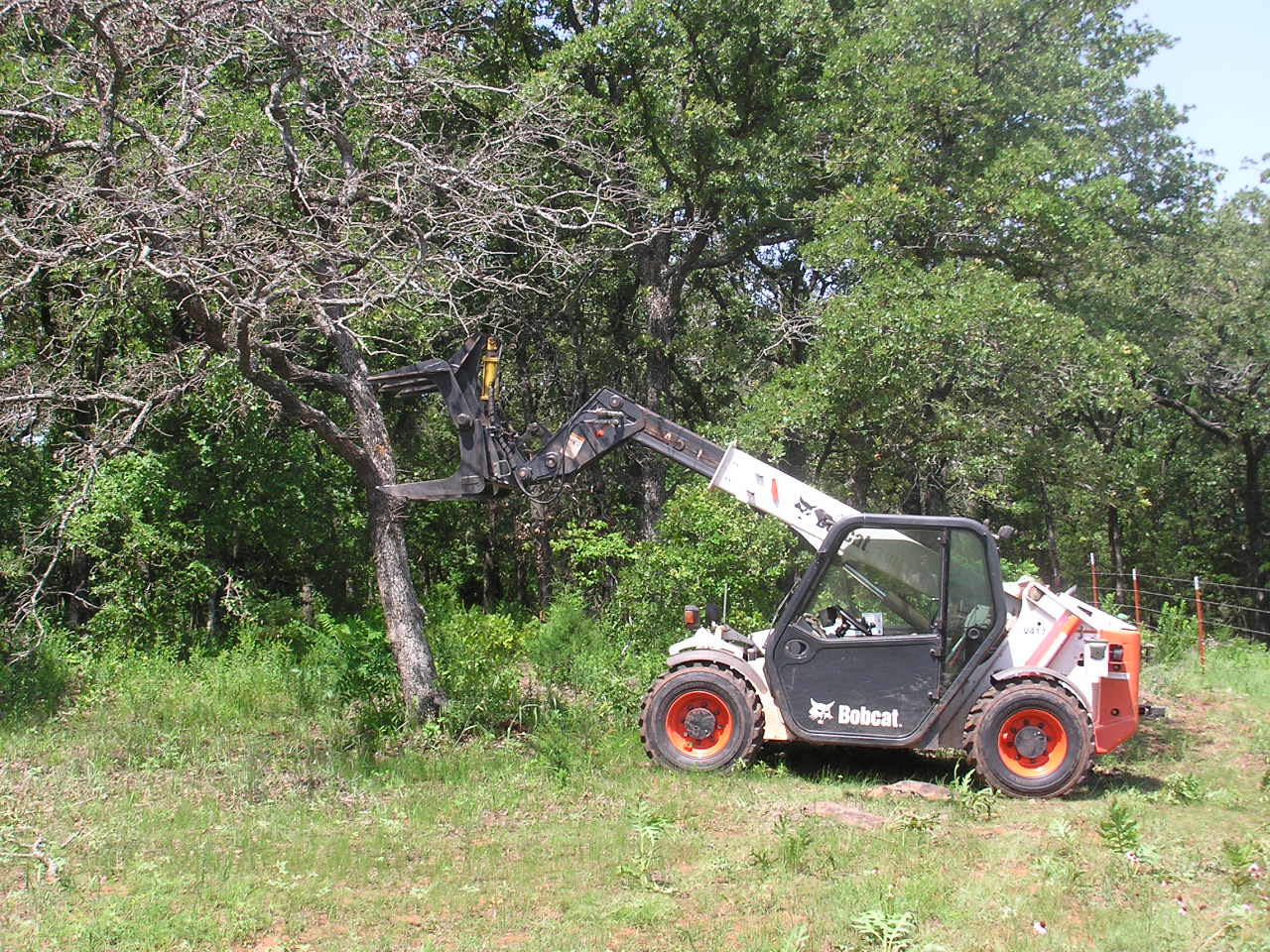

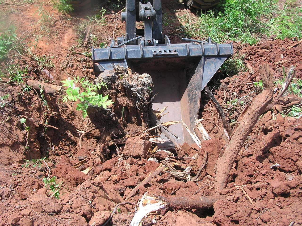

This is what I use instead of a skid steer back hoe.

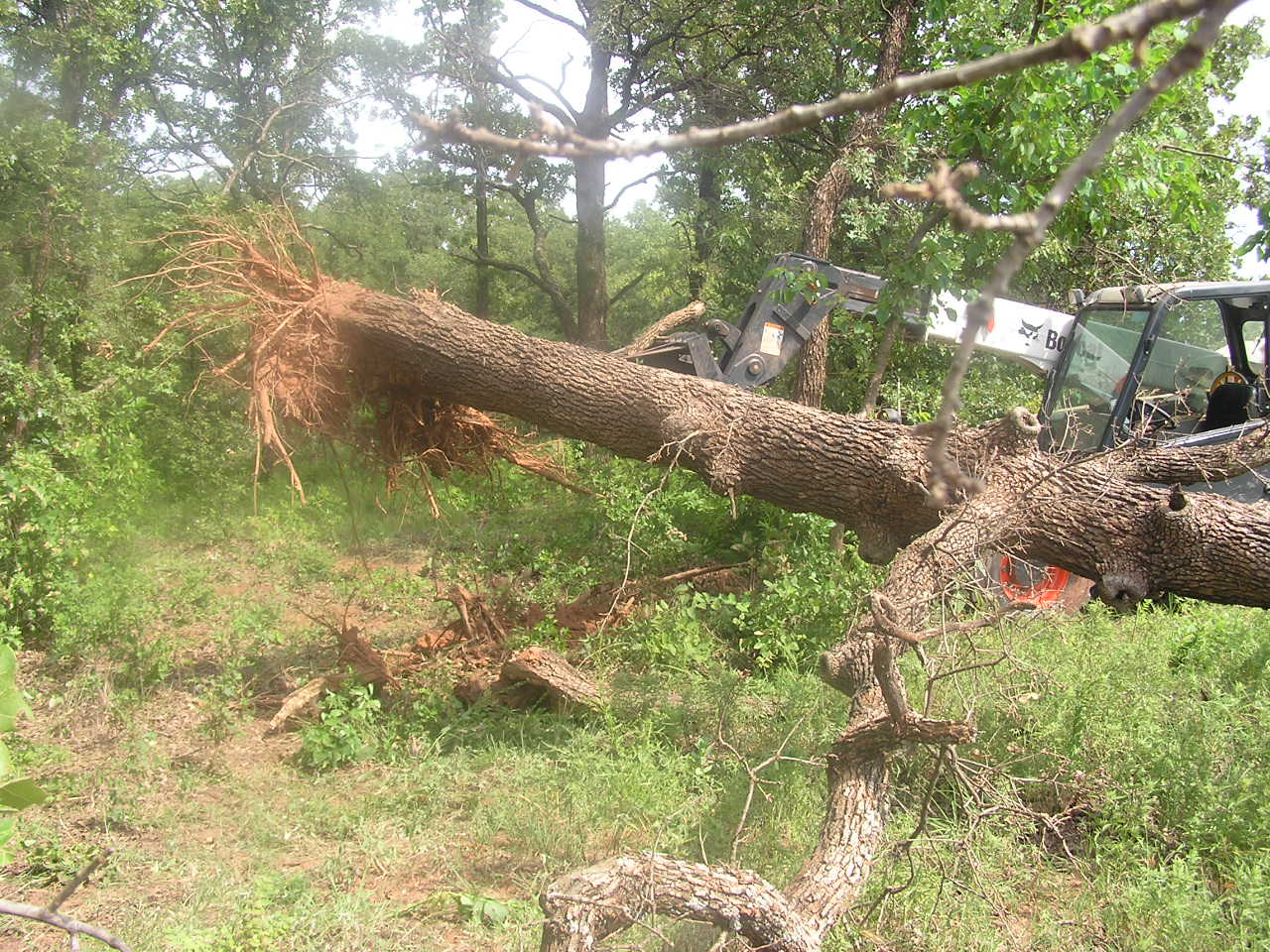

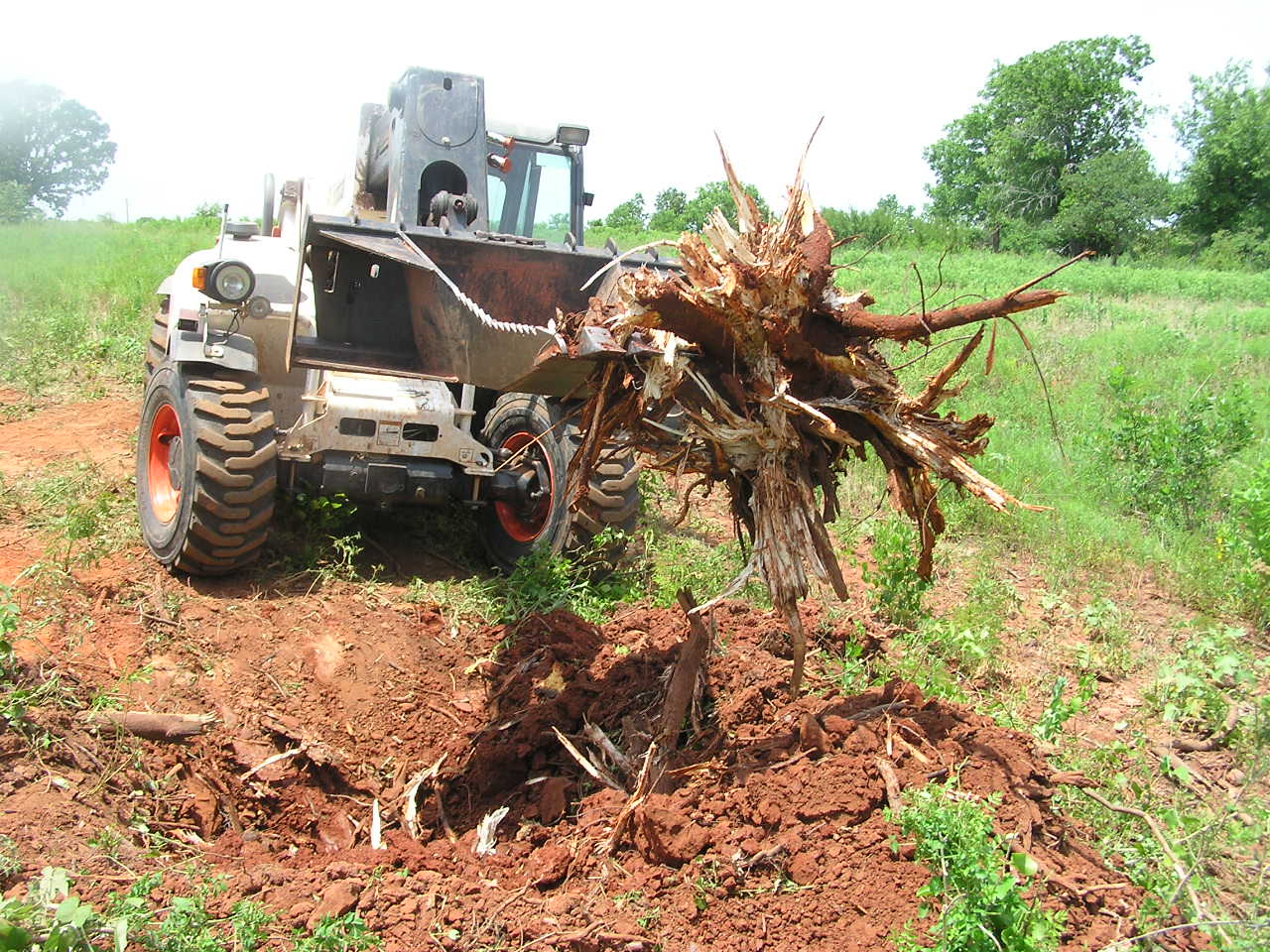

Pushed over this 40' tall dead Oak, didn't need to dig any roots on this one, some of the big roots broke off at ground level.
Had to pull the rest of the root ball out of the ground.

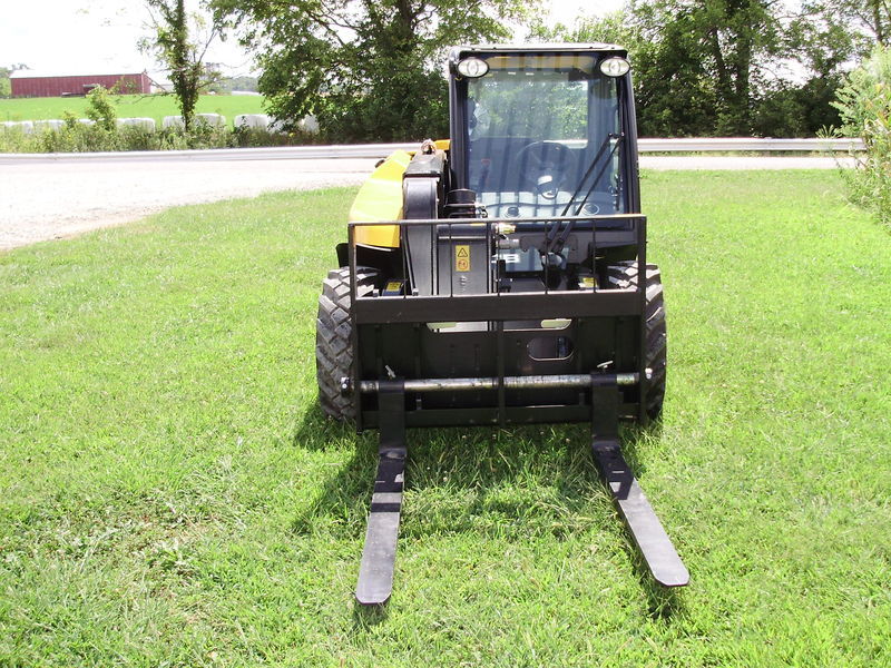

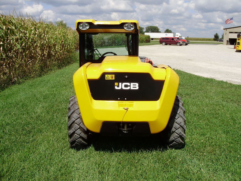

Yep, it is a about a foot shorter in height, a foot wider, and four feet longer than the Takeuchi TL8.
I guess it depends on your definition of "much".

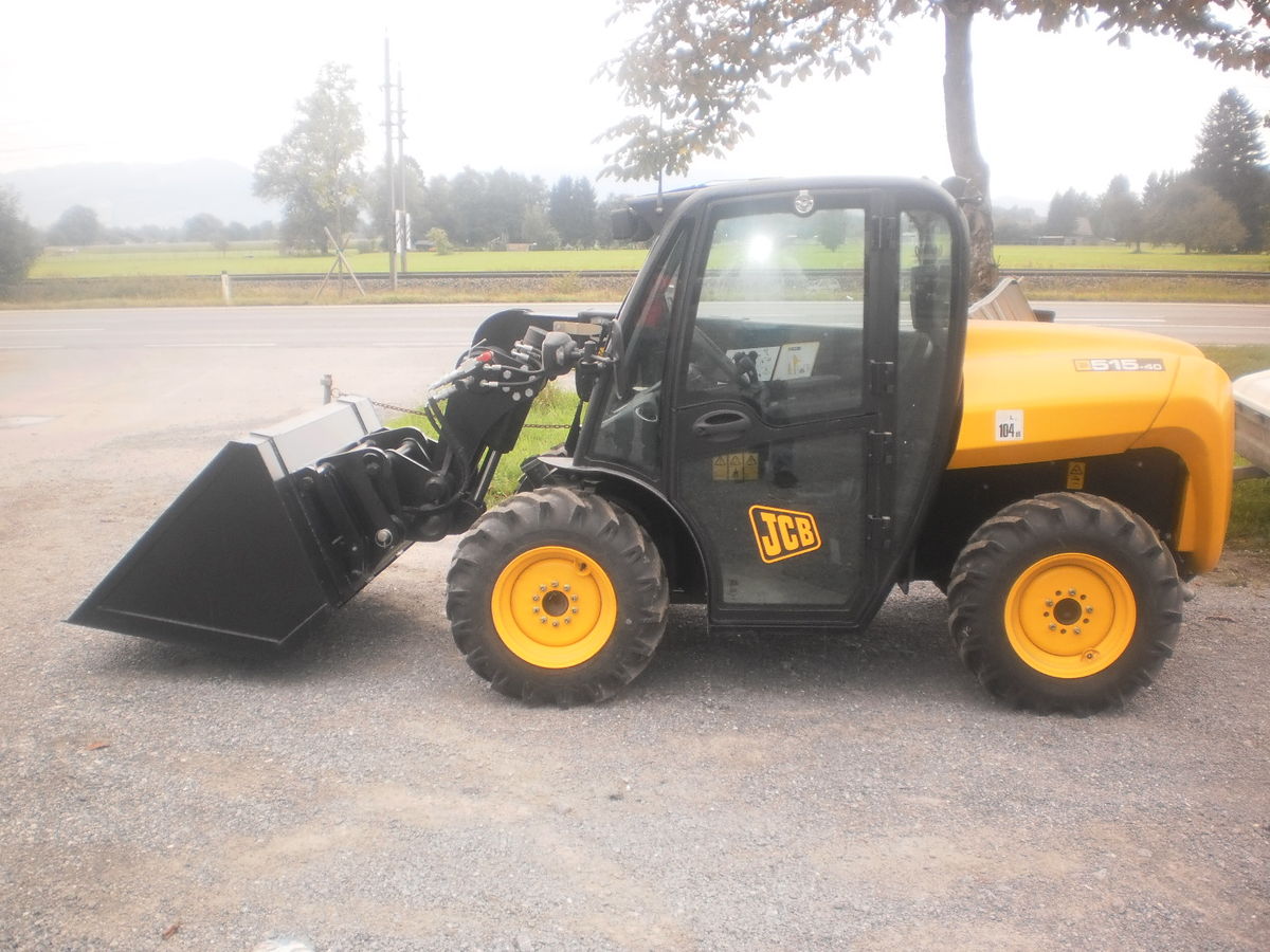

Here is one that is about the same size as the TL8, at five feet wide.
It has a SSQA and can use the same attachments as the TL8.

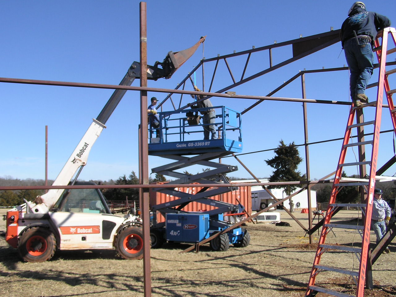

That reminds me, hauled it over to a friend's place to put the trusses up on is 40' by 60' equipment shed.

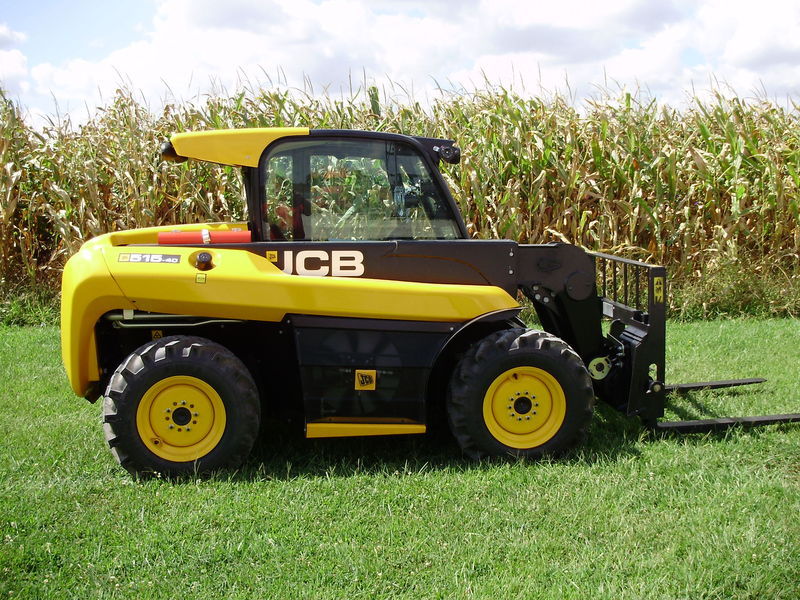

what about a skid steer with a side door? JCB makes a one armed skid steer with a side door very similar to thy on in post 32. comes both wheeled and tracked
