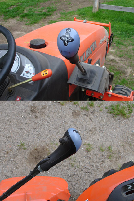

Charles, how about a picture of that replacement knob for the joystick. I also want to get a hydraulic grapple for my B3030.
There was a lot of discussion about the control for a 4-in-1 bucket recently but we've had trouble finding out who makes that knob. I've attached a picture of it. I wonder if it's the same thing you're using.

Yes, I think that's the same knob. I seem to remember them calling it a knob from a Quickie Loader.
How do you like yours.....
Thanks,
Charles
