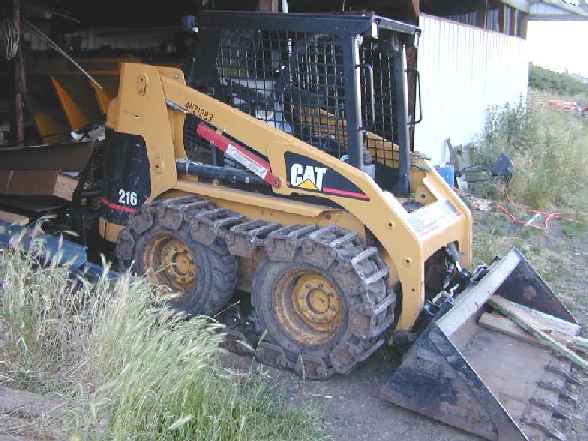

I don’t have a 3pt adaptor. I need to have an application for it and haven’t yet found one.
Hoeman00. I built an 8’ leveler to level my barns. I’ll try and get some pics this week posted. It works really well. With the wheels behind the blade it does a great job of knocking off the high spots and filling in the low spots. It is perfect for leveling gravel. I drag my road ways with it all the time.
I keep my tracks on from late fall to early summer. I am amazed at what that little tractor can do. Put the tracks on and it becomes a go anywhere tank.
