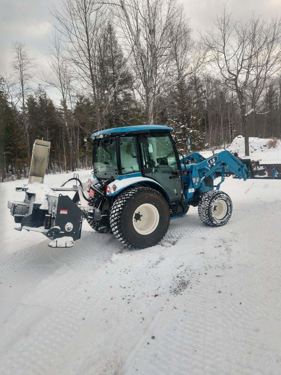

After looking at front mount blowers on the L series Kubota and the LS I came to the same conclusion. I do not want to deal with a subframe that has to installed for the winter and taken off or hooking up a mid mount PTO laying on my back.
I bought a pull blower for my LS. FarmKing 74" for $4k new two years ago. Plus I can mount an old rear blade on a SSQA adapter so I have a blade for scraping and light snow falls. The SSQA adapter was just over $200 but has gone up in price:
I bought an old light duty blade for $100. So I have less than $4500 in my snow removal.
With a light snowfall, you can windrow the snow and then one pass with the blower and you are done.
I get 100-140" of snow a year and so far so good.
