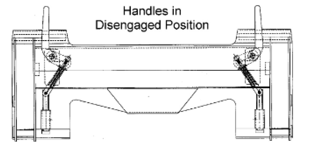

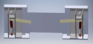

I am trying to convert my Mahindra 3016 from pin on to SSQA. I bought some starter plates off Amazon. I want my levers to not be to no be between the mounting ears but if I stay at the standard SSQA spacing, I don't see a way around it. Mahindra must be using a narrower ******* spacing in order to get the lever to be between the mounting ears not underneath them. Aftermarket buckets have a lip across the entire top of the bucket. Factory ones adhere to the standard and don't have the inner set of lock pin holes. The levers being under the mounting ear increases the standoff distance and adds thickness to the adapter. Amazon.com: ECOTRIC Universal Skid Steer Quick Tach Attach Conversion Adapter Bobtach Latch Box Plate Weld On QTK : Patio, Lawn & Garden
/ Skid steer quick attach widths
Ok here is the problem. It looks like Mahindra used a norrowed down version of the SSQA or a ******* configuration in order to get a low profile with the levers between the locking pin mechanism as opposed to underneath them. So they have wacked about 2 inches off each side and used the inner locking pin hole in the bucket side mounting plate. Their mounts are not at the normal 44 inches wide but maybe 40 inches wide. So a Mahindra could mount to a SSQA bucket with 2" slop on both sides but a skid steer could not mount to the Mahindra bucket because it is a ******* 40" wide setup. The ear spacing on my tractor is 32 inside and 39.75 outside. Which puts the locking pins about 36in apart which is right in the middle which is where you don't want it to be because now you have to move your mounting holes farther back. If you can have your locking pin not underneath your mounting ears then you can be 2-3 inches closer with your bucket. The first image is my CAD drawing with the Amazon latch plates at 44 inches and my loader ear spacing. The second image is a drawing of the Mahindra quick attach which I don't have and I am trying to reverse engineer. I may have to compromise and live with the pins being farther away from the bucket or start from scratch and make new latch plates from scratch. The Kubota bucket that I bought does not have the inner lock pin holes so it would have to be modified if I cheat like Mahindra did and make a ******* SSQA. As an engineer, I don't like standards that are not standardized.

The problem is I will have to have a larger stand off distance from the loader arms to the bucket if I make mine SSQA compliant. I can make a narrow version which is quite common, I am finding out, but it won't fit my Kubota bucket. So if I go with the narrow version, I will have to use the inner lock pin holes which my bucket does not have, or make mine standard width and reduce my loader capacity because the pins will have to be 3 inches farther away from the bucket. Either way, I have to modify some stuff. I am trying to figure out which way is going to give me the most benefits with the least about of fabrication. A generic SSQA adapter that you weld your bucket ears to will add about 6 inches to that bucket stand off distance, which on a small tractor will kill lift capacity.

Ok, looks like I am going to go with the standard 45" wide configuration and I will only gain an inch of thickness. I will have to start from zero to narrow it down.
/ Skid steer quick attach widths #13
I know your exact problem you are having as my loader has 29” between bucket ear mounts, and 37” to the outsides of the bucket ear mounts. I’m thinking about using the smaller inner hole on the qa and just adding a few inches to the top piece of the latch handles (angle iron) to fill out the 45”. I’m not sure what the correct or best way is to go about this whole situation but that’s what my plan is currently. I’ve seen a lot of loader side quick attach that have the extra few inches wide added to fill the 45” ssqa plate

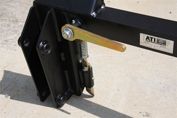

There are several companies that make Quick Attach to fit compact and sub compact tractors, Here is one that supports TBN: https://www.everythingattachments.c...k-Attach-p/ati-hitch-tachall-quick-attach.htm
I tried reaching out to ask tractor mike. I asked if they had a cross reference for, or a quick attach that would fit my older off brand tractor and just got pointed to the diy qa kit, the problem the original poster and myself are having is that our loader arms are spaced differently than what is available from ati and other companies. In my case I’m just going to copy the design of the picture you posted but since my loader arms are closer to center I will just have the top angle iron triangle piece that picks up the bucket run longer another few inches on each side.
