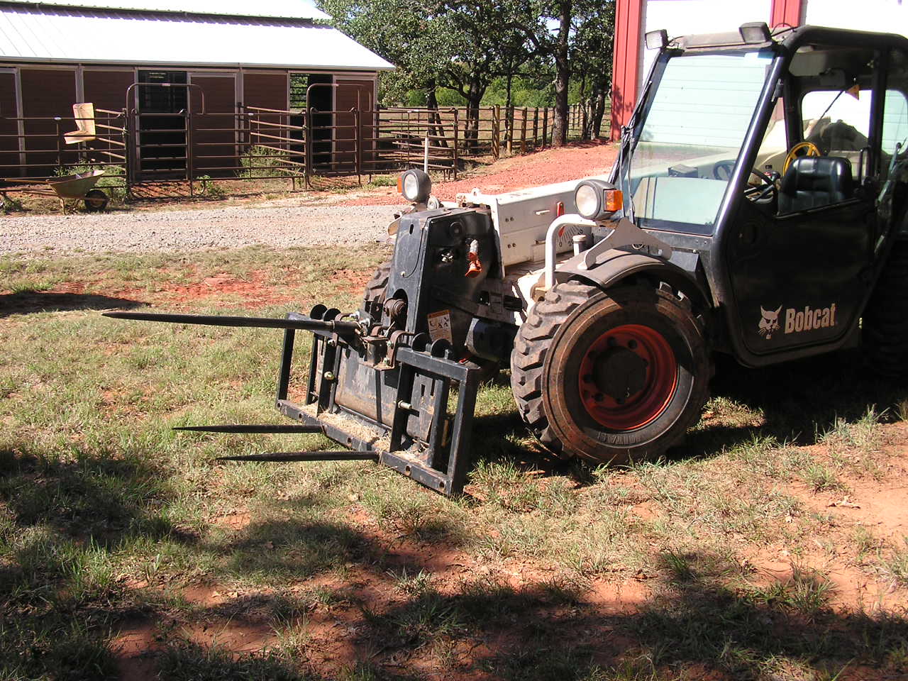

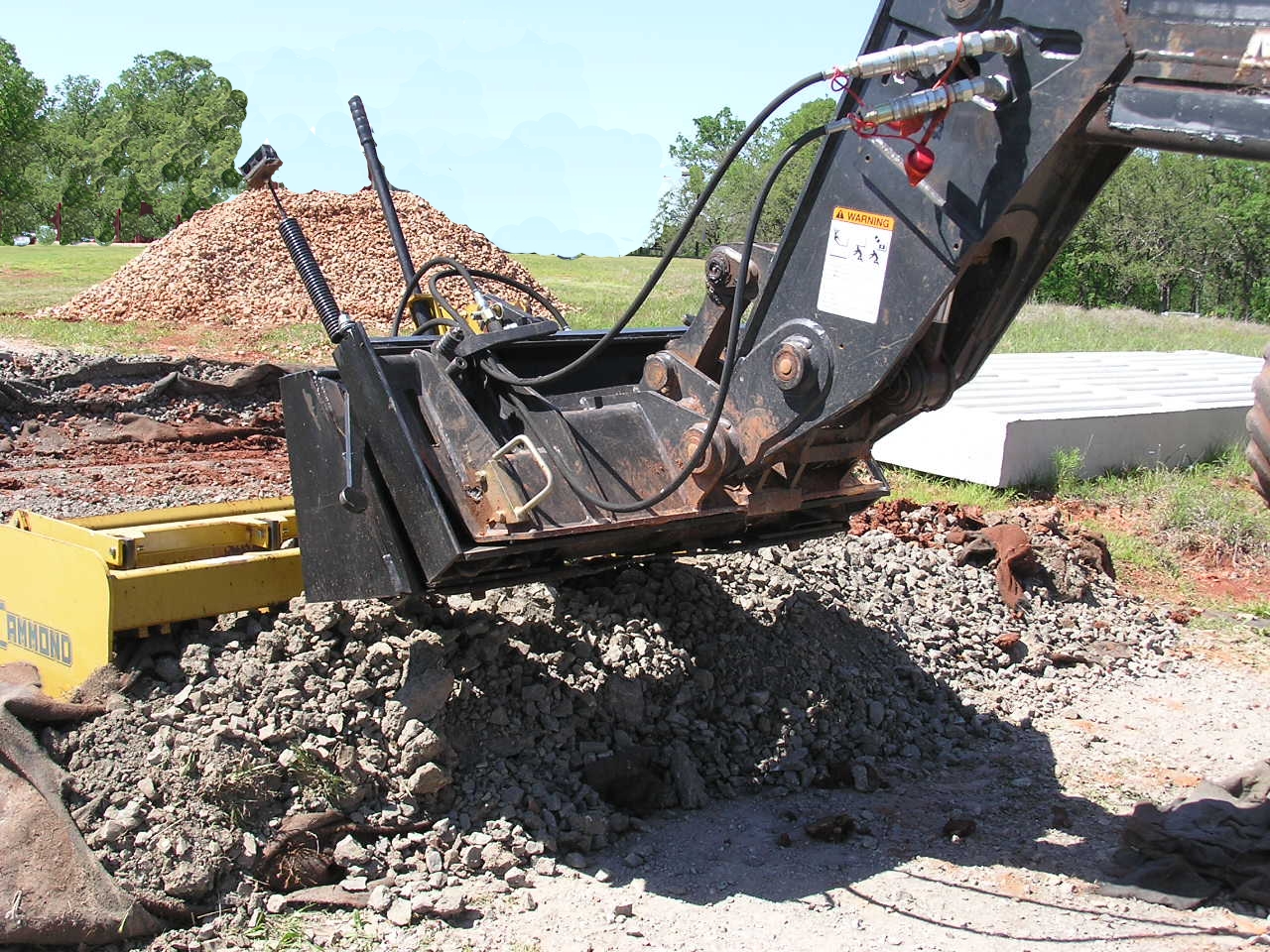

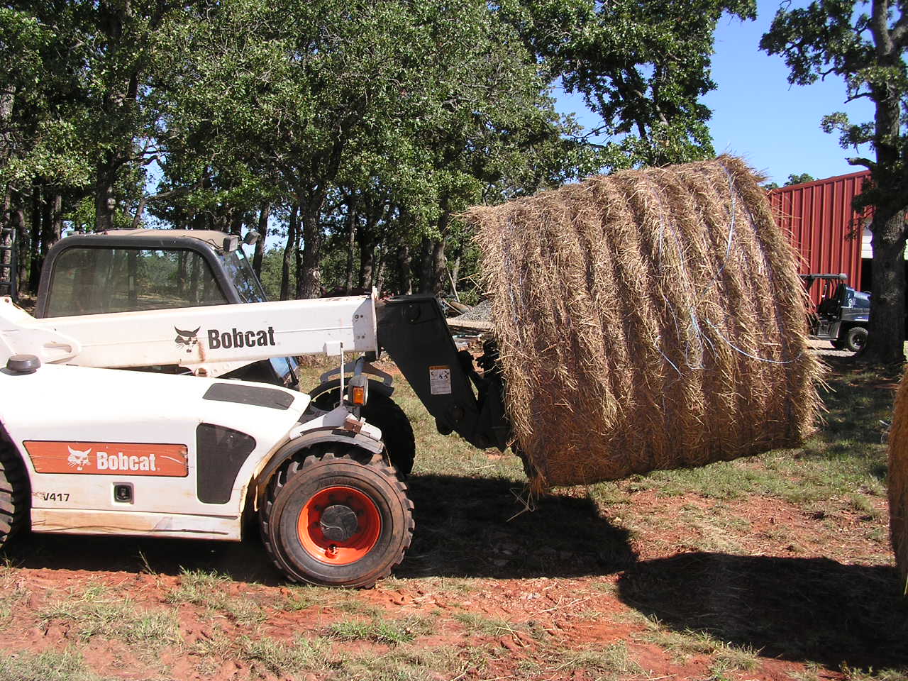

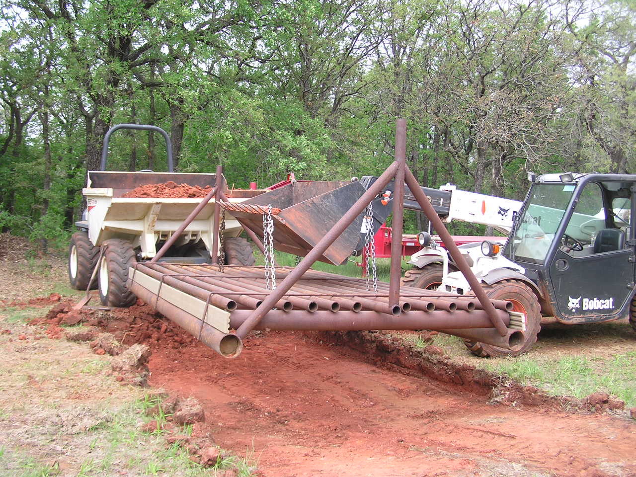

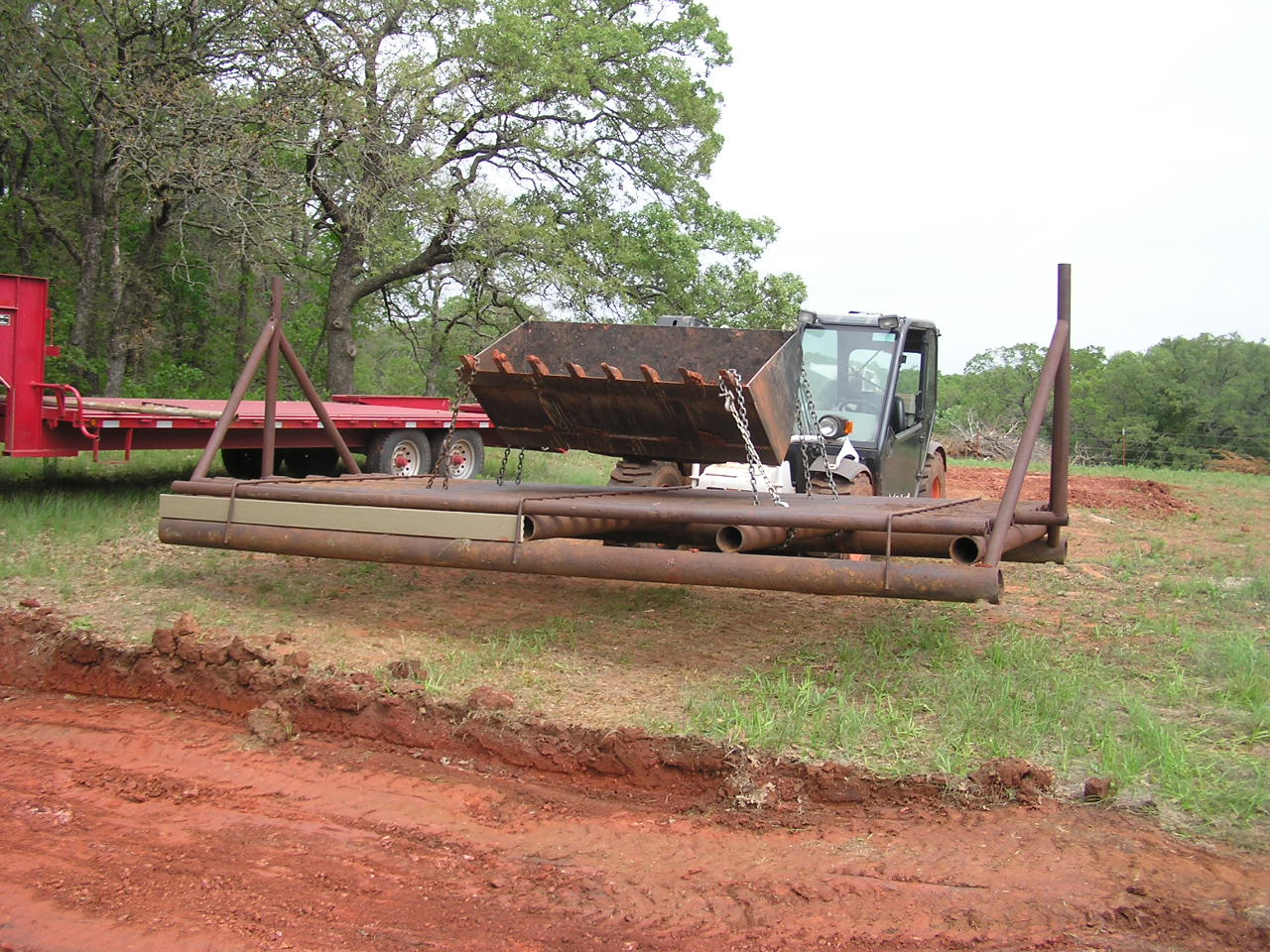

I recommend a compact telehandler. 4WD 4W steer. It is a GADA machine (go anywhere do anything). :D
A 5x6 round bale.

The out front 6' box blade on a tilt-tach.
Installing a cattle guard.
