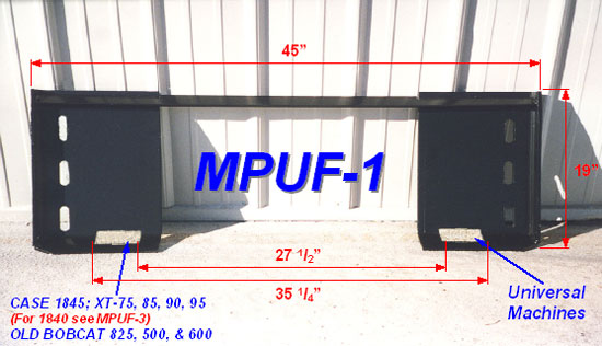

I converted my FEL from a Koyker mount to a standard skid steer mount so I could get a grapple and at some point a set of pallet forks. In doing this I purchased a SS plate off ebay and had it welded to my bucket. I'm having problems getting one side to latch. At a matter of fact I was using too much leverage an broke part of the latch and had to order a new one. Cha-ching.
I put it back to together and I can get one side to latch but the other one (the one I fixed) still wont go.
I've got the spec for SS mount off the net and have been trying to measure the mount hole to make sure it's within spec. But it's a real pain to make an accurate measure.
Here is my plan of attack. Switch the pins from one side to the other, then see if the problem move with the pin or stays on the same side of the mount. If it moves with the pin, then to pin is wrong, if it stays with the mount I'll have to file/grind the hole a little bigger.
I do have another question. Just how far are the pins suppose to go through the bucket mount. Mine are only sticking through about 1/8" and I'm worried that any back drag may bend or break the pin.

/ skid steer mount problems. #6
I down loaded this off the internet.

When I look at the last two photos, it is obvious that on the good side the pin guide (the round tube with the grease fitting on it) comes to within about 1/4" of the mounting hole, on the other side, the gap is much larger, more like 3/4".

(You're probably not gonna like this answer... but I used a plasma cutter to make the pin holes.)
You could start enlarging the bad hole with the angle grinder and finish into the corners with a metal cutting blade and a saws all (a jig saw would do it - but with 3/8" stuff the blades are on the wimpy side).
Before you start cutting - I'd measure both the loader arms and the SS mounts on the bucket to see where you're off square. Measure the mounts on the bucket across in an X pattern from the top outside edge to the outside edge of the pin hole. Do the same on the FEL mounts; outside edge of the loader arm to the outside edge of the pins.
If the mounts and the FEL arms are square - the distances should be same. However, they might not be. (We already know that the bucket and the FEL aren't the same...) More likely is that the loader arms are a bit off.
Let us know what you found out.

If after you check the fit against another attachment and you find it is the bucket that is off a bit, use a die grinder to gently trim the tight slot to accommodate the angle of the locking pin.
As to locking depth, they look right. Those pins are very hard and will not bend or break. KennyV

I think the part welded to the bucket is somewhat warped. I would give it a whack (while the bucket is attached) with a hammer. Then, if it still needs adjustment, I would use a file to make the hole bigger.

After you set the levers down/engaged, the pins might not go down all the way, but after shaking it around a little, the springs should set the pins as tight as possible, and looking at the photos, the pins seem to set on the bolts that connect the pins to the lever and springs, which is as far as you can go. 3/4 to 1 in seems reasonable enough. If you have to take any metal off, and it doesn't look like you have to take much off, a roto-tool with a carbide cutter should shape it up fine. The wedges on my Case skidsteer go in fine, releasing is my problem.
You might also make sure the sloped face of the pins are smooth as possible, and the matching surface on the adapter plate. File and sand as necessary, plus lithium grease.

The pins appear to be doing what they are supposed to do. If they will not set deep enough, then the plate needs some work. Reducing the pressure on the springs will do nothing but put less force on the pins, and you want the pins to be strong and pushing at all times. with the lever in the set position. Can you take pictures with each plate attached?
