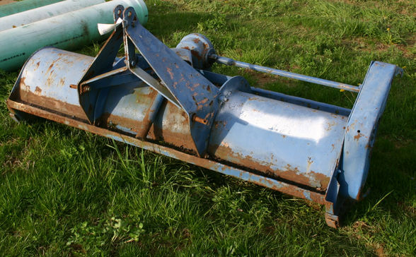

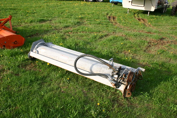

so i ended up buying a ford 3pt hitch fail mower for $160 at the auction i went to. Its in pretty god shape just needs some new flails. I took off the 3pt arms and should be able to bolt them/ weld them on the reverse side to use as a mounting point for the skid steer quick tach plate i ordered. I bought a second flail mower which is a side mount alamo hydraulic mower for $80 which i stole the motor off of wich will power the ford mower. I figured for $80 it was worth a try compared to $300-$400 for something similar at the local hydraulic shop.

/ Skid Steer flail mower
Was the alamo too beat up to use instead of the Ford? Seems like it would be ready to go almost?
I thought about using the alamo mower but i figured that by the time i patched all of the holes in the deck id be better off adapting with the ford and having a nice solid mower. I took the hydraulic motor off of the alamo mower already and if i scrap the rest of it i bet i could get back almost what i paid for it. :thumbsup:
