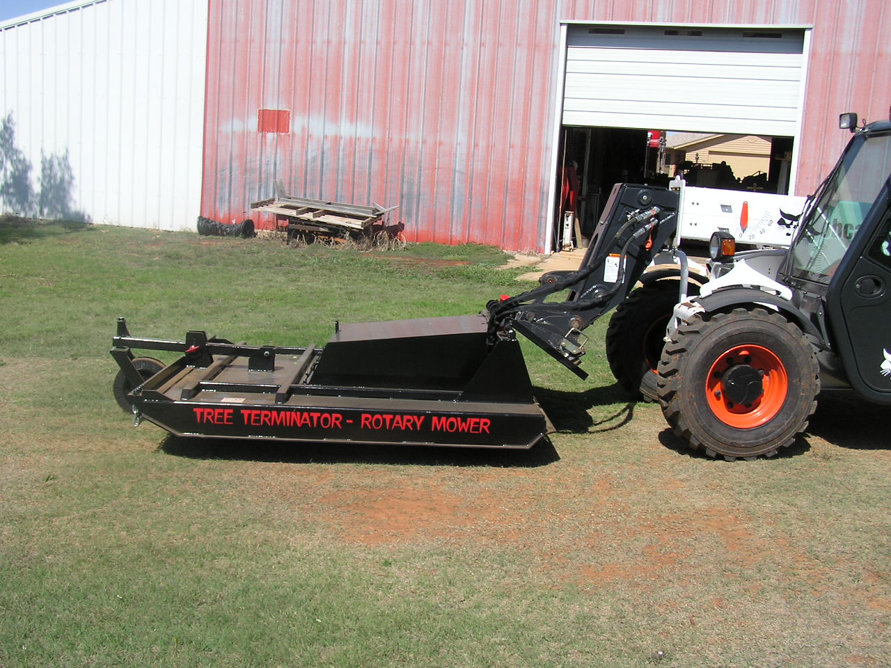

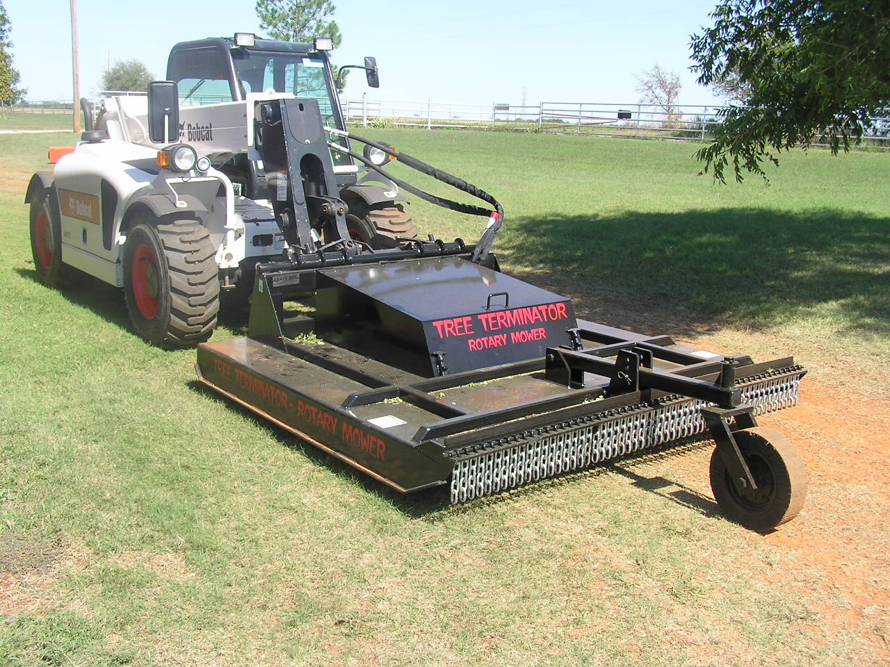

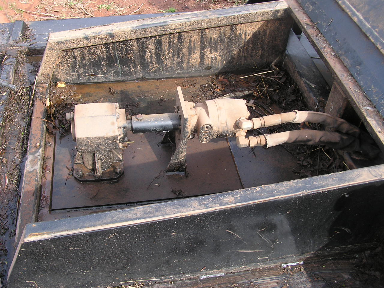

Surplus Center should have the proper motor.

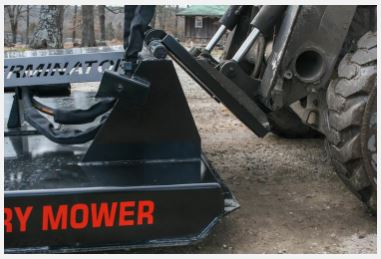

Are you going to copy this design with the hinged SSQA plate?
And the motor driveline?

Wasn’t planning on a hinged plate. But driveline should be the same. Looking at going with a 9-10 displacement motor. They have a char-Lynn that I’ll probably go with. Looks to be the only one with a high enough gpm, pressure and rpm rating. Also the most expensive, my luck as usual lol
   / Skid steer brush cutter #4
The hinged plate works good on the uneven ground.

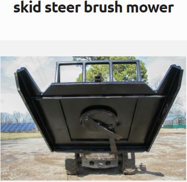

It also has an open front with chains:
I could see where it would be with the front wheel. I’m going to remove my wheel and open up the front to expose the blades. It’s more for reclaiming some land then mowing. I’d rather sit on the tractor and drink a beer while mowing then sit in the skid steer lol.
