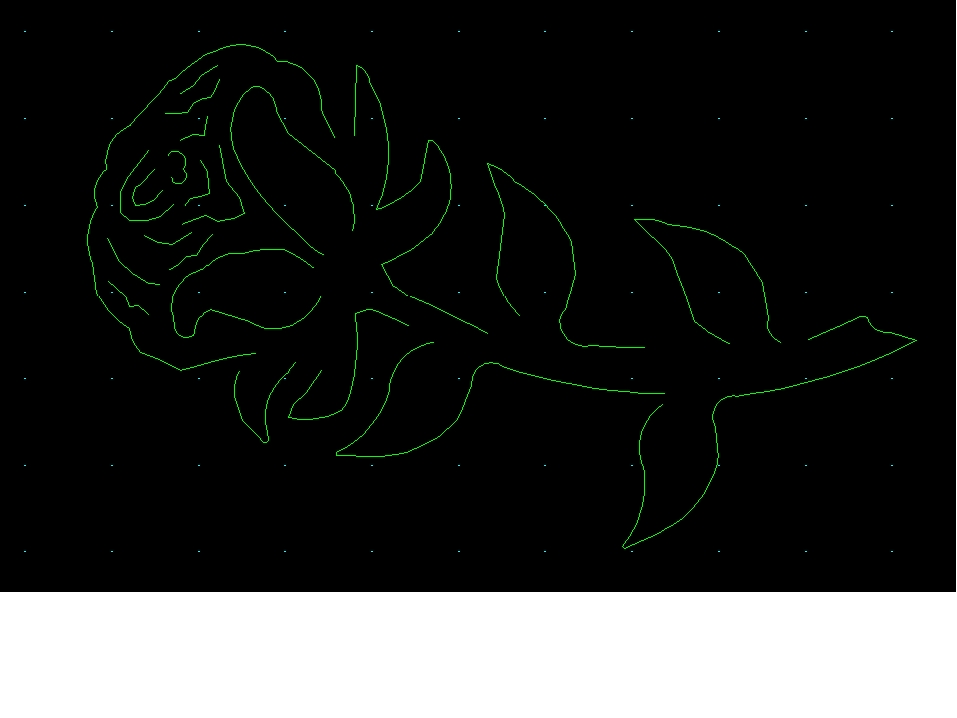

A plasma cut Rose was needed for a sign "Rose Springs Timber" It took me all day to draw a simple rose, I was humiliated :eek: What I wound up doing was downloading a stick outline of a rose flower from the net, converting it to a bitmap, then import into plasma cam then cleaning it up after all that. Can you say "The thrill is gone"?

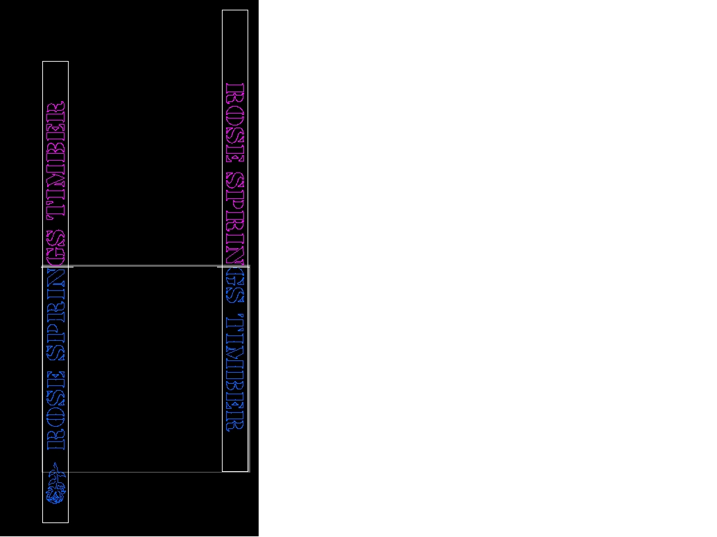

Attached is that sign. It is 9 feet long and 6 inches wide. The plasma cutting table is 4 feet long so there is another challenge of it's own. Only half the sign could be be cut at a time, placement of the letters had to be such that the space between them wound up at the 4 foot mark. Then rotate the part and the drawing to the other side of the table to complete the letters. After all that, move the part and drawing again to cut the rose flower.

One thing i may have forgotten, the grid dots represent the actual "points" on the table. As much as possible, you're supposed to rotate the drawing around these points so you don't burn out the table.
TLB,
Exactly - thanks for the tip.
When drawing I show the grid with 1" spacing, when ready to cut I show the table points and do the best fit for the part while at the same time considering waste of material. Many times the material on the table is worth more than the table slats so we try and make the most out of every sheet. Keeping the edge alignment slots in the table slats from getting burned is the highest priority. Doing that allows repeated alignment of new stock and allows using the factory edge of the material for large square or rectangular parts.
