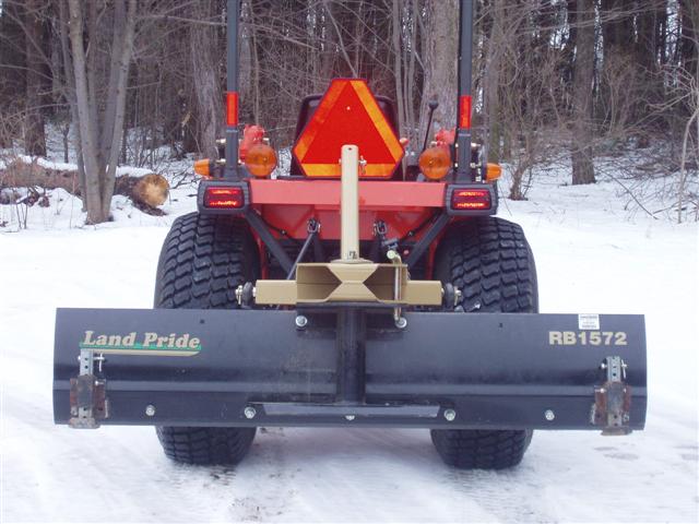

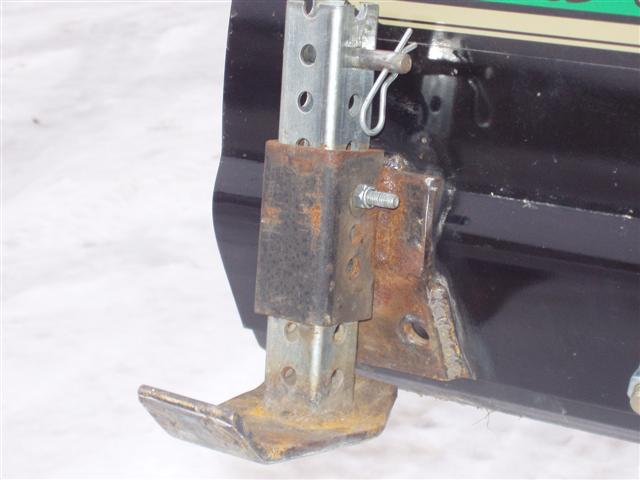

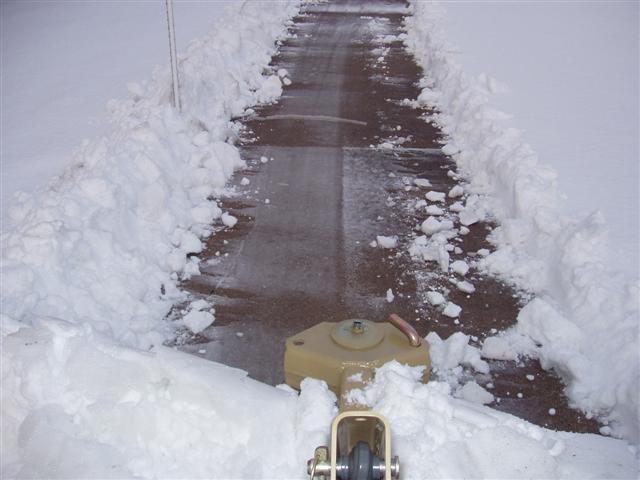

I made skid shoes for my Landpride RB. I used some 2" ID square tube and 2" OD tube with the holes already punched. I used some scrap 1/4" from an old receiver hitch for the skids. I welded everything together and then drilled the holes in the mounting tubes for height adjustment. I can get the height adjustment very precise by using different diameter pins in the adjustment holes. I use it mainly for scraping snow on my cement driveway. To get it just right so that the blade is held just off of the surface, I currently have 5/16" bolts in the holes. As the skid shoes wear I will put the 3/8" pins back in to raise it up 1/32". It doesn't seem like much but it makes the difference between scraping the snow off completly or leaving a thin layer that turns to ice. For scraping gravel the shoes can easily be raised to whatever height I need. The only thing I would do differently is make the skid larger. It would slide over gravel better if it had more surface area.

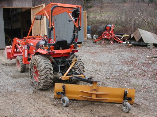

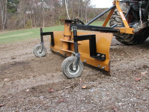

While I don't have any experience with skid shoes, I think gage wheels probably work even better.
Here is what I did:
