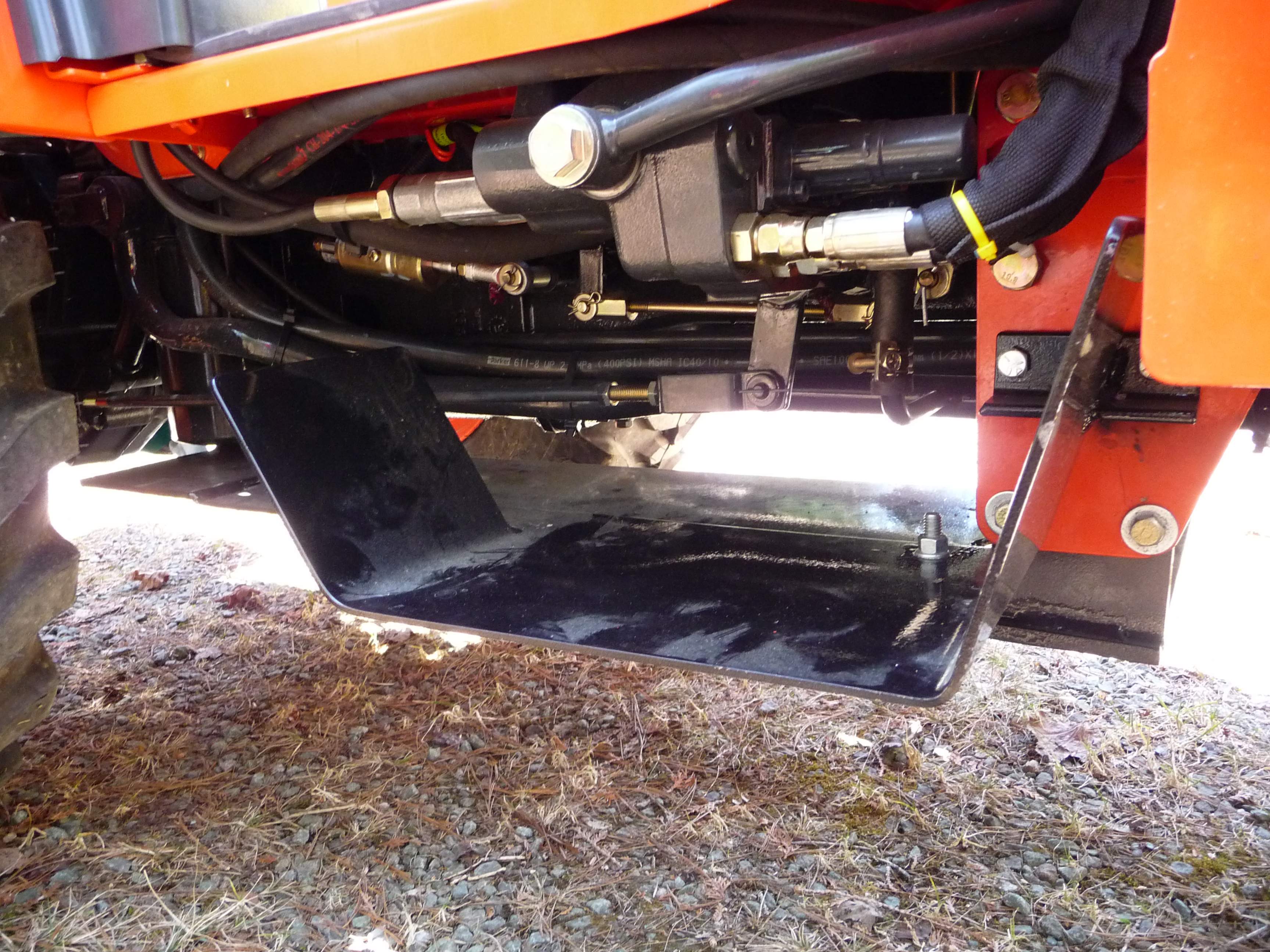

Thanks for the pics Bob42!

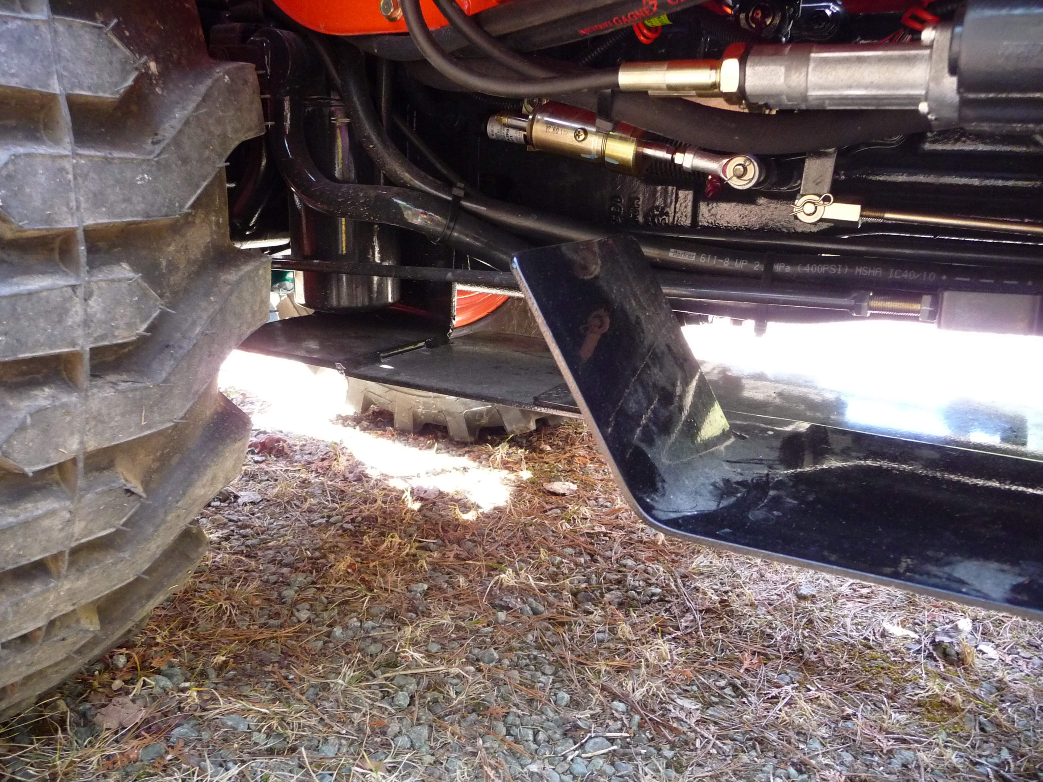

I just received my new tractor CK20 HST, and while I was shopping, I showed them to Payeur's mechanic. They found your ideal quite interesting. The full metal plate they usually installed should have been removed before installing mid PTO for the front snow blower ... With your plate no need to... They normally installed the full plate for forestry application, but for my needs, it was the best solution. Here are some pics of his interpretation.

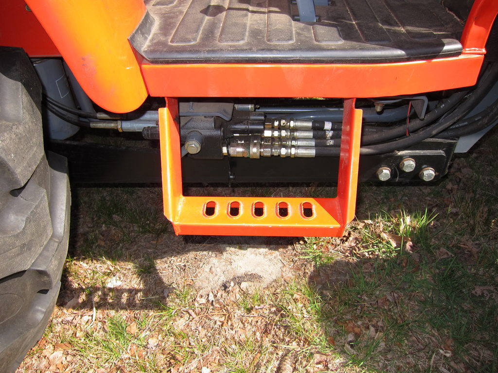

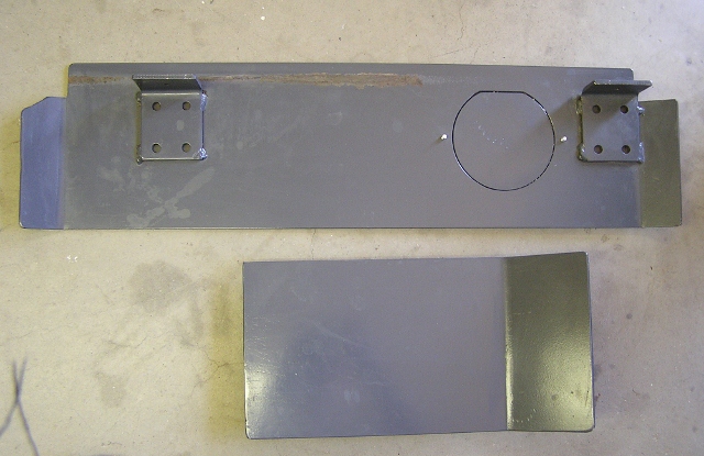

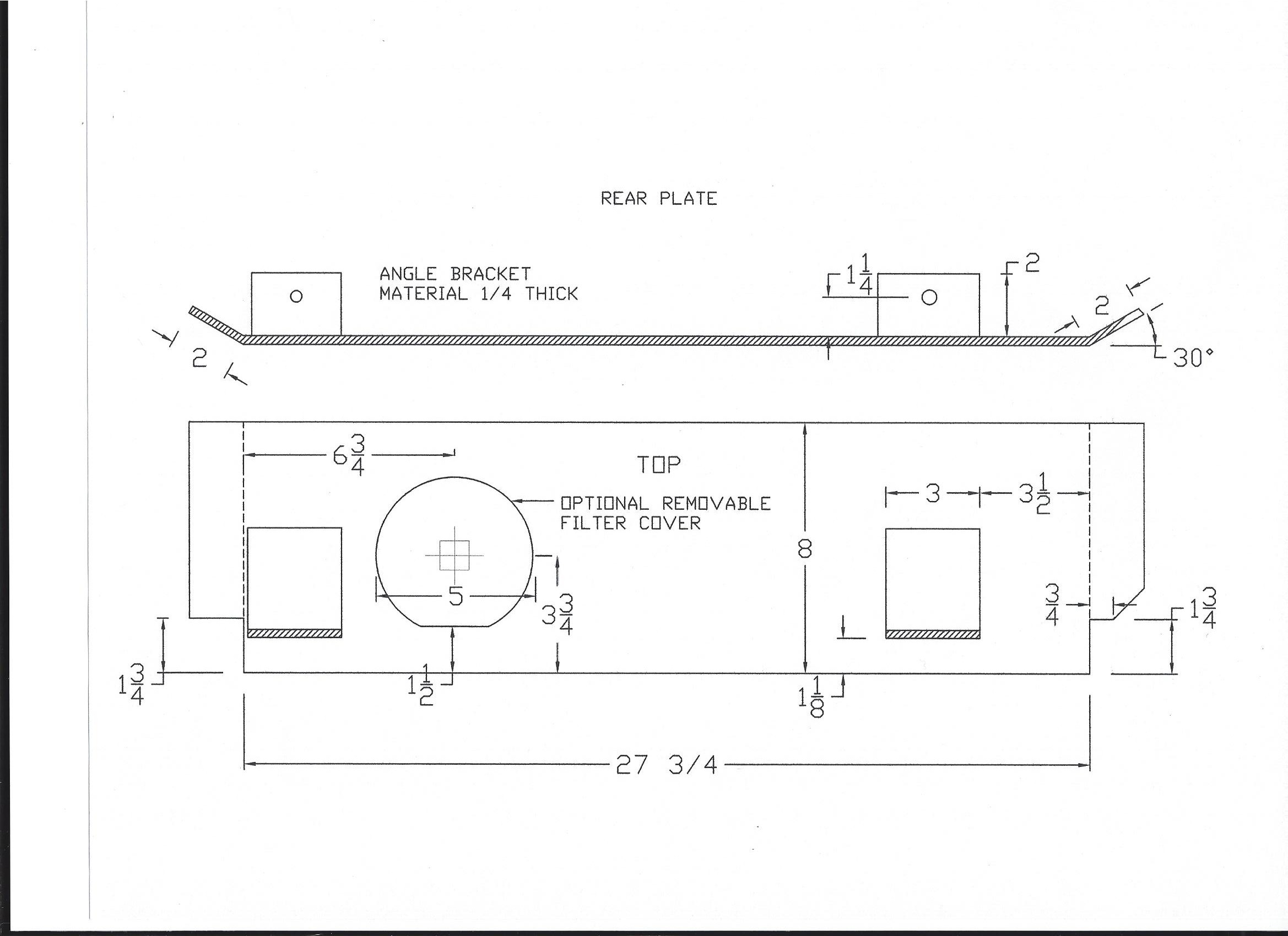

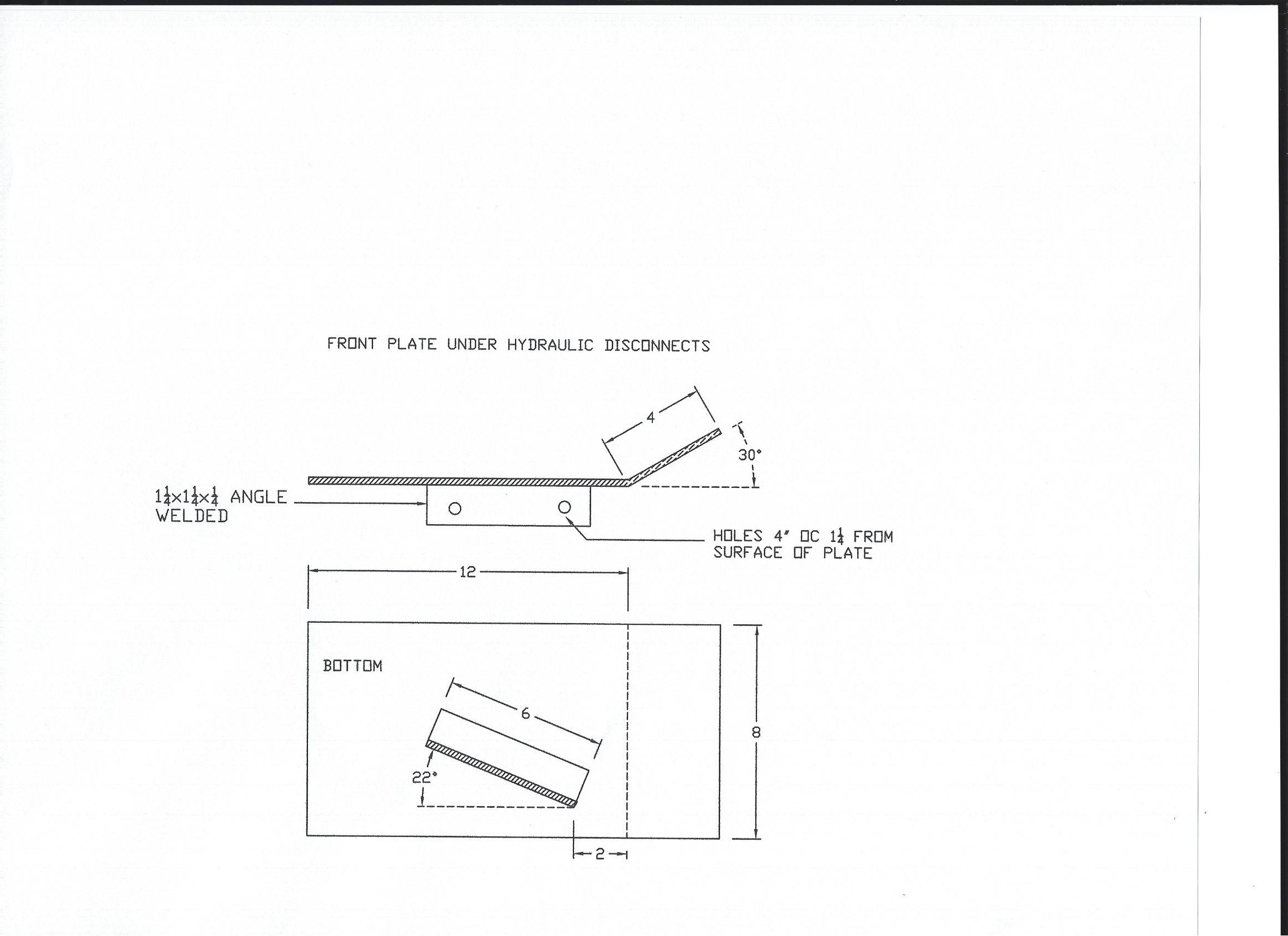

Now home from our trip, I removed the plates for better pictures and easer measuring for the drawings. For the rear plate I used 3/16 material with pre made 1/4" angle brackets . For the front plate bracket I used scrap 1-1/2" angle. With brackets welded on I clamped the plates in place and drilled through the loader 5/8x2-9/16" (16x65mm) solid frame. Drilling through this frame was the most difficult part for me. For those who are working in a lot of brush a similar single, but longer plate on the other side can be made.

Thanks for the drawings and photos. Those look pretty straight forward to make especially if one leaves out the filter hatch.
I have looked at my own DK40se only to realize that the subframe for my Woods BH makes installing skid plates less of a simple bolt on operation. It also shows that the subframe provides a fair amount of protection against large immovable objects so that I may just install some simple 12 or 14 or 16 gauge covers to deflect bending branches that snap back after clearing the subframe. The subframe hangs below all the critical pieces and is either 1/2 or 3/4 inch by about 4 inch solid steel so I don't need to build anything that strong.
I'll have another look this weekend.

Nice work, a skid plate will also give me a good location to mount a selector valve for the grapple. I think I will weld tabs on the loader brackets instead of drilling them. CJ

I'm scouting it out. Bob's version would not be hard to make assuming I delete the filter hatch and just plan to remove the plates for the hydraulic filter changes. Still trying to figure out if there can be one universal design that will work with plain tractor, Kioti BH subframe and Woods BH subframe. Stay tuned, Murphy and I are investigating.

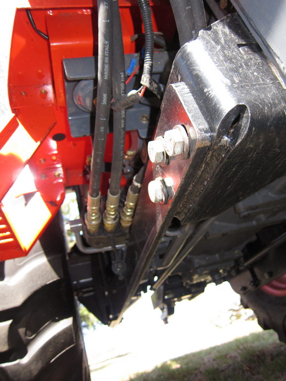

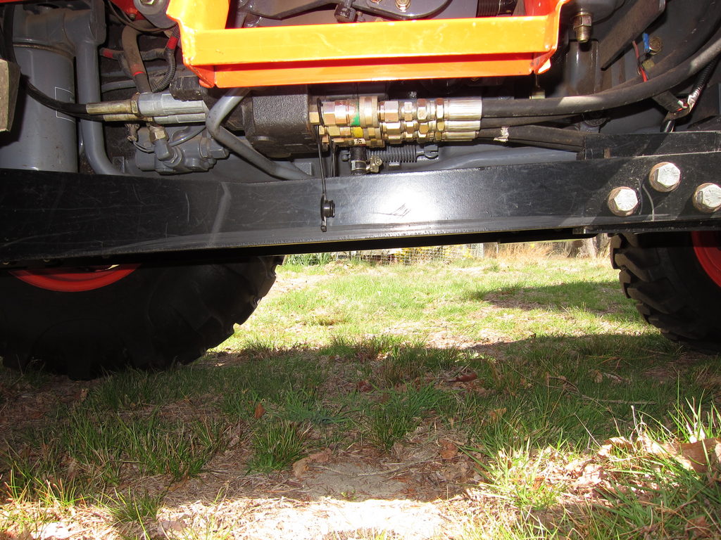

OK folks I need some help figuring out what is standard DK undercarriage and what is specific to my DK with Woods subframe. I am confused mostly by looking at the photos Bob42 posted initially showing the attachment points he used for the loader hose protective plate (the forward plate on the right side). I looked at my tractor and don't find the grey angled piece of ?frame that he bolted the plate to. My photos below show the same area around the spot where the four loader hoses join up with the FEL controller valves. In my photos anything black is Woods subframe and grey is Kioti. I cannot even find the grey piece that Bob bolted his skid plate on. I cannot tell if perhaps it is behind the black subframe in these photos or not.
In any case, it looks like subframes certainly change available mounting points in the area of the FEL control valves.
The main Hydraulic filter area is also different due to the black subframe seen in my photo. (Note the dent in my filter:( which indicates that a skid plate is certainly a good idea!).
Also, note the last photo of the area under the operator station on the left side of the tractor where all the electrical connectors are. That area is quite vulnerable to brush. I have managed to disconnect my 4wd controls twice by having brush pull the connectors apart so I would like to make a simple cover for that area. It is not vulnerable to big stuff as the subframe is much lower than the connectors but brush can snap back and do damage.

I think if I had your set up, I would try to run a sheet of metal from one side to the other and make a "pan" to cover the entire under body. To protect the hoses on the loader valve, I would angle the pan up....see how the ends are angled up for 2 inches Bob42's original shield? Just extend them at that angle far enough to cover the valve.
In other words, take the long plate from Bob42, turn it to run across the width of the tractor vs. the length & make it wider......make sense?

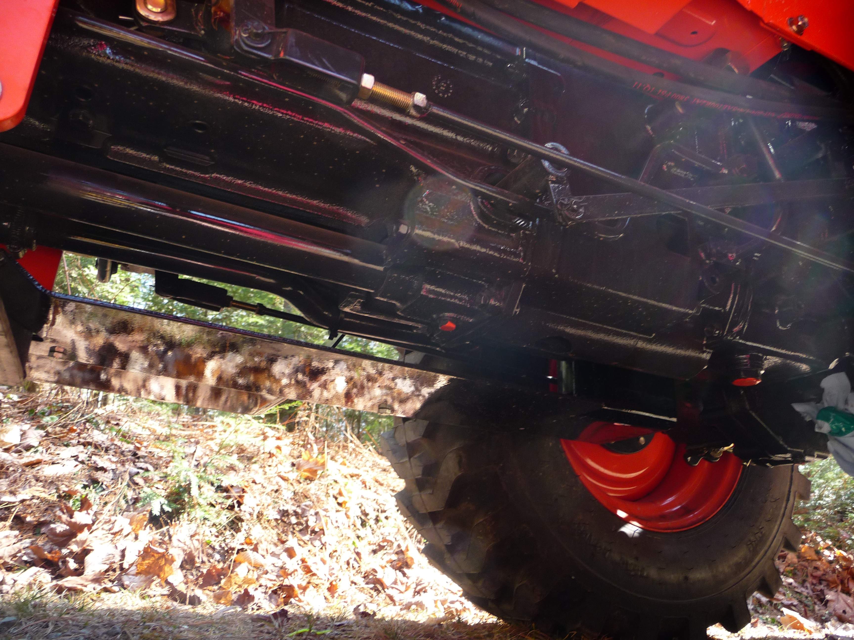

Island Tractor, Took some pkoto's today so tell me if these will do. Notice a big difference in subframes.

Well, I am now thoroughly confused after looking at Bob's, Murphy's and my own photos of the area from under the FEL hydraulic connectors and back to the HST filter.
Bob's and Murphy's tractor have a solid grey painted zigzag metal support frame moving front to back with the zigzag making the piece move outboard over its course by ?4-5 inches between the FEL mount and the HST filter.
My tractor doesn't have a zigzag grey piece at all, instead there is a similarly sized solid black frame that is clearly bolted to a bracket on the FEL support but moves straight back with no zigzag.
I thought at first the grey/black difference was just a change in how the factory painted the earlier vs newer DKse but the zigzag thingy shows something quite different. I don't know if my tractor's zigzag thing was replaced by the Woods BH subframe (hard to imagine) or if Kioti changed the design of the undercarriage that much. ???
Murphy's photos clearly show the typical Kioti subframe which drops well below the zigzag piece and that complicates using Bob's original skid plate design at least for the HST filter area.
My unique black straight frame piece complicates using Bob's original front skid plate piece on my tractor but seems completely compatible with Murphy's as the Kioti subframe doesn't come that far forward.
It does occur to me that Kioti does make unannounced changes in how they manufacture (we learned that when it turned out there were about four variations on the KL130 loader torque tube a few years ago) so perhaps the black piece on my tractor is not really even part of the Woods subframe but just an earlier iteration of the Kioti design (exact same gauge steel and color as the Woods subframe though...black). Confused.:confused2:
I'll take a closer look and some measurements this weekend. It sure would be nice to find a single skid plate design that would accommodate all three possible configurations (and maybe the Rhino version too).

The measurement you wanted from the top of the zig zag frame to the bottom of the sub frame is 7 inches. Bobs plates would work on mine but I would have to remove the plate for the HST when the BH is on. No big deal cause I would drill and tap the frame. What do you think?
/ Skid plate #80
So are you saying that you would use Bob's original design for the HST area plate but would remove it each time you mounted the BH? That would certainly work but has a bit of a PITA factor. I was wondering if there was a slight modification of Bob's plate that might work with the BH subframe. I assume that your grey chassis frame has about the same dimensions and size as mine when looking at the area around the HST filter (I know they are different dimensions forward of that point). As I look at the photo (below) of that area, I cringe at the thought of trying to drill and tap four or more holes while working upside down under the tractor and blocked by the rear wheel. Is that what you are proposing to do? I am still pondering how to weld up a bracket that would go around the chassis frame and just clamp on instead.
