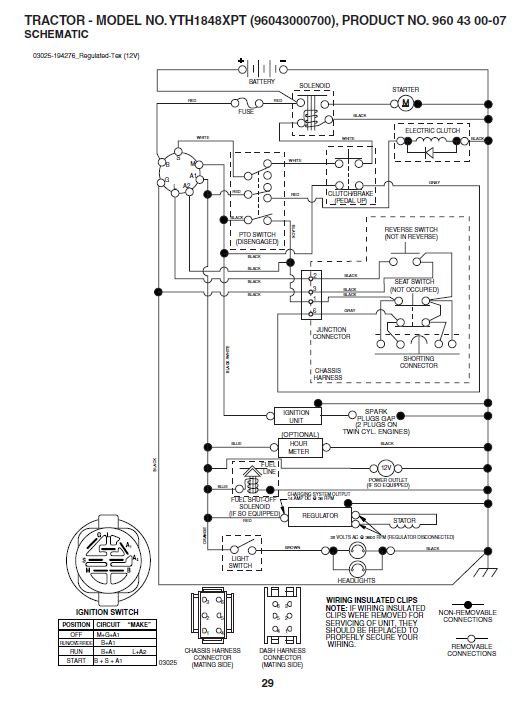

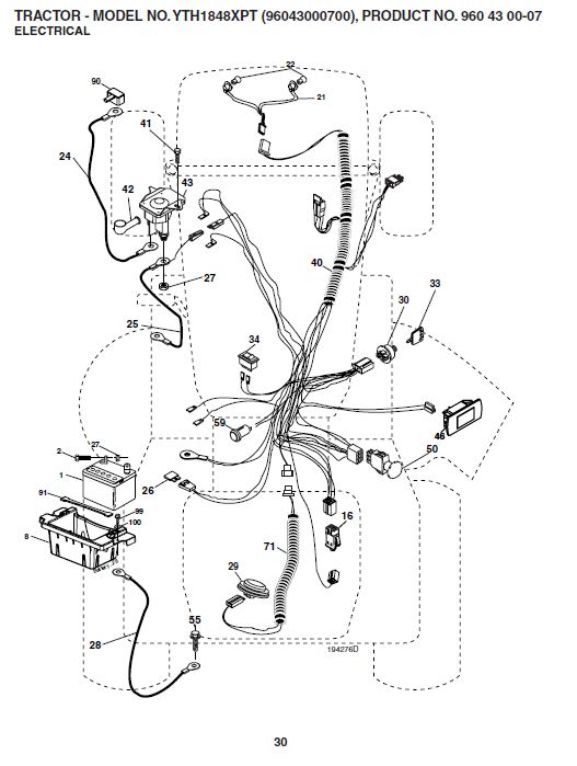

:thumbsup: K7LN.... I like... So I'm thinking that would have the fan turn on when the Key is ON and not interfere when I turn the key to Start...
Not sure how to do it. You lost me with: " The extra load would be the load current of the fan through the ignition switch. So then you use an automotive relay to carry the load current of the fan." If you would suggest a relay type I would be super grateful.
Here are my diagrams....
Many thanks....

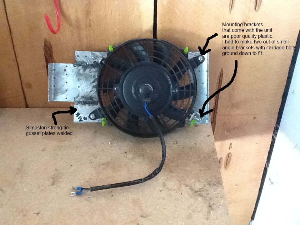

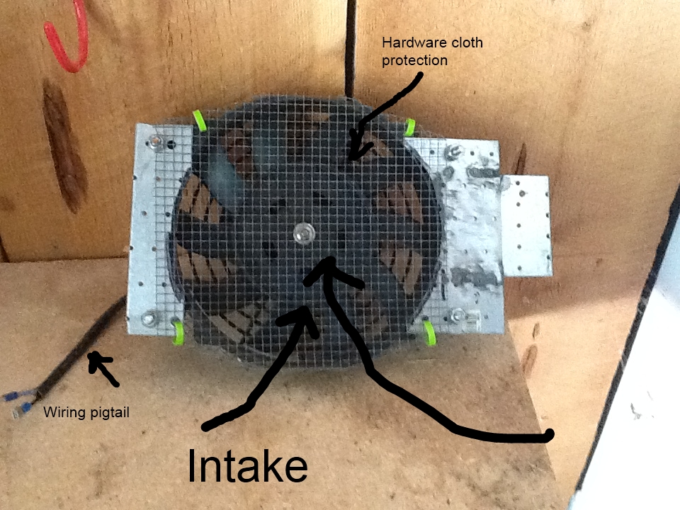

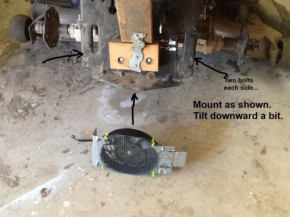

Got her done and it runs fine. One question for K7LN... The fan unit is rated at 3.2 amps. Without the fuse it did draw exactly 3.2 amps.With the fuse it draws 4.2 amps. I had to use a 7.5 amp buss fuse after it burned a 5 amp fuse. Is this a problem?
Thanks again for all of the comments. Now I just hope I get a cooler tranny.
Here are some shots of my handiwork and my dirty mower.

Am using blade type buss fuses. I used 16 gauge wire, but the fuse is 18 gauge. So is the fan. So was thinking the power draw should not be different. Yes, my tests were on the battery with engine off.
Have yet to do the field test.....
All that air blowing under me should at least cool the keester.:laughing:
