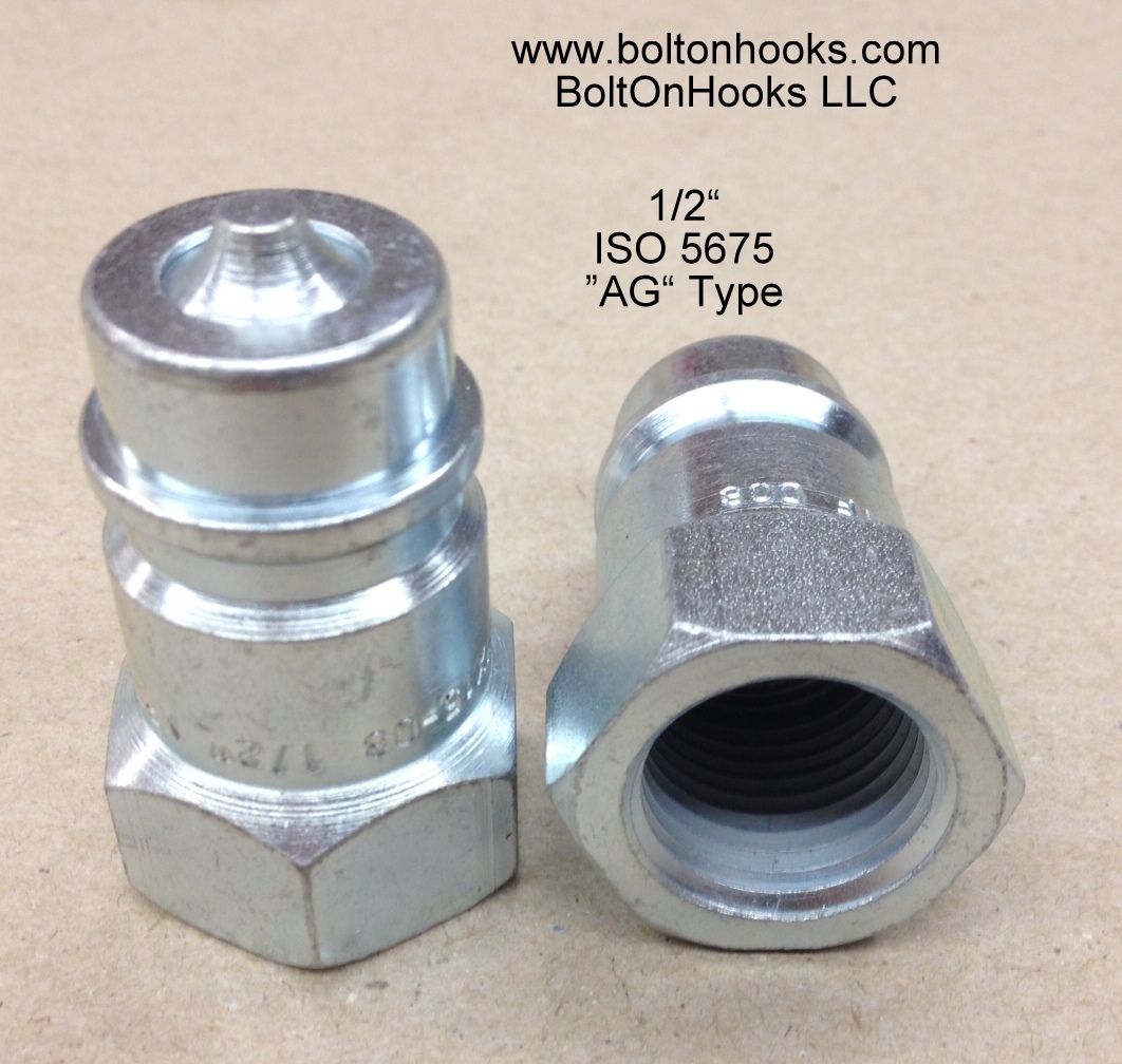

Does anyone know the type of factory quick connects on our LS tractors? Are they the standard AG type connectors or the poppet type? The reason I ask is I am going to fab / piece together a T&T kit. I have the factory remotes already installed, but will need the male ends for the hoses going to the cylinders. Any info would be appreciated. I would call the dealer, but the only guy I really trust is off on vacation. Plus, he would ask why I was not buying the stuff from them.... (because they are almost 4x the cost).

99% sure they are 1/2" ISO 5675 "AG" style w/poppet, thats pretty much the standard these days for rear remotes.

They will look like this:

Your female end should be a poppet but either ball or poppet male tips will work. If you have a farm store that carries Pioneer couplers, look for the Pioneer 8010-4 or 8010-4P. The ISO 5675 is based off the Pioneer.
