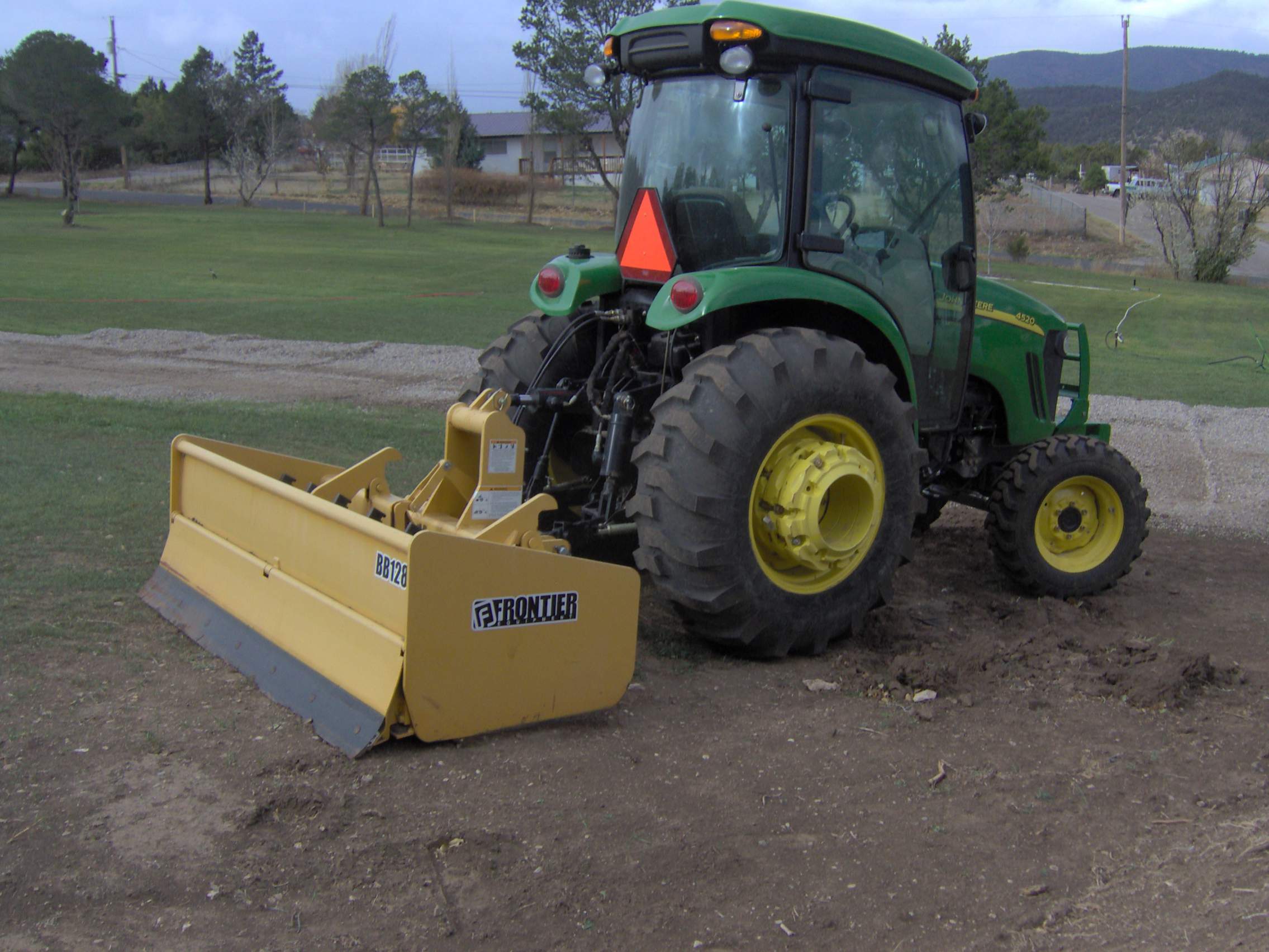

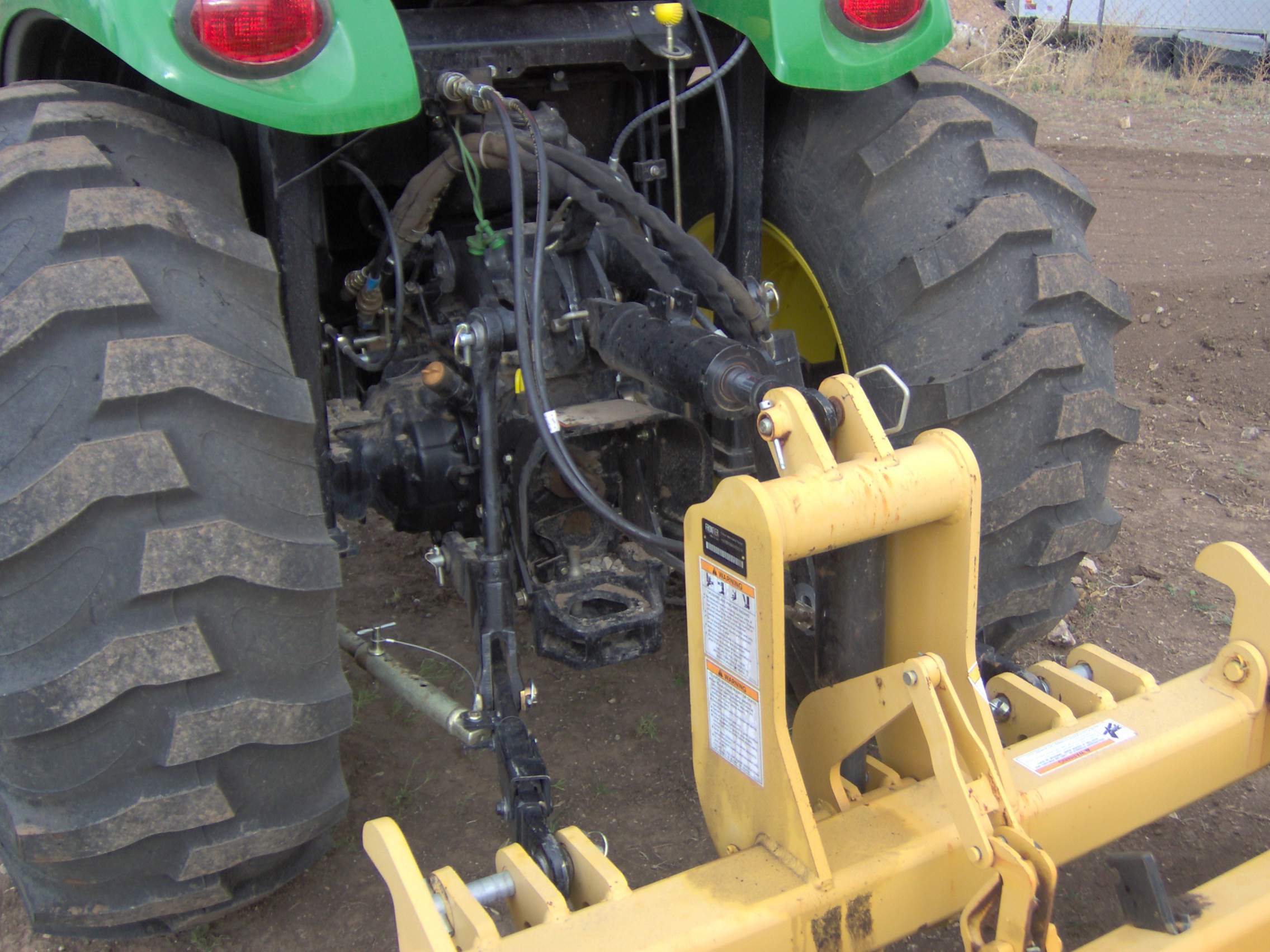

I use a 7' box blade with my 4520 and would suggest Rim Guard or full weights for better traction. My box blade weighs 1260 lbs and seems to be a good match for the tractor. I recommend you have topntilt hitch to get the best results. A good pull type disk about 8' with 22" blades such as the 1508 would be the right size imo.
Here are two pics of my tractor and box blade.
