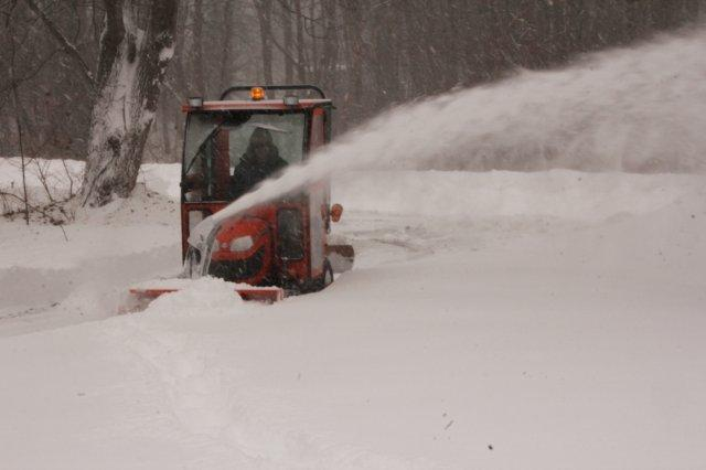

Here's the deal. Ideally we are looking for 1 to 3 acres of oceanfront property in PEI to build on and retire, but up to 10 acres is not out of the question. We will NOT be farming the land but the wife will most likely do some gardening. Most of the properties we've seen is relatively flat or gently sloping, and the annual snowfall averages 133". The primary tractor needs is a front end snow blower and a MMM. I can also see wanting a FEL and a box blade.
Here's the problem. I know VERY little about tractors and do not know which size to buy or how much HP is needed. I realize that the actual land will determine my needs, but working with the above information, what do you suggest. I do not want to over or under work the tractor. I'm looking for some guidance here because I'm just too new to tractors.

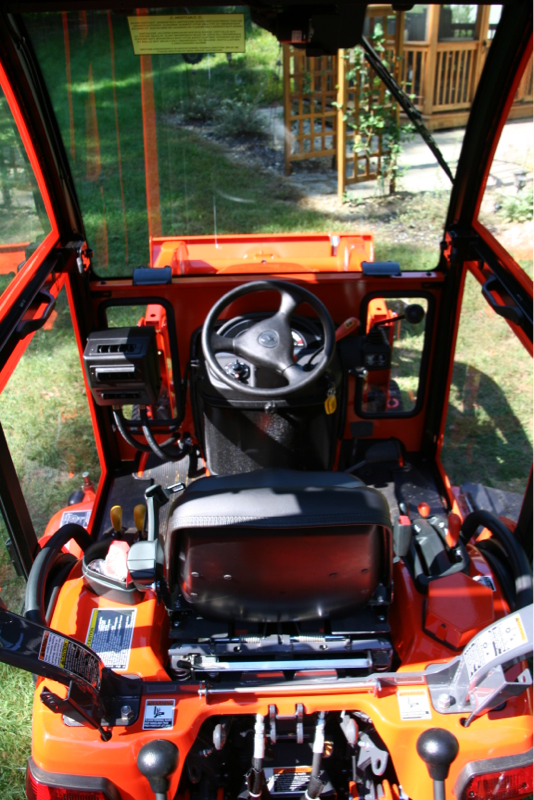

First of all thanks for the quick reply. Considering the winter requirements a cab would be very useful. Can a heater also be installed? I suspect that I'll have a long gravel driveway, most likely around 500 to 600 feet because typically the lots are long and narrow (150' x 675'). As for the land plane, could a box plane be used instead, or would I be better off with a land plane? Please bear with me because I'm new to all of this.
I was looking at the B2920 and thought that it would be a good choice. However, not having any experience I had no idea if it was over powered/built for my needs. That's why I thought that the BX series may be a better and less expensive solution. Getting the right tractor is more important to me that saving a few dollars.

With ten feet of snow to blow you will want at least a soft cab for sure. You can add a heater to a cab and most hard cabs come with them as well as AC. I have more land then you are looking at so have a bigger tractor with a soft cab. It works well and I have not needed a heater as the heat from the transmission is right under your seat. More then enough when you are dressed for the outside.

I don't see anything in your description that you couldn't handle with a BX series tractor. The front blower works well even in 20" snow storms and it will pull a box blade just fine. You would most likely want a cab which is after market but certainly available, including heat.

What ever brand you chose,with that much snow(I live in the north) you want a Factory cab for sure.The add on cabs don't seal well,are noisey and lack AC.Crazy to run a front snow-blower with-out a cab.Look at the "B" series Kubota for sure.

With respect to the "Chute Rotator Kit" for the snow blower. Is the hydraulic kit worth the additional expense over the electric kit?
Also, does Kubota offer a hard cab for the BX series (I couldn't find any), or do I have to go 3rd party?

I have the electric chute rotator and it seems pretty slow. The videos of the hydro ones seemed to work a lot faster but I don't have any personal experience with it. Kubota doesn't make a factory cab for the BX series. The first kubota offering with a factory cab is the B3000. Great tractor but you are talking $37k in US for the tractor with loader, mower, and blower. The BX series runs quite a bit cheaper.
