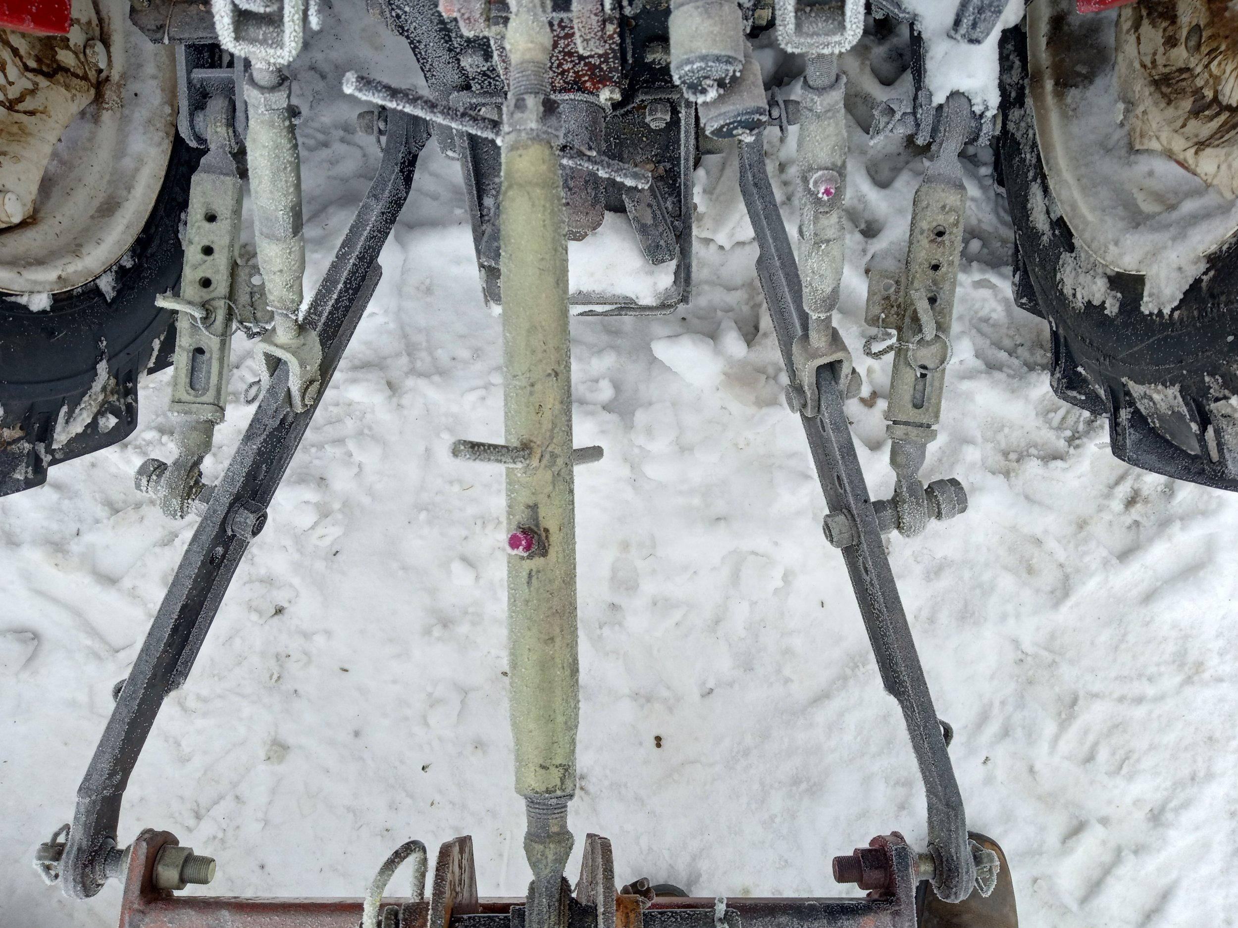

Yes, backing a trailer is where the loose 3pt is the most annoying. Yesterday I needed the tractor for another chore so while it was running I looked the links over more closely. With the back blade on the hitch and both links pinned in the first hole. When the blade was on the ground there was about 3/16" gap between the inner and outer sleeves of the link. Sam on both sides. As the arms are raised this gap disappeared and the slop was nearly all taken up and the hitch was fairly stable.
Here is a picture of my 3pt setup.
Looking at this and remembering how it got this way has made the little light go on. Originally the links were connected to the arms with pins. The pins were threaded held on with a nut just like the pins on the blade. However I could not keep the nuts tight and they kept working loose, making things worse. Eventually the threads got ruined and I had to come up with another solution. The original pins had a smaller diameter at the threads than on the pin. I found these bolts that fit the link but had to drill out the arm to get it assembled. These bolts have never come loose.
I have always had problems with the links not letting the arms open far enough for some of my implements and I was contemplating cutting the outer sleeve down to address this but didn't want to weaken the sleeve near the slot. Looking at it now, it is obvious all I have to do is move the bolts out to the next hole. This will give me more range of motion in the link.
Which hole are you using for the link to arm connection?
I think the idea of the links is to have the holes on the inner and outer parts at different spacing so that there is always a hole that will be lined up. I need to take mine apart and check but I think they are probably not done that way. Also 15 years of use has probably taken it's toll on the fit of the holes and pins.
In any case, the pins for the arms and links must be in the same plane at the tractor end in order for them to have concentric travel where ever the arms and links are connected. Our tractors have the pins close enough that all the cumulative slop in the system allows for it to work, just not as well as it could. Probably re-making the link mounting brackets is the best solution. Something else to do the two weeks of the year when ice skating isn't very good.

Thanks again. Interesting about your bolts. The pins on ours are 19mm diameter, narrowing to 16mm for the threaded part, and with a collar on the 19mm side. One of ours broke, as a first fix I have welded it but was thinking of replacing with bolts as you have done. Or maybe with 16mm bolts and a sleeve rather than drilling the arm. I have mine in the same hole as yours, second to furthest out.
Like yours my stabilisers are worn, I can almost convince myself the holes are differently spaced on inner and outer parts, but not enough to give full adjustment.
