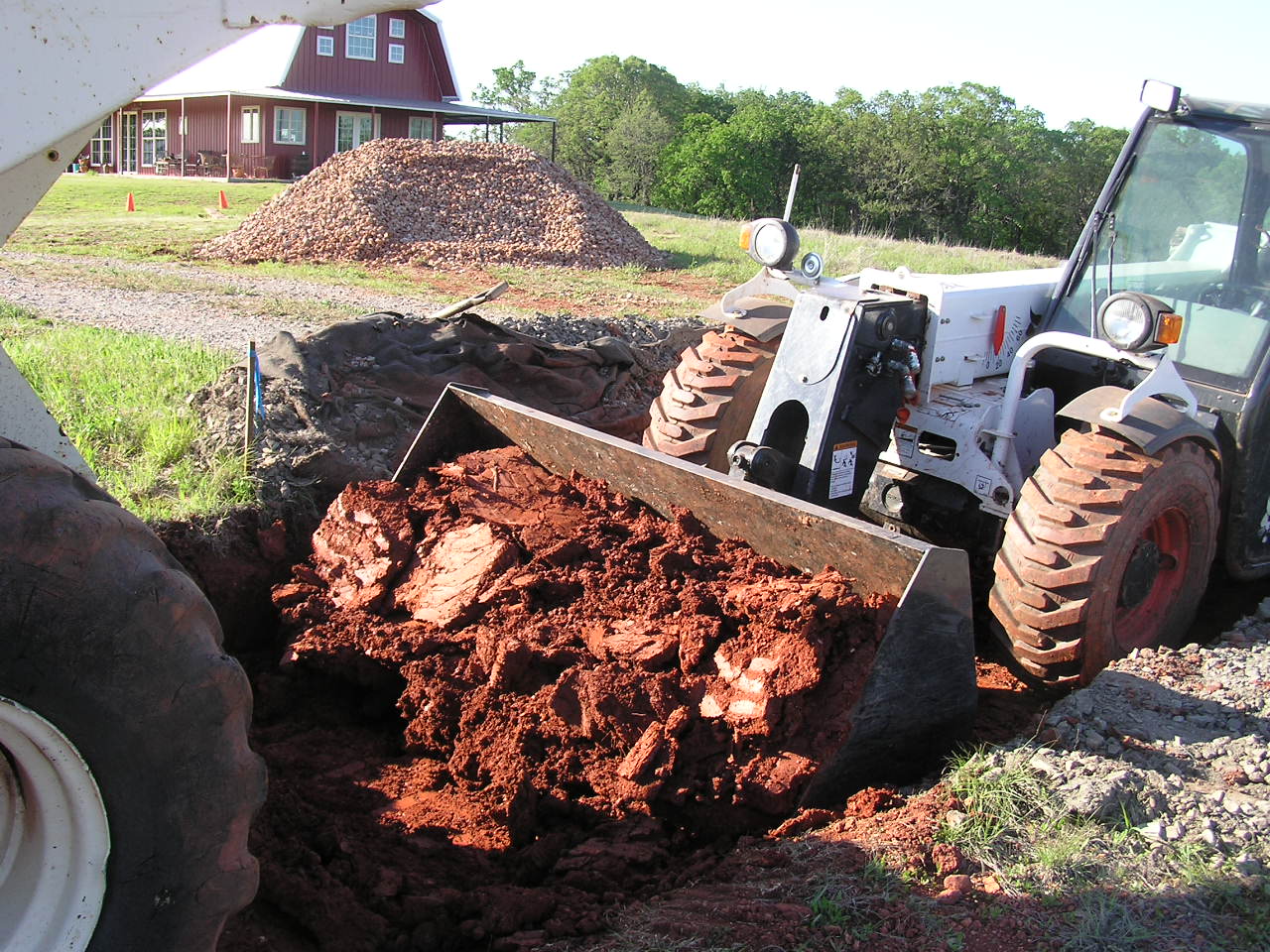

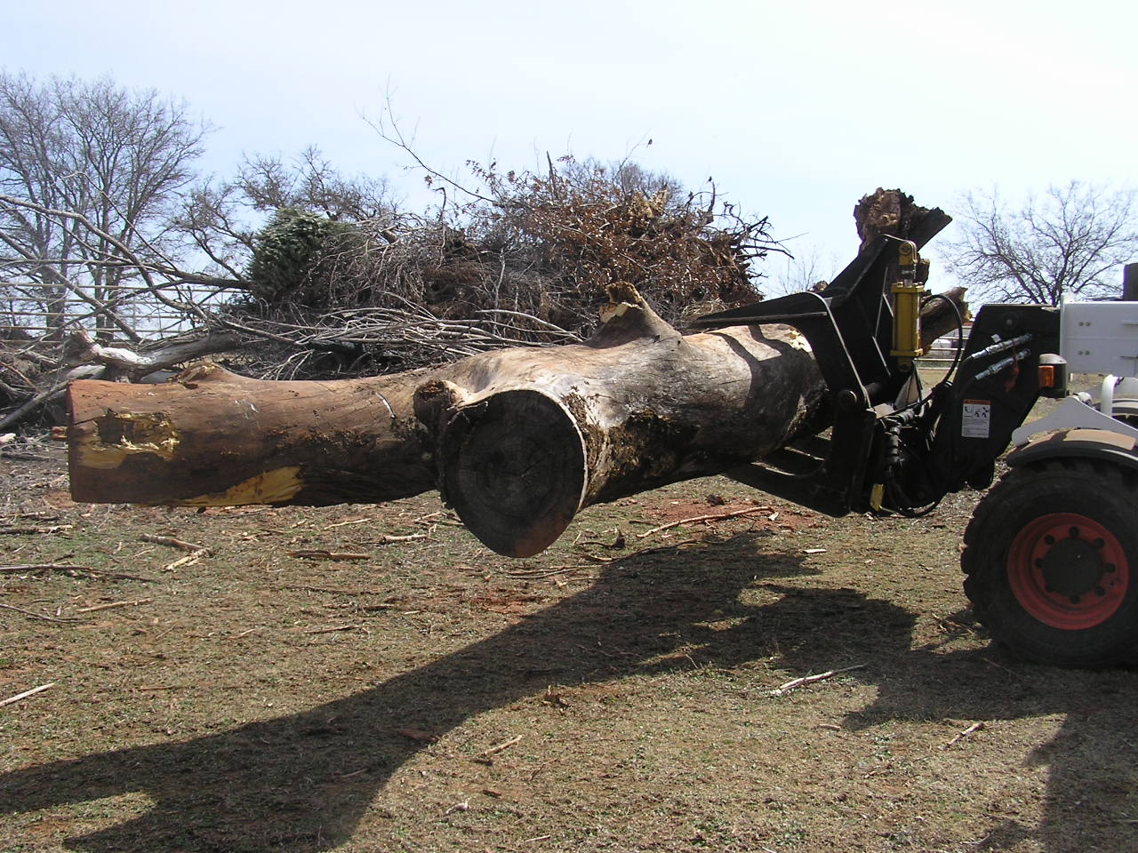

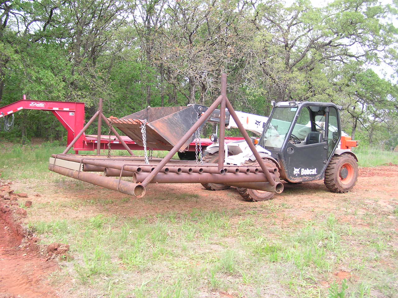

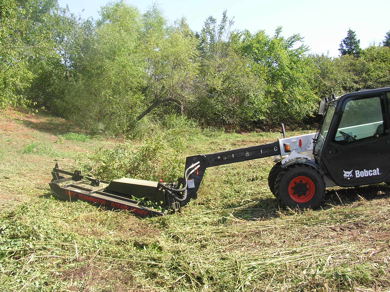

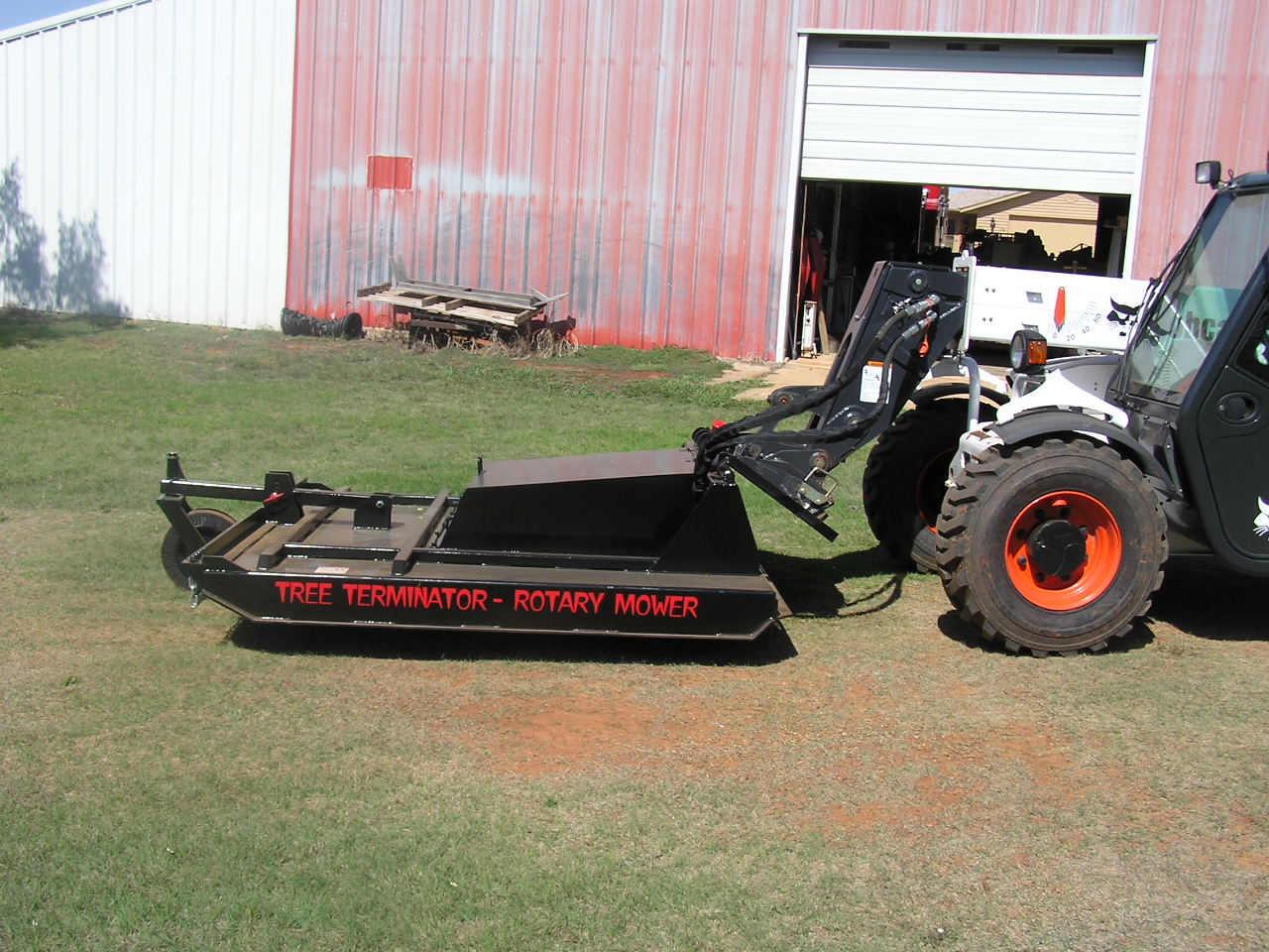

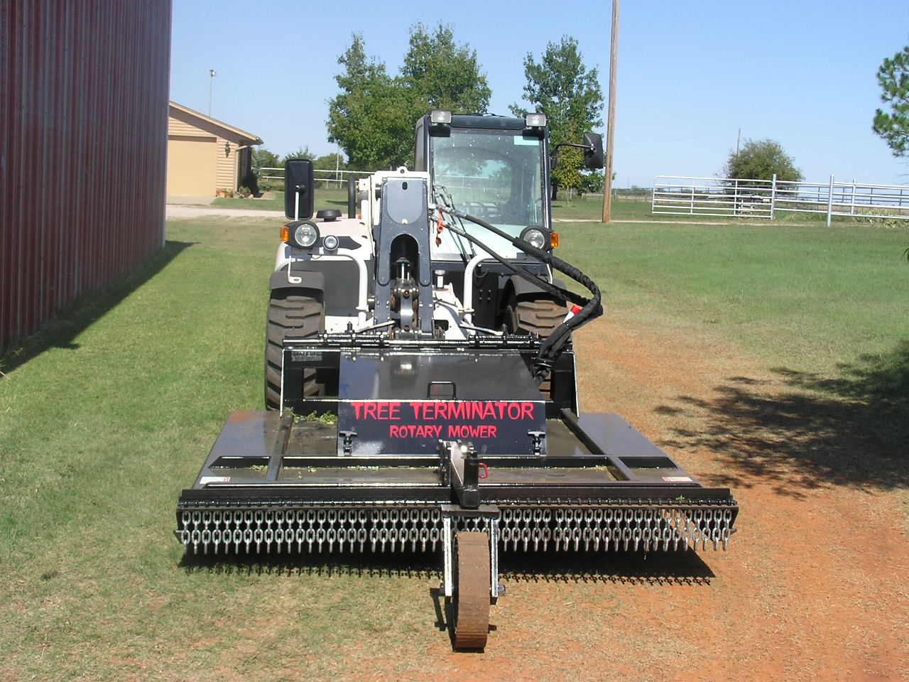

I would recommend a compact telehandler, there are several companys that make them. Most have a SSQA plate that will take all skidsteer attachments. I sold my tractor, a MF240D after I bought my first Versahandler.
Mine is 6' wide, 7,000 pound drawbar pull, will lift 4500 pounds 17' high. It will push or pull itself out of any stuck situation. I have pictures to prove that!
I use a 7' brush hog on the front.

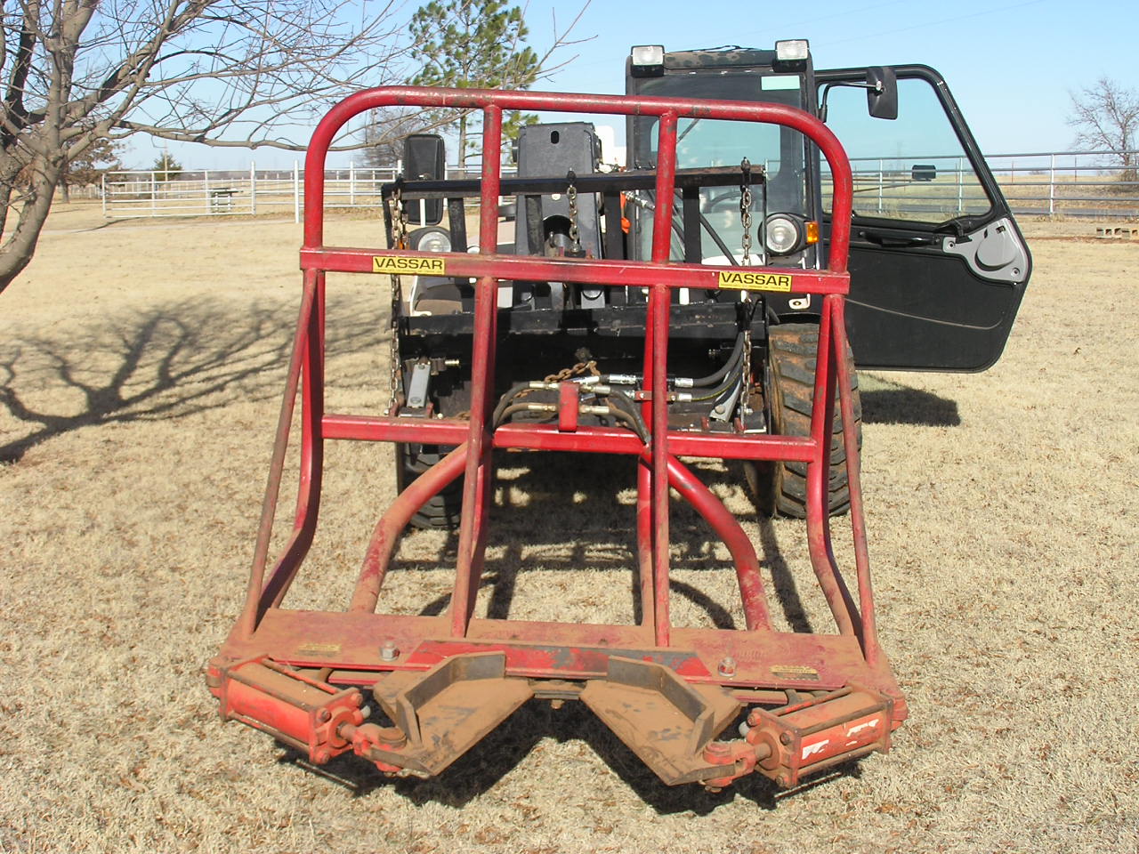

Converted three point tree cutter.
44" Gorilla Grapple, log.
