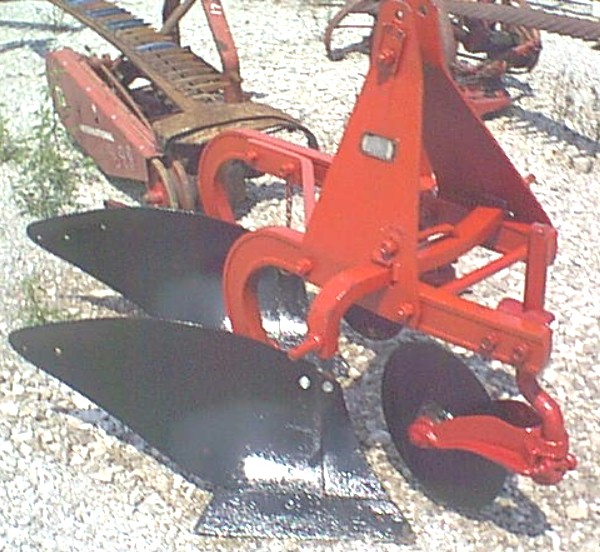

Here is a picture of a used 1-16 Pittsburg plow with all the bells and whistles for $450 + shipping. Ken Sweet

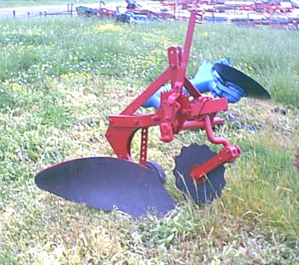

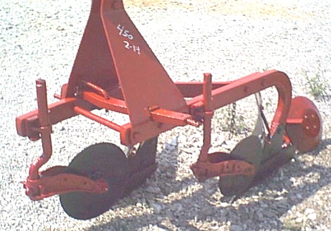

Here is a Ford 2-14 with the modern 3 piece setup that is easy to find parts for. It has good points and 2 new shins. Price is $450 + shipping. Ken Sweet
