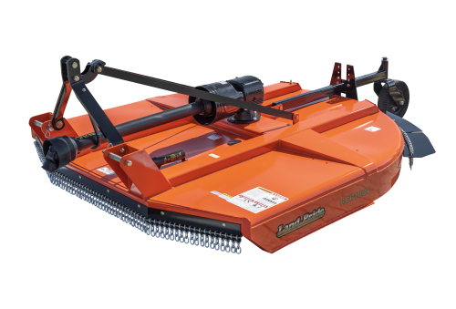

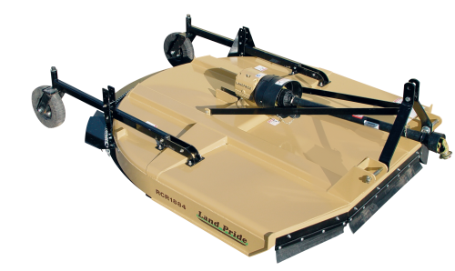

I’m going to buy a 7’ Land Pride and they come with either a single or double tail wheel. What do I want? I’ve only ever had a single.

What's the terrain you are mowing like? My place has a "plethora" of ground squirrel holes and badger holes; my mower has only the one rear wheel. When that wheel drops into a hole it slams the mower against the ground and depending on the terrain around the hole a lot of times the mower blades hit dirt. Having two tail wheels should prevent that from happening.
   / Single or double tail wheel on brush chopper? #4
I have one of each and it doesn't seem to make any difference.

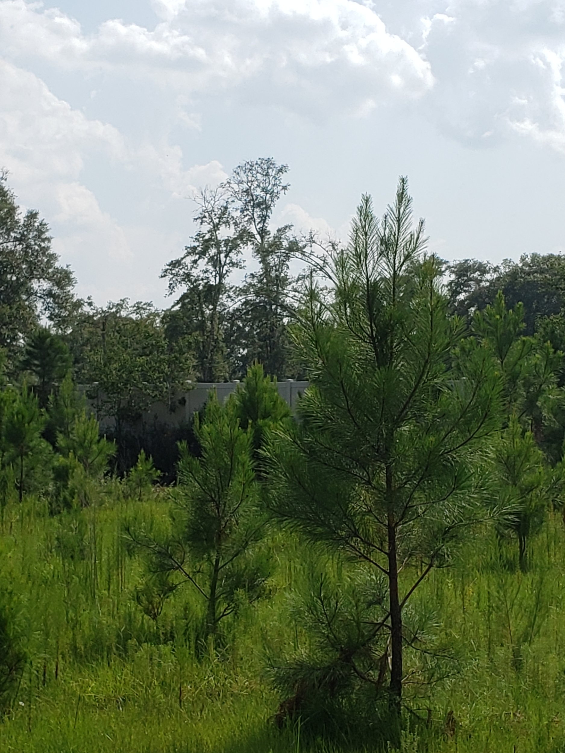

A twin spindle Bush Hog 3008 makes a lot better cut than a single spindle hog...is something I learned!
A customer I just mowed a field for, that hadn't been mowed in 5 or more years had his niece watching out for me, told me that he wanted to see me. He came out and corrected her, saying he didn't want to see me, he wanted to see the mower, because it mowed like a finish mower but he knew a finish mower would never have stood up to what I was cutting the day before. I told him it was definitely a Bush Hog, and that it was in need of new blades, but I hadn't put them on yet, after see what the field looked like on our drive thru.

That’s a nice cut! Don’t have that much flat land on 140 acres.
