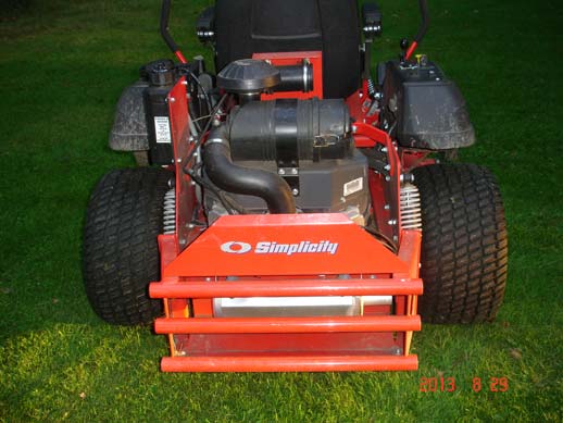

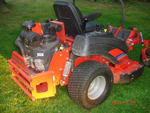

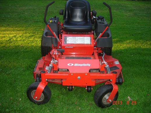

The Simplicity Champion 20" rear tires, Simplicity Champion XT 22" rear tires. Simplicity Champion stamped deck, Simplicity Champion XT fabricated deck, etc. There are some distinctions between these two models. I believe the older Citations were like the Ferris IS600, but now the Champion XT is more the equivalent for their respective line up and a lower price point for Ferris, while the current Citations are the same as the Ferris IS700, but with headlights as standard. I paid $6870. otd for mine in 2013.
But over the past few years there have been changes to both brands and my take on the current equivalent between the two:
The Champion XT is the equivalent of a Ferris IS600.
The current Citation is the equivalent of a Ferris IS700 with orange paint and headlights.
The top of the Simplicity line is the Cobalt is the equivalent Ferris 2100.
Ferris then has models which escalate in price up and beyond the Cobalt in price points and features, but now you are talking 12k to 15k and beyond zero turns.
btw, I did remove the folding ROPS on the Citation pictured and an older Citation I use.
