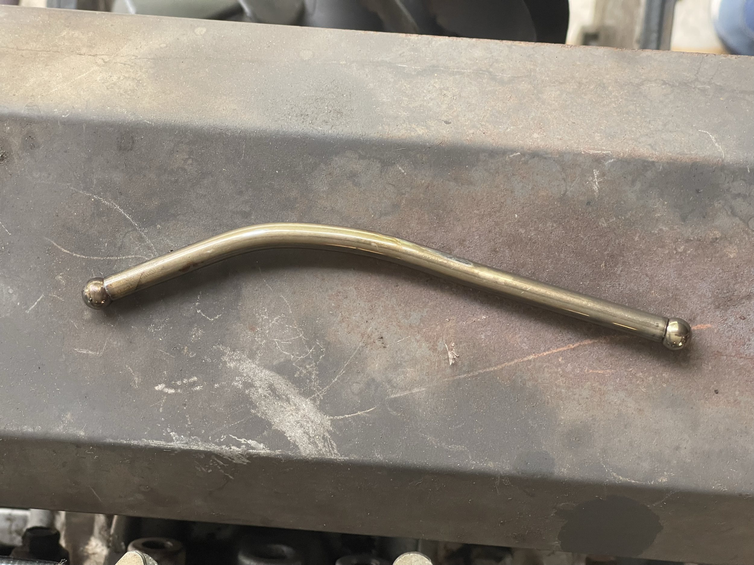

Welp... This is the intake pushrod from the #1 cylinder:
Now, to figure out what caused that!
As I mentioned before, is the nut loose on the rocker arm for that?
Mine actually pushed a hole through the composite valve cover.
They may have both been loose - As soon as I got the valve cover off, both pushrods and rocker arms were loose (rods fell right out of their spots in the arms).
Got a suggestion on Facebook that maybe a guide moved due to heat. I'm not sure how I'd be able to tell. I'm going to get the whole cylinder head kit for #1, and probably at least do a new head gasket on #2 and torque everything properly while I've got it apart.
