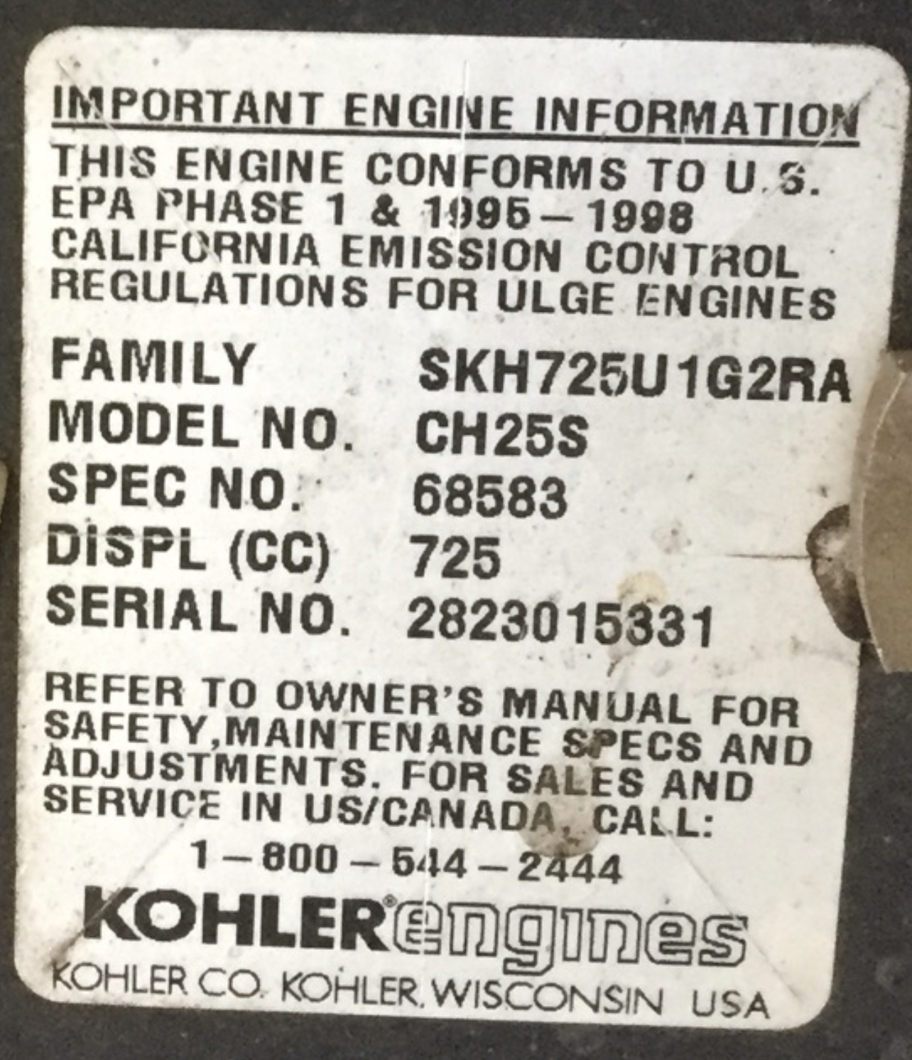

What model of Kohler engine is this. Different issues can arise depending on model.
CH25S - 68583.

Here's the data plate:
