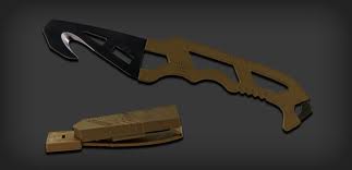

Okay, give it a shot, but rather than a front-facing edge, go with a pull type cutter design, so you can use the downward hydraulic pressure, weight and gravity to cut through... fashioned out of your stock, of course:

Great idea! I plan on trying to get it going in the morning before I go to the deer lease. Thanks!

Unless you don't care at all about the pruned tree, I think a push cut from the bottom would be better. A pull cut from the top will tear the bark down the tree and leave a big wound that will be much more damaging and difficult for the tree to seal off. Maybe a push cut to start and a pull cut to finish if you care about the future tree and it's possible value.
